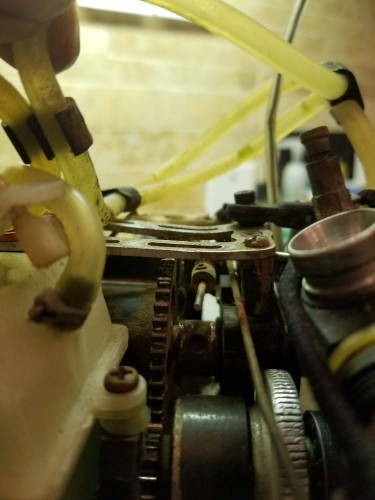

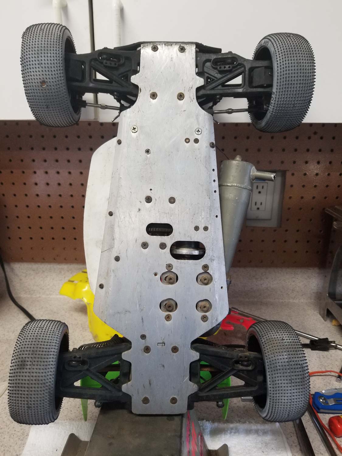

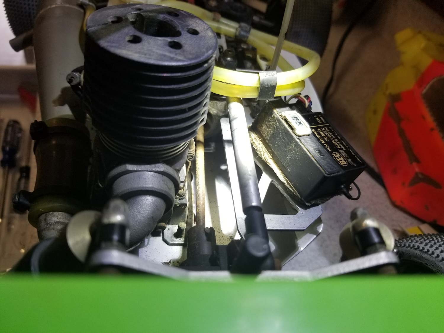

First pic shows the chassis, the second one shows the Ron Paris engraving on the engine, the third and fourth show the axle and drive shaft I'm curious to know about...

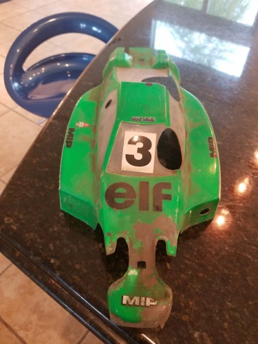

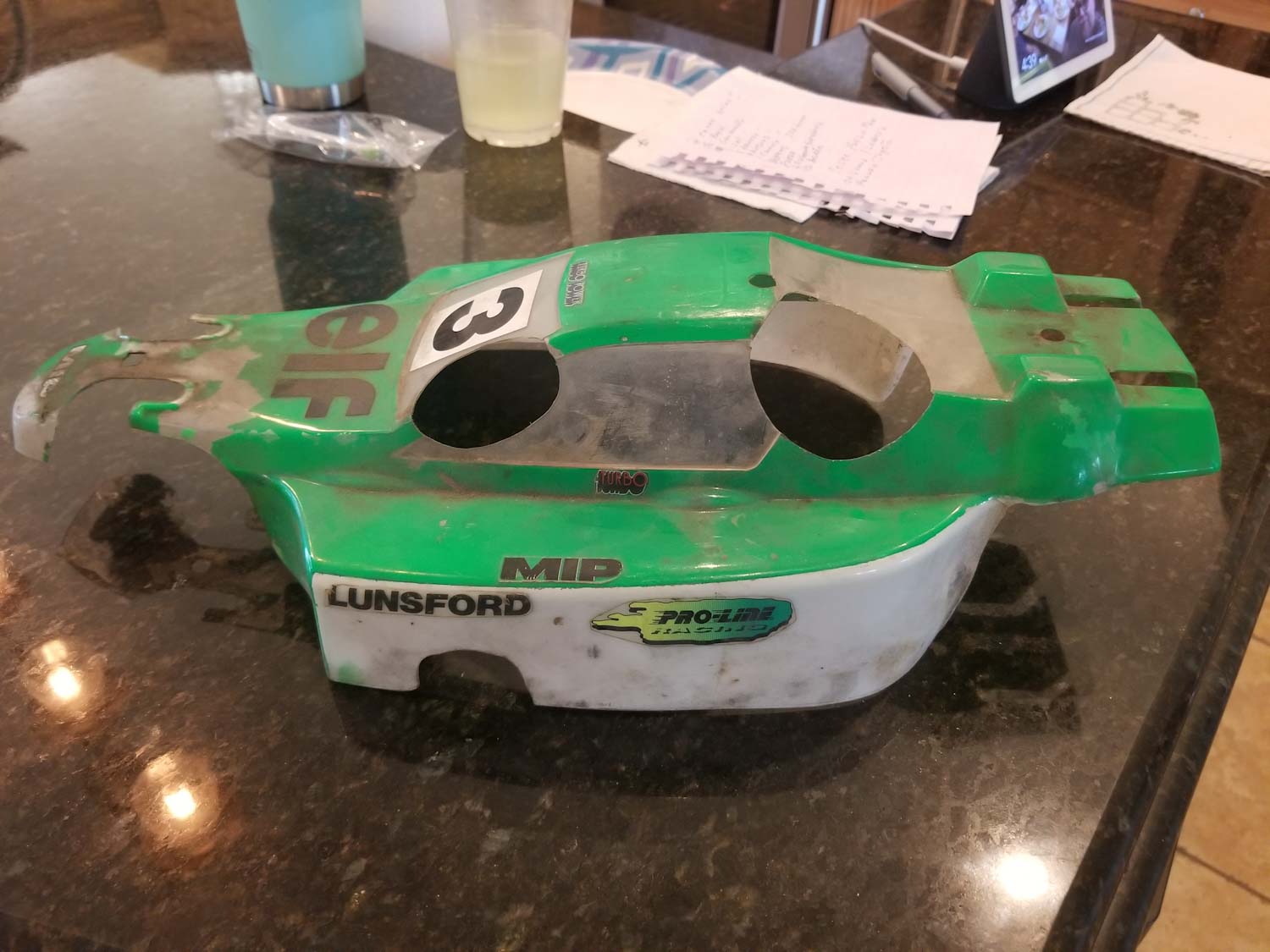

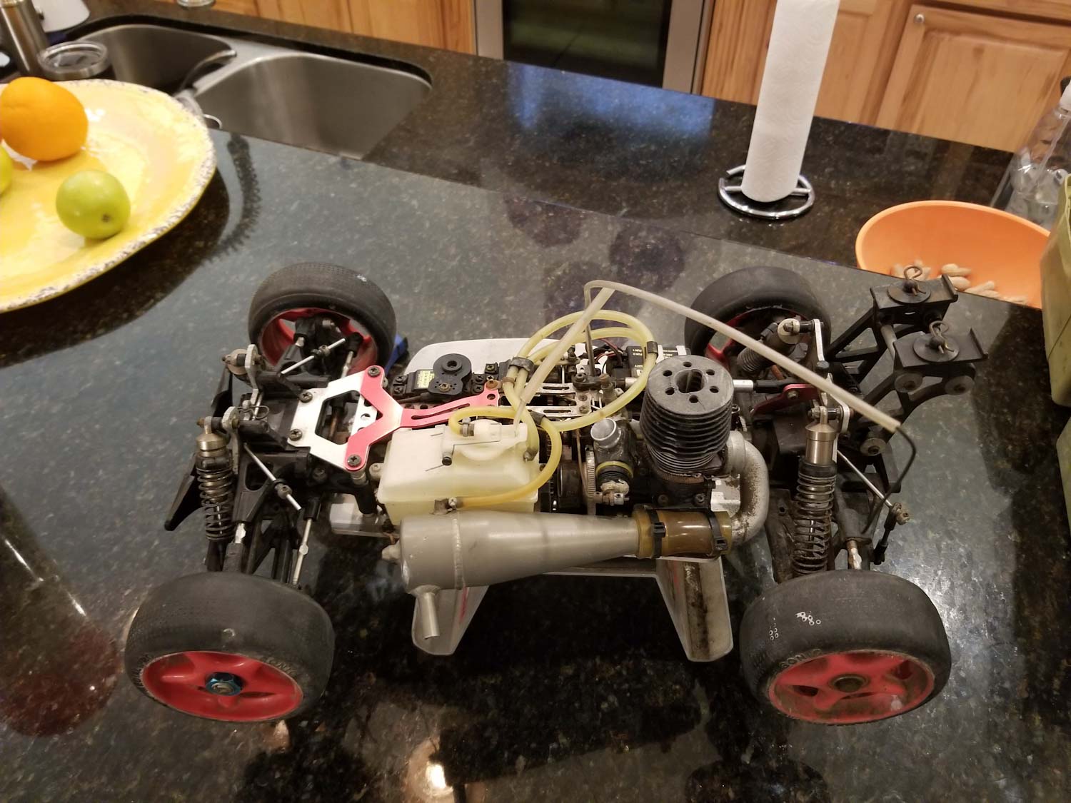

Do these pics of the body and wing provide any additional insight?

Cool to hear you raced Superbike. I used to race the local series AFM, and motocross before that.
I can only see your rear drive shaft in the pictures. They appear to be the standard dog bone drives, not the upgraded universals. I certainly don't think they are titanium as they look rusted. The tie rods appear to aftermarket Lunsford units and are likely titanium. Maybe that is what you are remembering.
I can't see the brakes.
Based off one picture, the chassis sure looks like a standard Inferno DX/4WD chassis to me. However it's hard to tell the material type from pictures.
The body is the stock Inferno body.

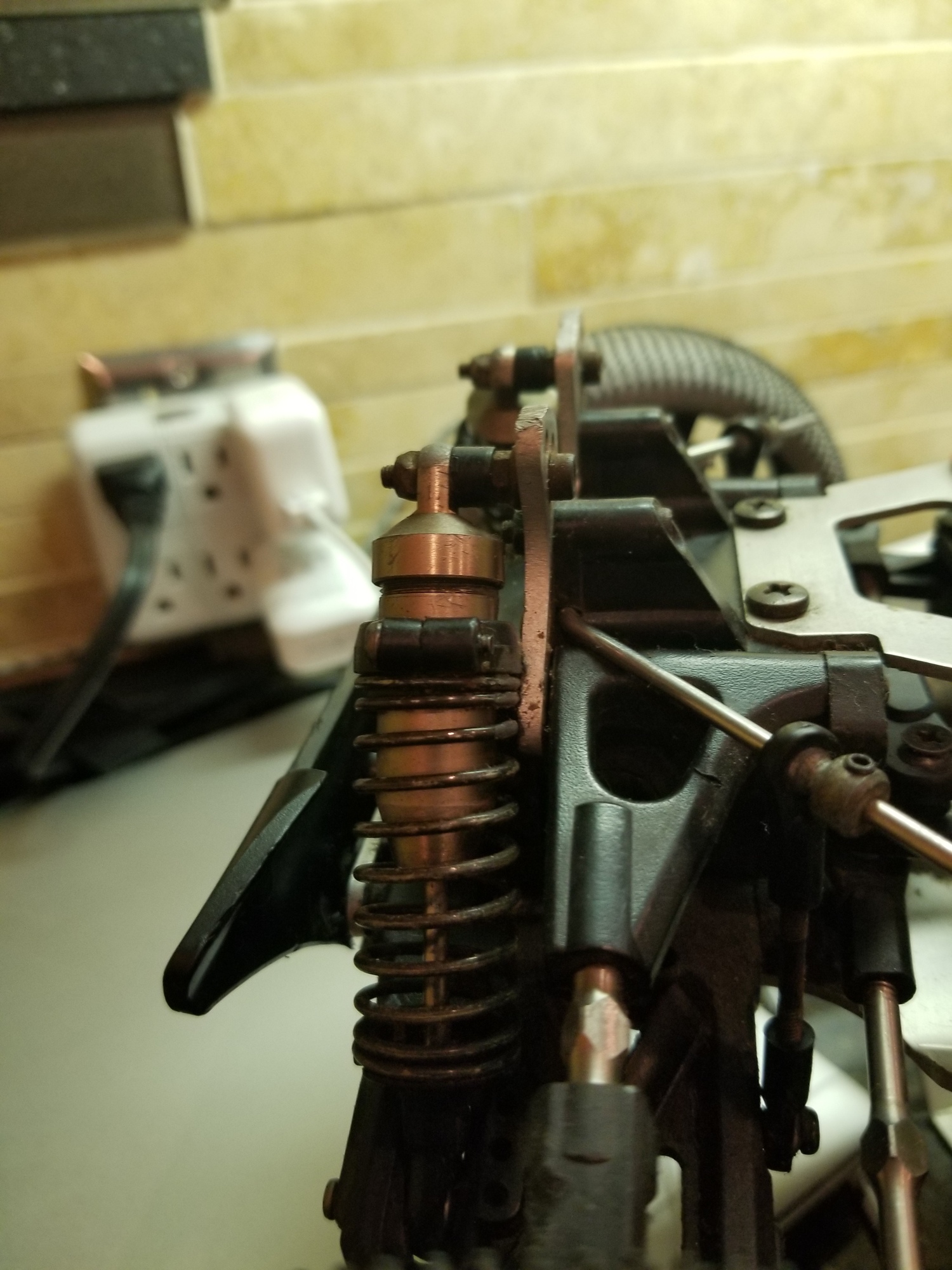

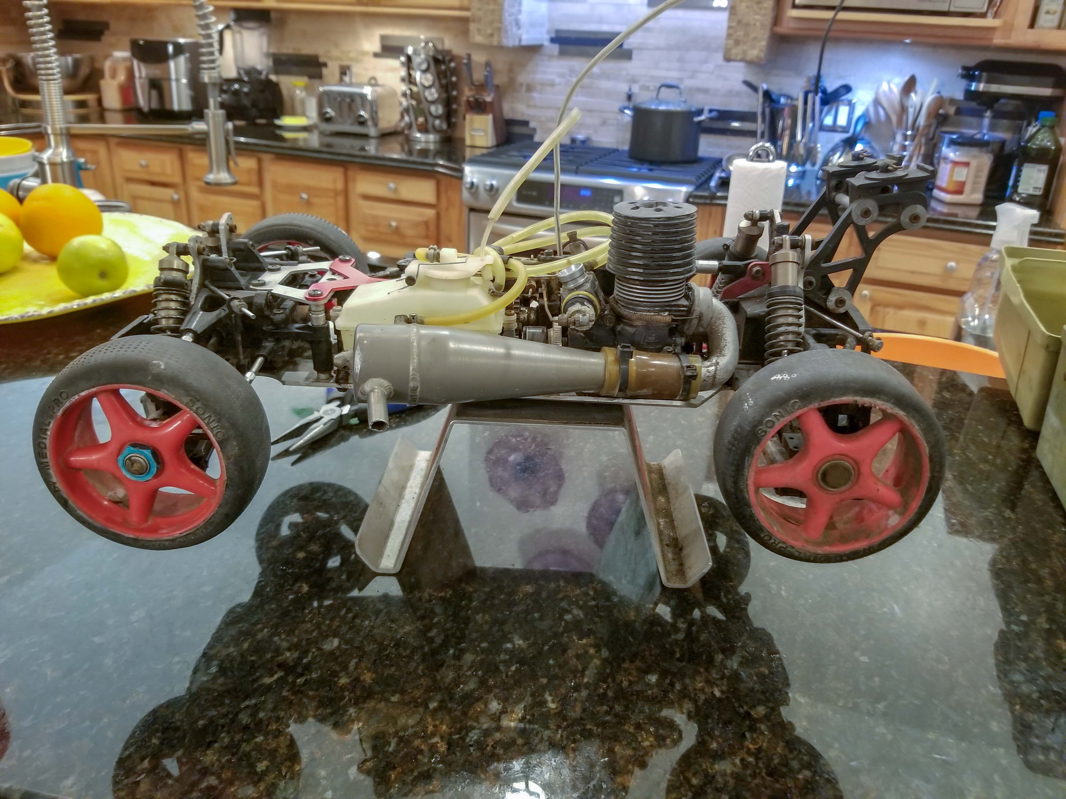

As for my car, I guess I should stop guessing, take this thing a part and figure out what it has and what it needs. I have found a few issues:

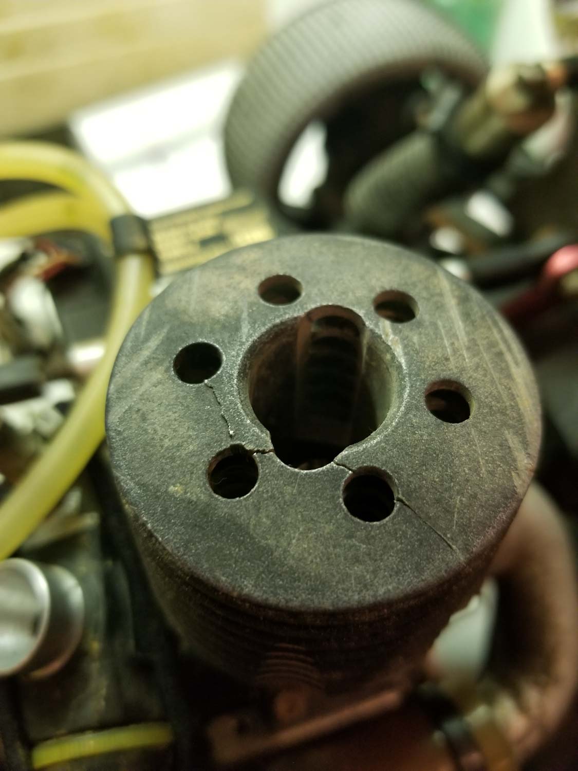

Cylinder head top cooling fin is cracked.

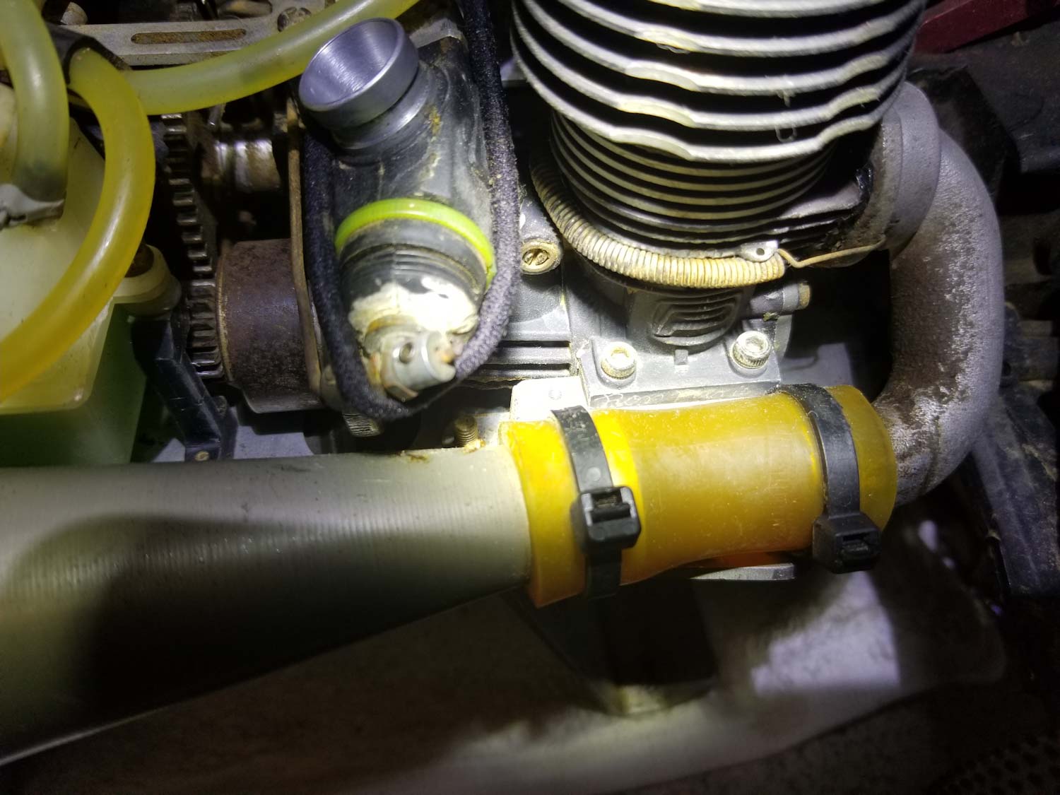

Front steering arm is broken, and I must have epoxied the thing.
Top center aluminum brace is brent forward
Pipe is dented

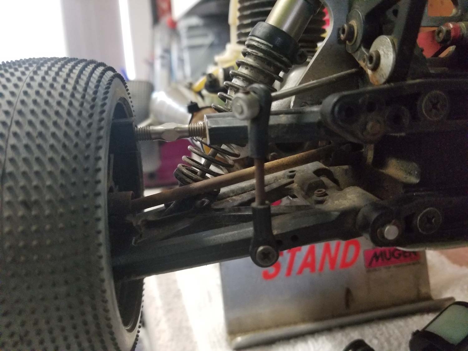

Left front shock tower is bent backwards
I must not remember correctly regarding the chassis. I did find an extra Mugen chassis, so I'm guessing that's what I remember. If this is not an MP4, is it an MP3?
I will look through the manual and figure out what parts I need and get a list together...
Here are a few more pics of my damaged parts...

wow both yourself and the car have an amazing history! It is so cool that this car as actually taken part and won races. Personally I would try to preserve as many parts as possible to keep those memories, but that might just be me. :)
Honestly without the original box, manual or visual clues to indicate that it was an MP4 (Turbo Inferno), it is no longer possible to tell. From a performance standpoint I honestly wouldn't worry about it though. Other than the tires, anti-roll bars, shocks and wing, the standard MP4 had the same parts as the MP3 that actually had an influence on the performance. Even then, it is arguable which of those parts truly enhanced the performance and under which conditions. You can find a table with a comparison between the various classic Inferno models on the Wikipedia page. You have already increased the specs on your car way beyond what a stock Turbo Inferno had.
I guess the question is what you would like to restore it to from a visual point of view and to which extent you want to match the box art.
If you want to go the MP3 route you will need a Lexan wing from Marwan, this set of Decals, https://mciracing.ca/products/blank-sct10-9ced88f8-3377-4c83-a508-db4e6a715e65 a set of yellow BS-105 wheels and BS-40 tires.
If you want to go the MP4 route then you will need a green BSW71KG/IFW213 wing, BSW80KG wheels and W5646H tires (wouldn't use the latter for driving though, they are rare...).
I guess the next question is if and how you will be driving it in future, and to what extent you want to preserve the memories which are in the wear and tear of the car. I would say if you are going to continue driving it, only replace the parts if they are actually broken.
The aluminum plates can be bent back into shape, and sanded down if necessary. Otherwise you can get new ones relative cheap and I am sure members can help you there too.
As lavigna mentioned, those rear dog bones look standard and it seems to be the standard BS-108 chassis. Other than the usual nicks at the front, the latter looks to be in good shape!
The servo saver will have to be replaced, I am sure a member can help.
