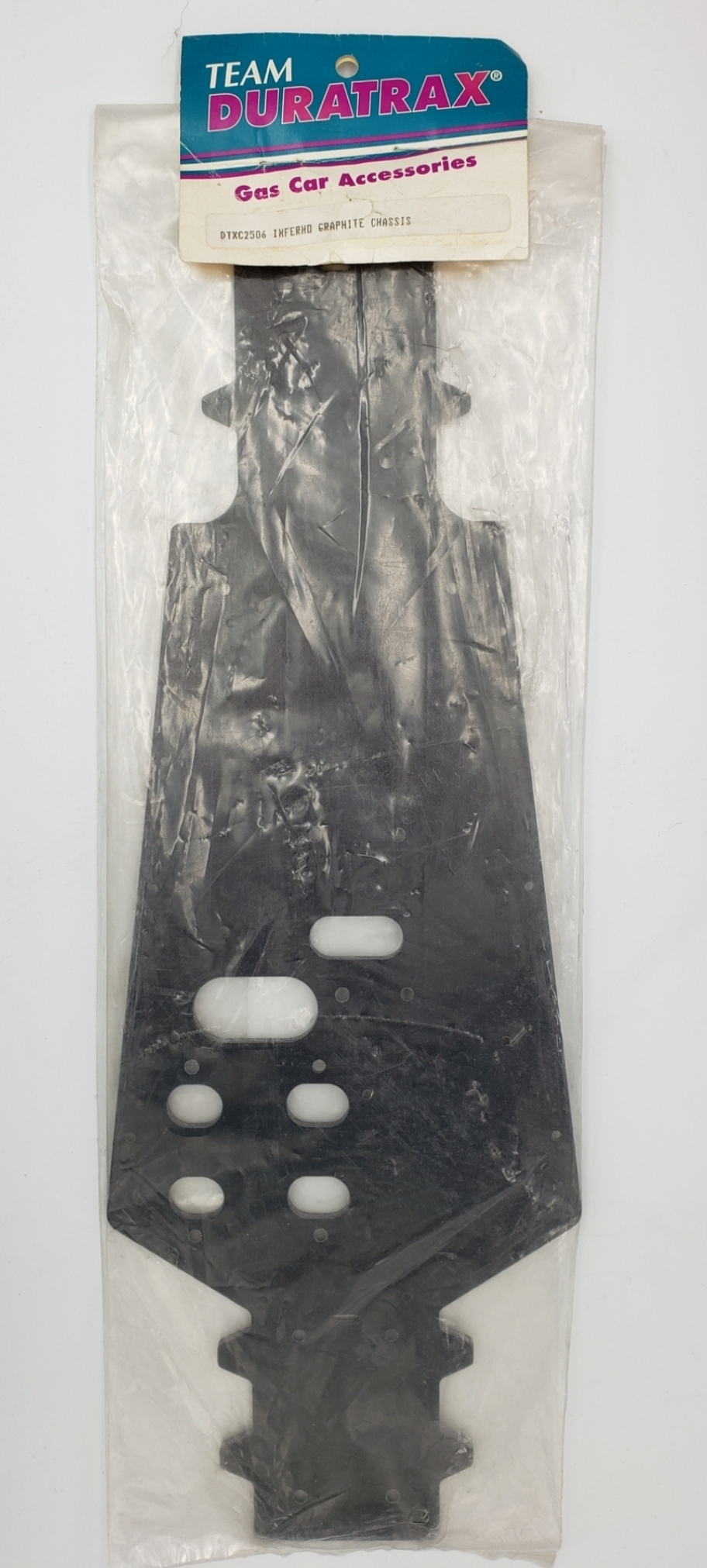

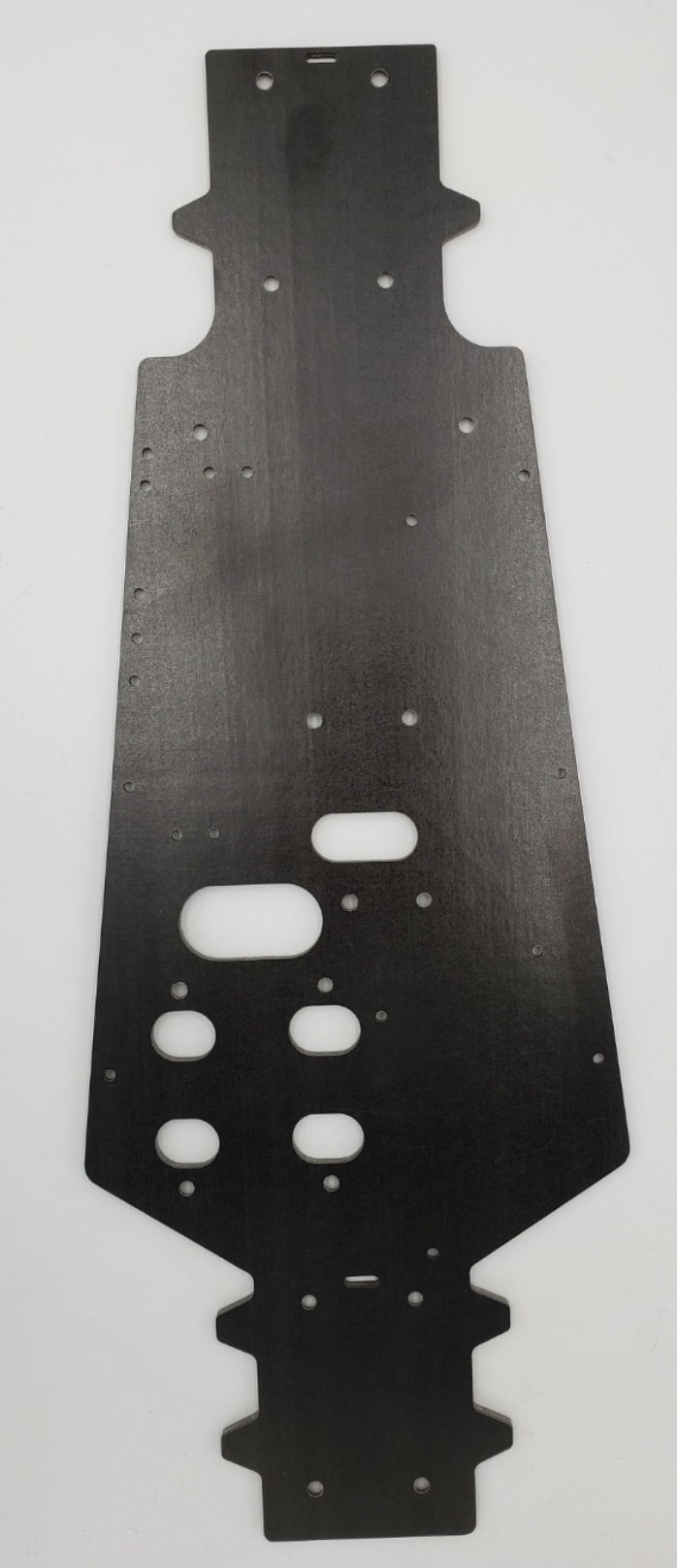

This is the graphite chassis I have on my Turbo Inferno. It is basically the same shape as a stock chassis. You could do the same if you got a piece of graphite sheet.

Lavigna
Posts: 1462
Location: Petaluma, CA
Has thanked: 1099 times
Been thanked: 1418 times
Re: Aftermarket Turbo Inferno chassis question
Post by Lavigna »
Jpjp wrote: Fri Feb 03, 2023 3:40 pm I thought about that but figured I would just mess it up.
Is it easy to work with or do i need like special precision tools for it to look good ?
I think you would want to have someone cut it for you with a CAD program. But the dimensions can be taken straight from a stock chassis. No need to incorporate the side bends of the stock chassis, as the Duratrax chassis I have doesn't do so.
If you wanted to do it by hand, it is certainly possible. I would suggest bolting the stock chassis to the graphite sheet using several of the chassis holes, and then cut around the chassis and drill all the corresponding holes. It won't be fun, but certainly doable.
