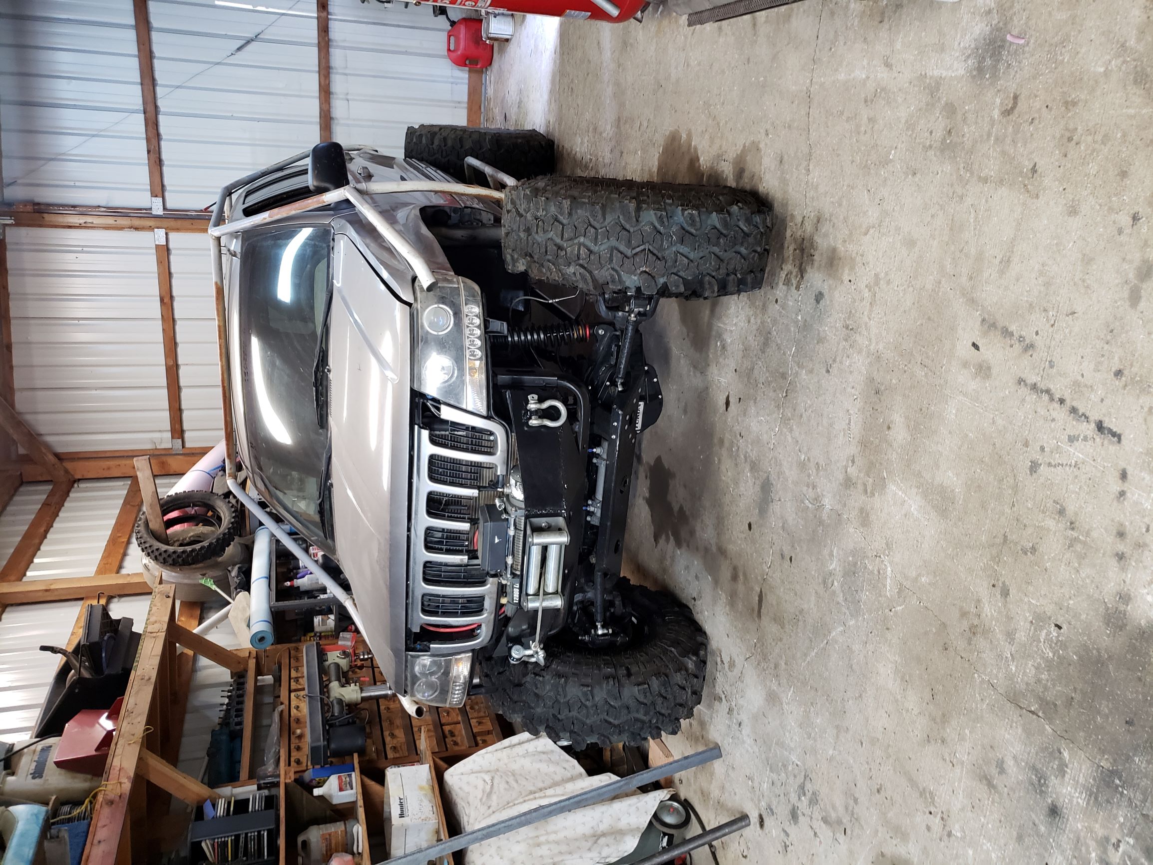

Well my youngest son was looking at my Ultima today and, Said dad that is cheap you need a rock crawler like mine
So this is not a RC rock crawler but is you sub a ESC for a person??
this looks kind of not so tall but the nose of the hood is like 5 feet from the ground. He also has tires that are bigger then these for the big climbing he and his buddies do
I have to us a cooler to get into this dam thing and I am over 6 foot tall
Bill
