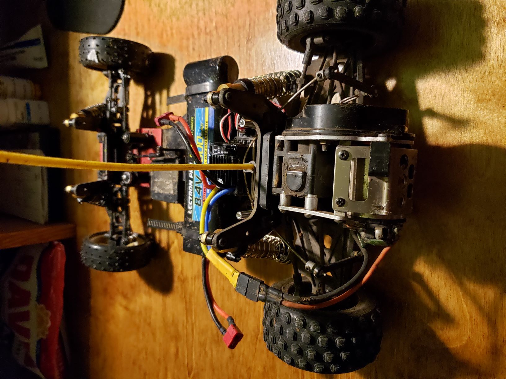

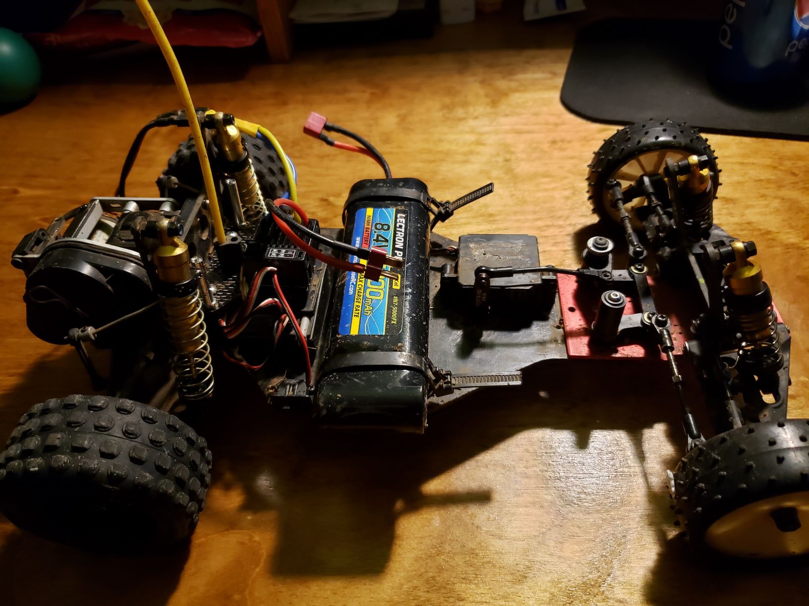

Re: Old Optima and Ultima mods?
Thanks Everyone
From looking at the parts list from the 30625-ULTIMA_IM manual the tranny case is the same as my stock case a UT002 so from what i am looking at the slipper clutch is all internal parts conversion is this right??
Then looking at the Differential gears I have not looked at them for thirty years now but I think they are made from cheap Aluminum and think back to the days back then we had to always replace these gears as they did not last very long on the Dirt tracks !!
So do they make Steel Differential Gears today ????
i do not or will not race the Ultima or my Optima just to go out and play a little bit the motors I have are brushed motors and are old but still work they have all been rebuilt many times! From what i have read between brushed and brushless the brushless motors
last longer! but the guy's at the track said if I went to a brushless motor it would eat up the gear box so I would have to hunt down old parts to rebuild or spend $180 for a programable ESC with a program box??? that would
eliminate having to constantly rebuild a gear box???
They said it would be cheaper to buy new cars at this point!
For me I look at what I have in the Ultima and Optima and see how and what the kits had, compared to the all Plastic cars and truck that are maid today!!!
You don't need to spend that much. Here's a complete brushless motor, ESC and controller card combo that's similar to the set I used with my OptiMutt build (that's an Optima Mid converted to a mid-motored RWD car). I used the 12T version for that as it's also really beefed up. This would be a milder 13T package, the whole thing sells for $63 USD:
https://www.ebay.ca/itm/SkyRC-Leopard-1-10-Brushless-Motor-ESC-Combo-Program-Card-60A-V2-3000KV-13T-USA/181816072961
I found this Leopard Toro combo was very smooth-running. You can adjust a lot of performance variables with the controller card, including how hard the car accelerates (punch). The brushless motors are practically maintenance-free compared to the fuss & muss with brushed motors. You'll need a LiPo battery pack mind you, you can still buy some with the same rounded shape as the original NiCad/NiMH batteries, but they'll have a much longer run-time, and will maintain their full power throughout the charge cycle instead of growing weaker and weaker as the pack drains. You'll also need a LiPo battery charger to safely charge your batteries, because overcharging and over-discharging LiPos will result in explosions or dangerous fires. But, I think you could get all of those electronics for well under your $180 mentioned price.
Battery:
https://hobbyking.com/en_us/nano-tech-4200mah-2s-25c-hardcase.html
IMax B6AC Charger, a decent overall charger for most battery types:
https://www.ebay.ca/itm/Imax-B6AC-80W-6s-Lipo-Nimh-LIFE-Balance-Charger-RC-Battery-DRONE-PRIORITY-SALE/233638178926
The Optima & Ultima gearboxes were actually pretty decent, the weak link being the final pinion gear inside the gearbox. Once those were upgraded to hardened steel or hardened aluminum gears, the cars should be able to handle a combo like the one I linked. Hobby store employees who say modern power will destroy our vintage cars think we're all gonna do stupid crap like installing 6T motors with 3S LiPo batteries and stuff...but keep it sane, adjust the punch and you'll have a very quick, driveable car.
Battery:
Bill - I know it´s a lot to take in for an old man
But I told You that You´ll need the new transmission housing for the use of the new 2019 steel internals. That still stands.
Thank you
DennisM ok, can you clarify the parts needed, this is what I have come up with
Diff Inner Parts Set (OPTIMA 2 Part Number OT222
UT002 Gear Box (ULTIMA) Part Number UT002
UT008 Diff Gear Case & Pulley (ULTIMA) Part Number UT008
Gear Set (OPTIMA 2016) Part Number OT221
Diff Shaft (2pcs/OPTIMA 2016) Part Number OT224
Gear Shaft Set (OPTIMA 2016) Part Number OT225.
UT009S Motor Plate (ULTIMA) Part Number UT009S
The gear box UT002 is the same gear box that I currently have in my Ultima and i have a spare gear box I just found in the old parts box so from the list I got from here http://www.kyosho.com/jpn/support/instr ... A_spop.pdf
it is just the internal parts to build the re release trans right??? I am not trying to be a pain about this just clarification please
as for the OT-74 limiter gear set, that is the pinion gear with a built in clutch right?? I got three of those in my old parts box one is melted
the other two are very lose!! thinking back to those days these things did not work that well either!!
Aluminum and plastic gears did not last very long no matter what you did back then.
Dennis I do not mind building a new trans i just would like to get all the parts needed in one order and not have to place to or three orders
For me this is more of a resto for both the ultima and optima but both a playable resto trying to digest all the new stuff
