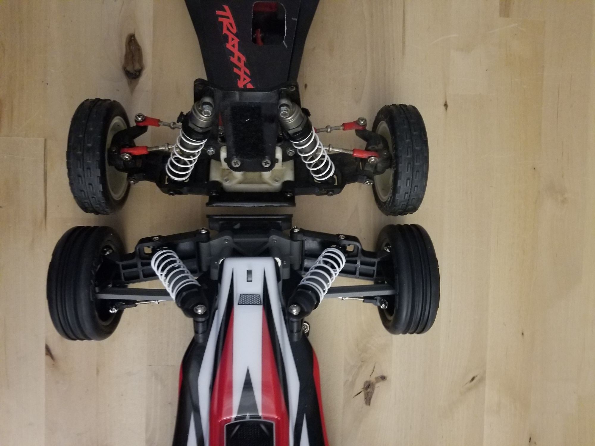

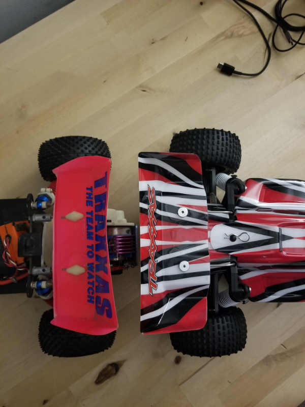

Re: Bandit performance potential

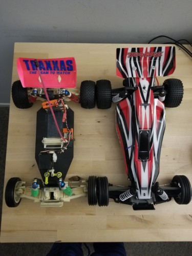

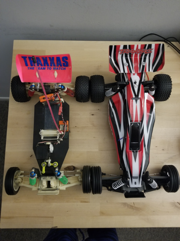

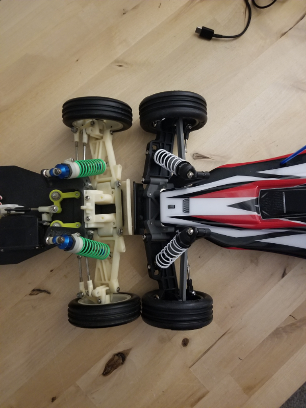

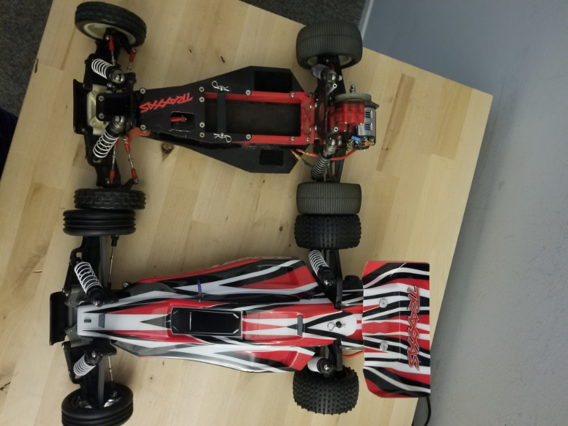

Bandit is really not all the different than TRX1 and slightly longer than TRX3. Here's some quick photos I just took. There are so many different length Traxxas arms across platforms and hex wheels are easy on these, you could bring a bandit down a bit with little effort.

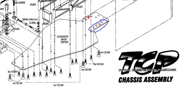

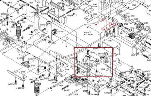

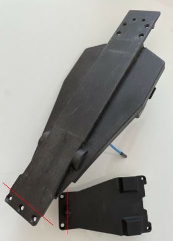

Since the chassis itself has no kickup, and the original Bandit / Rustler chassis is like a dime a dozen the mod can be quite simple, unless you want to be able to change the wheelbase back again.
So to shorten the chassis I would simply cut the front end of the chassis off and drill 5 new holes:
Add a steering rack that allows to mount the servo sideways and you're set. I am actually going to do that with my kids cars, I just don't like how the steering hangs out of the side.
With a flat chassis the rear would be the way to go:
The old flat Chassis like TCP, TRX 1 / 2 had the rear shock tower mounted in line with the rear arm mounts, so 2 extra holes per side gives you 2 positions for the whole rear unit:
So to be honest there are options that are not too hard to achieve to shorten the wheelbase.
Good luck, and now surprise us with a cool build!
