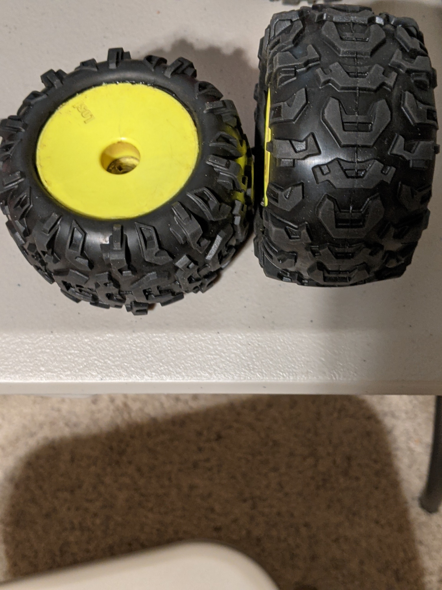

The large tire in the pic is a Primal RC solid axle monster truck. Saying it’s gigantic is an understatement.

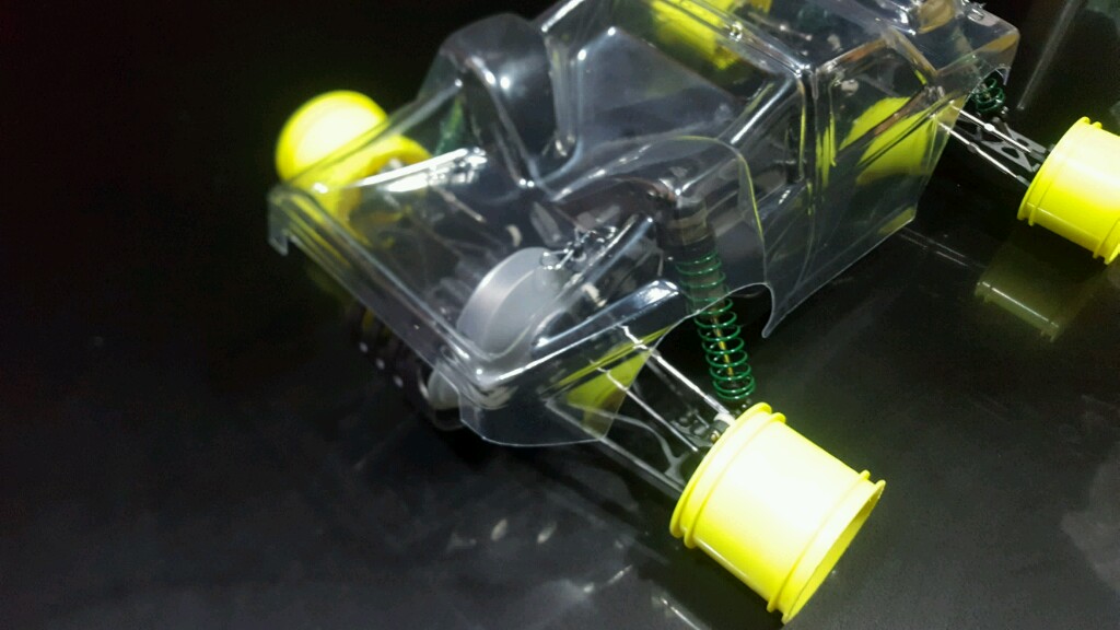

At least it's a roller now, I didn't bother doing a build thread as it's just a stock T2 with Lunsford turnbuckles.
I just need to make up a rear spoiler and to decide whether to glue up some onroad tires or offroad tires.

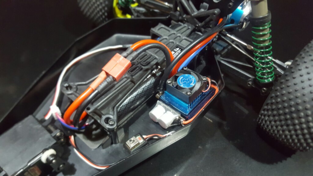

Maybe I should call this the unfun truck

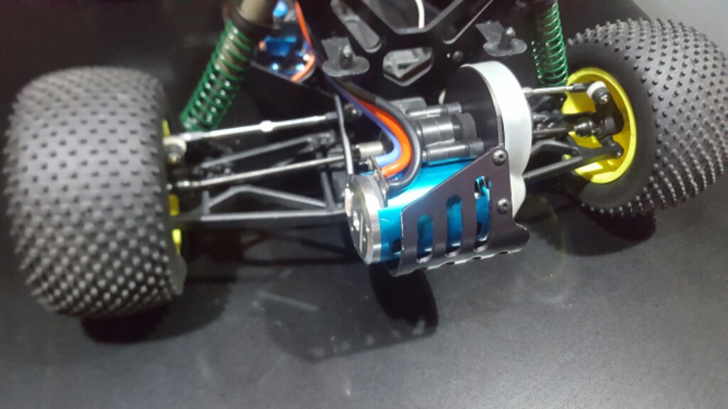

to be honest I haven't really enjoyed this build much for some reason, but It's finally starting to take shape and is nearly finished. I just need a servo extension for the ESC to reach the receiver and paint the body.
I would also like to drill a new antenna hole as the T2's is in a terrible spot, I might actually make a little fiberglass bracket to offset it slightly so I don’t have to touch the chassis.
I've soldered up the motor and ESC for it. The RTR T4.1 that I bought for my throwback truck came with a like new Hobbywing XE Run V2.1 combo which I thought I'd use for this truck. I basically had to unsolder all the power/motor wires as whoever originally soldered it up used a highish temp gluggy silver solder. I also had to remove the solder cups from the board to clean them up before resoldering them back on and the wires. It also turns out the prior owner never installed the power cap, so I had to try and find one of those, then replace those wires as they were too short
Digging through my pile of electronics the servo I wanted to use had what seemed like a mile long lead on it and was the ugly twisted wire style, so I replaced the servo lead with a much shorter lead.
I've plugged it all in to test and so far it runs fine around the house. It should run well, I've used tons of these hobbywing 8.5T's and they are fantastic. Looking forward to actually driving this thing.

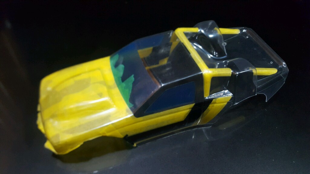

I also masked up the body today, fingers crossed it turns out ok. It's a pretty simple paint job nonetheless.....

Body finished, I used whatever colors I had and sticker bombed it. Not fantastic but good enough for a runner, some better stickers would make things better. There was hardly any paint bleed which is unusual, lol. I need to learn the airbrush
I'm not a huge fan of the Jconcepts fiddled body, although it's is still a better alternative to not having any bodies available.

That turned out pretty cool. I never have any luck with masking tape.

Came out Aussie’um ! Sorry had to do it...
Tamiya masking tape ? Nothing better

Tamiya tape is pretty good, a good all round tape. I don't think it leaves the sharpest of edge lines though compared to other tapes.
Liquid mask I haven't had much luck with though, but I've only tried it twice and I think I went wrong with it being too thin. Even then I'm no good free-handing a design with an exacto, so..... what could go wrong.......
I have seen a window pop out at the track during a crash because someone cut too hard into the lexan while masking.
