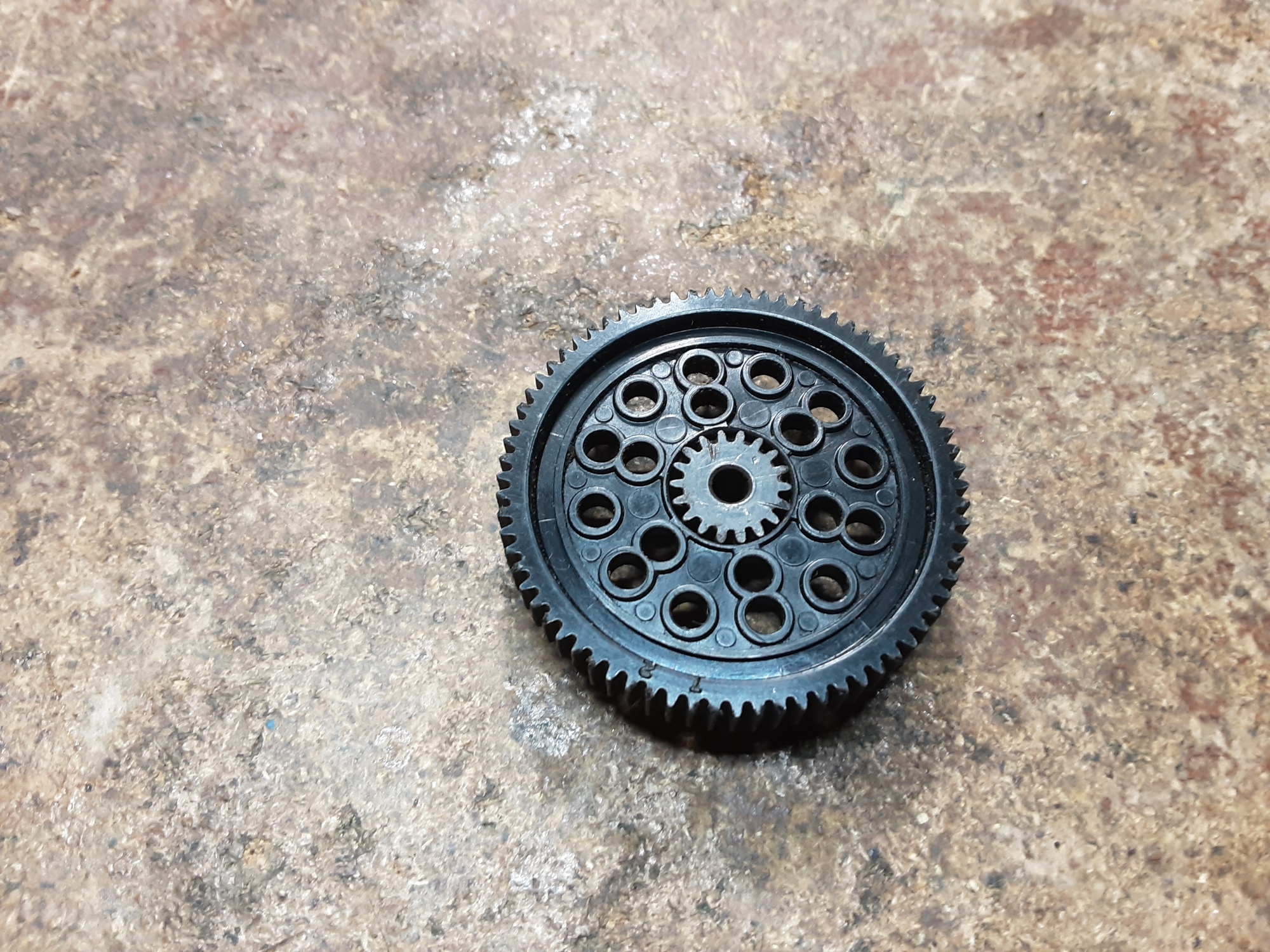

I'm still collecting stuff but this is what I come up with to attach the reflective tape to. I took a smaller spur gear that I had laying around and opened it up just enough for a pinion to fit snugly.
I haven't glued it together yet, but I spun it up on a 15T modified. It spun true, without any vibration or wobble. I figured that this would give me enough diameter to get a reliable reading without adding much mass.

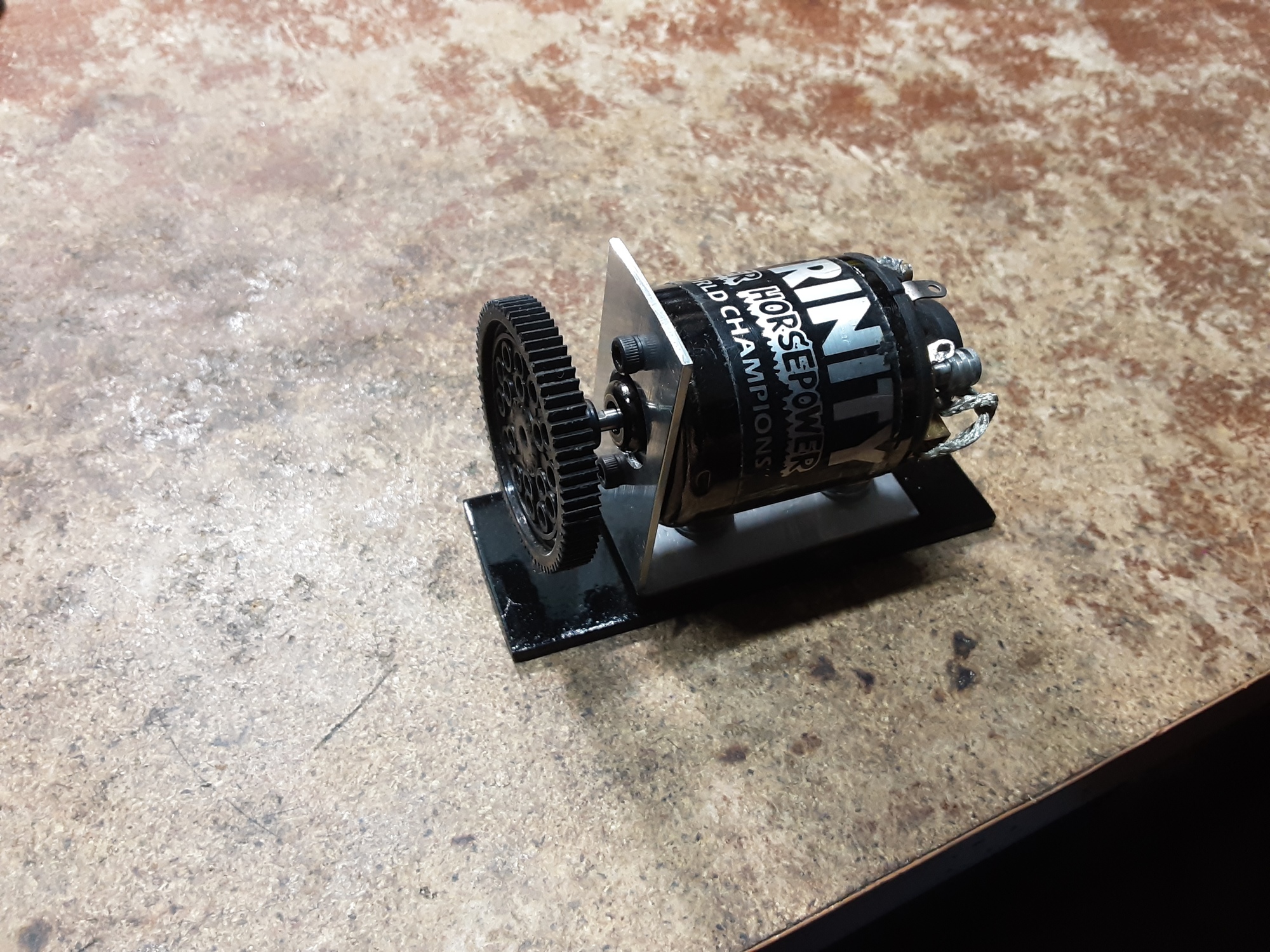

I made this bracket with some scrap metal. 1" aluminum flat bar bolted to a piece of 1.25" steel bar.
I tried it out but it really needs something more substantial. It will stay upright while running but vibrates around. It will also torque over on a full power start.
I think a small selection 1X lumber and some non-slip feet would do the trick. It would also give me somewhere to secure the tach with a rubber band.

I like the idea of a lightweight printed disc. You would have more control of the surface that the reflective tape was mounted to.
As suggested above, I would still design it around a pinion gear. I like the idea of a metal hub and secure attachment. Even 540 sized plastic pinions have metal hubs.
Either way, it should be interesting.

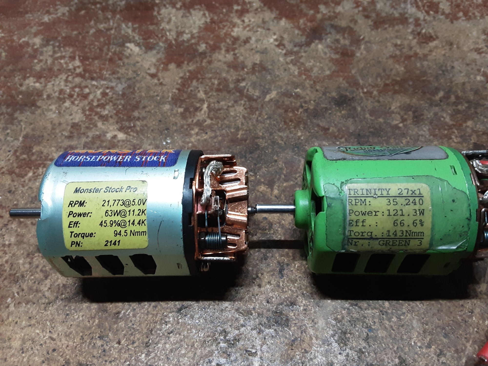

I thought this was interesting.
The Revenge of the Monster Pro obviously has the dyno sticker from Trinity, rated at 5V. The Green Machine 3 Pro looks to have dyno results from an outside source.
Given that they are both 27T, 24° Trinity Pro motors from the same generation, I'd expect somewhat similar numbers. The only other alternative is that the Green Machine was tested at higher voltage.
Also, the RoM's literature clearly states that it is a higher rpm motor than the GM3.
I haven't done any research as to whether Trinity tested all motors at 5V or if those may have been intended for 4 cell racing.
You can click on the pics for clarity.

Interesting. That kinda makes me wonder how Kyosho rated the RPMs of their Le Mans motors, as their older motors were all intended for 7.2-volt NiCad batteries, but what about the later cars that were intended to run 8.4V NiCads and 240S-variant motors on those 7-cell packs--like the Turbo Optima and Salute, for example? I wonder if their "official" RPM ratings took this into account, or if they were all measured equally with 7.2 volts of battery power?
