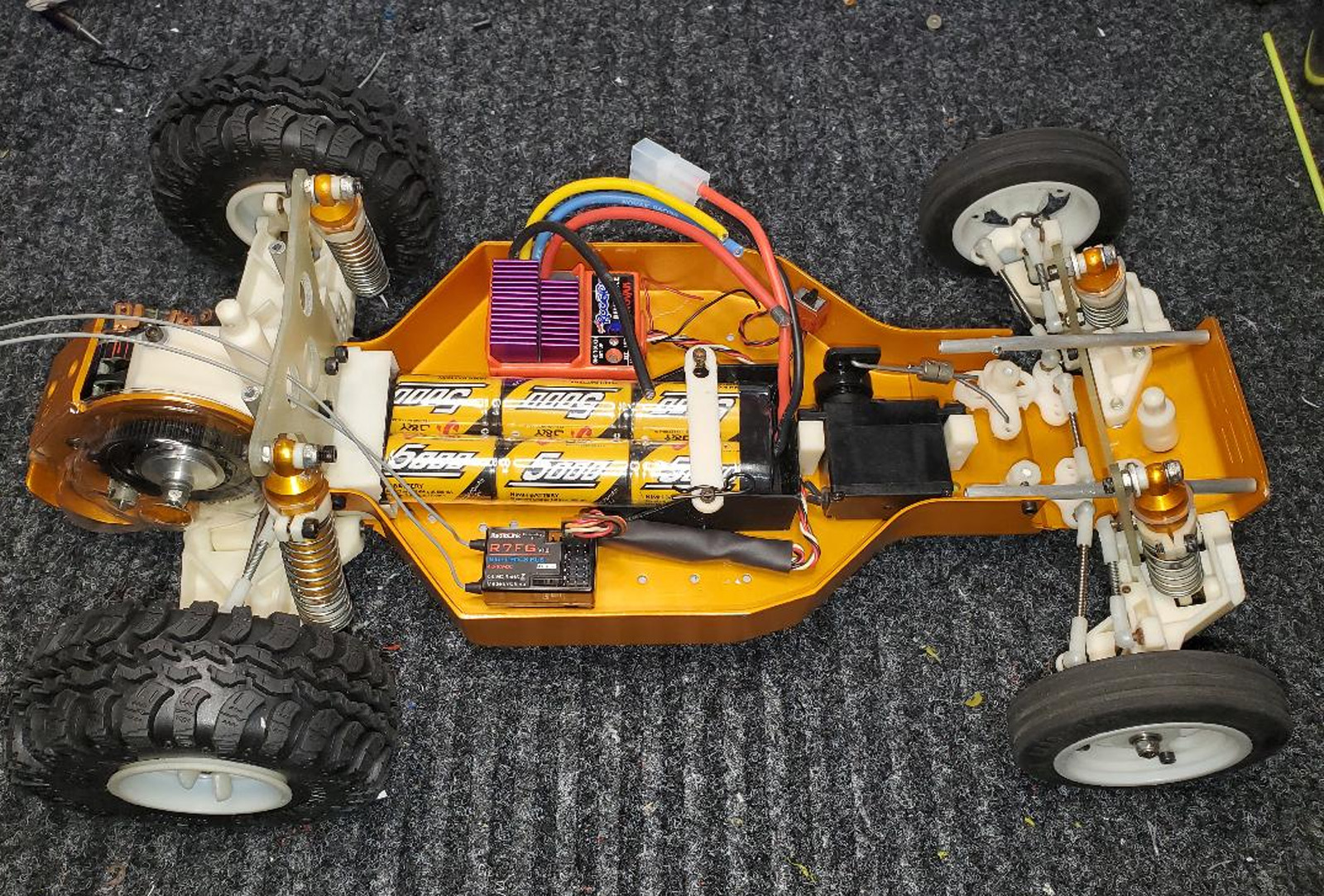

Hopefully finish up wire terminations and paint the body over the next few days, and this thing will be ready for its maiden voyage. Not sure if the tires will stay on the wheels, but will find out. Everything takes so long now; stupid Spring and nice weather forces me outside!
Quick question: neither of my parts cars had a front anti-roll bar. Is one really needed?

Re: Refreshing a RC10 GP - Will Have Many Questions Along The Way
No....but its cool and brings the value up

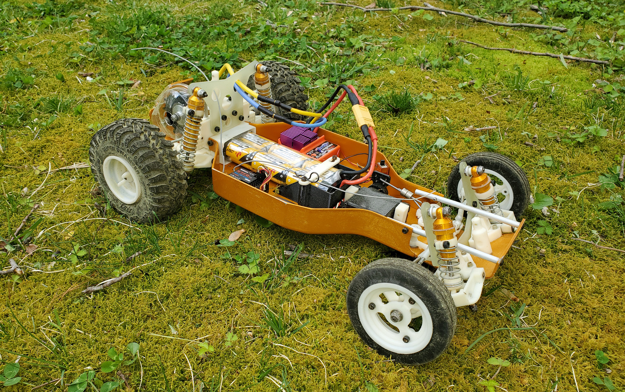

Maiden voyage went well outside of the Monster Jr 27T not happy at all and letting some of its smoke out. It also got about million degrees. I got rid of most of my motors awhile back, but am looking to see if I have anything around that would be more suited for the task.
Waiting to get another body and get it painted and on before taking it off any sweet jumps. My re-re was supposed to be here by now so I could scan the decal sheet and get a new one printed off, but with the USPS, it is unknown when that will happen.

I bet it wasn't happy. A 36° motor, with a six gear and tall tires is a horrible match. It appears that you are running in grass, which is even worse.

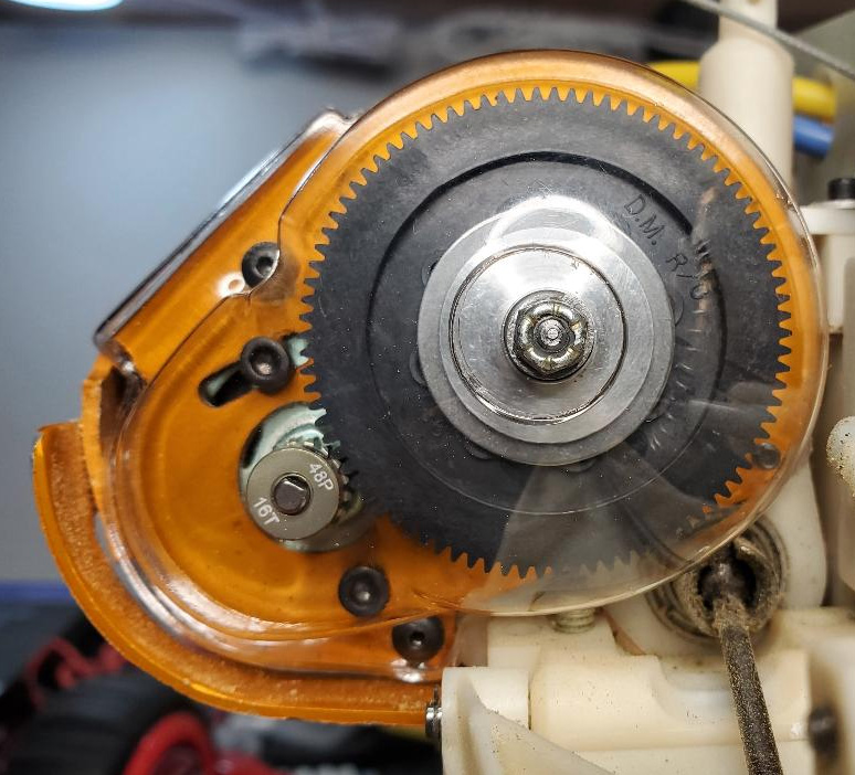

I have an extra six gear transmission laying around, so I did some fiddling with spur gears and gear covers. With the original clear cover (looks like yours):
- An 84T spur clears easily.
- An 86T spur rubs slightly, but there was enough slop in the holes to tweak it enough to just clear.
- An 87T spur rubbed, period.
An 84-85T spur and small pinion would lower the gear ratio a little.

I have an 86 spur sitting around so I can see if it will fit under the Parma cover. If not, I will source a 84 - 85. I have an 81 on there now.

Since we are rightfully bringing tire diameter into the formula, can't we use rollout as an apples-to-apples comparison? Let's bring the carpet world into the buggy world!
I dove into my RC10 bin and found an unused set of what is labeled as "TR8412" tires. These seem to be some sort of vintage "You-G" tire made for buggies. When comparing them to stock knobbies, they look to be about the same thing. They are 3.35" knobby outside diameter.
The RC10 re-re manual loves 18/81 FDR, so with 3.35" tires, we are looking at a rollout of 1.28.
Running quick calcs, I can run my 3.83s on 16/86 and end up with a rollout of 1.22. I have a 17t pinion that can bring that to 1.30.
The 86t spur gear fits fine under a super thin Parma cover.
Of course the fact that I just discovered that I have a brand new set of vintage knobbies may make all this a moot point, but again, I may like the big tires when all said and done.
