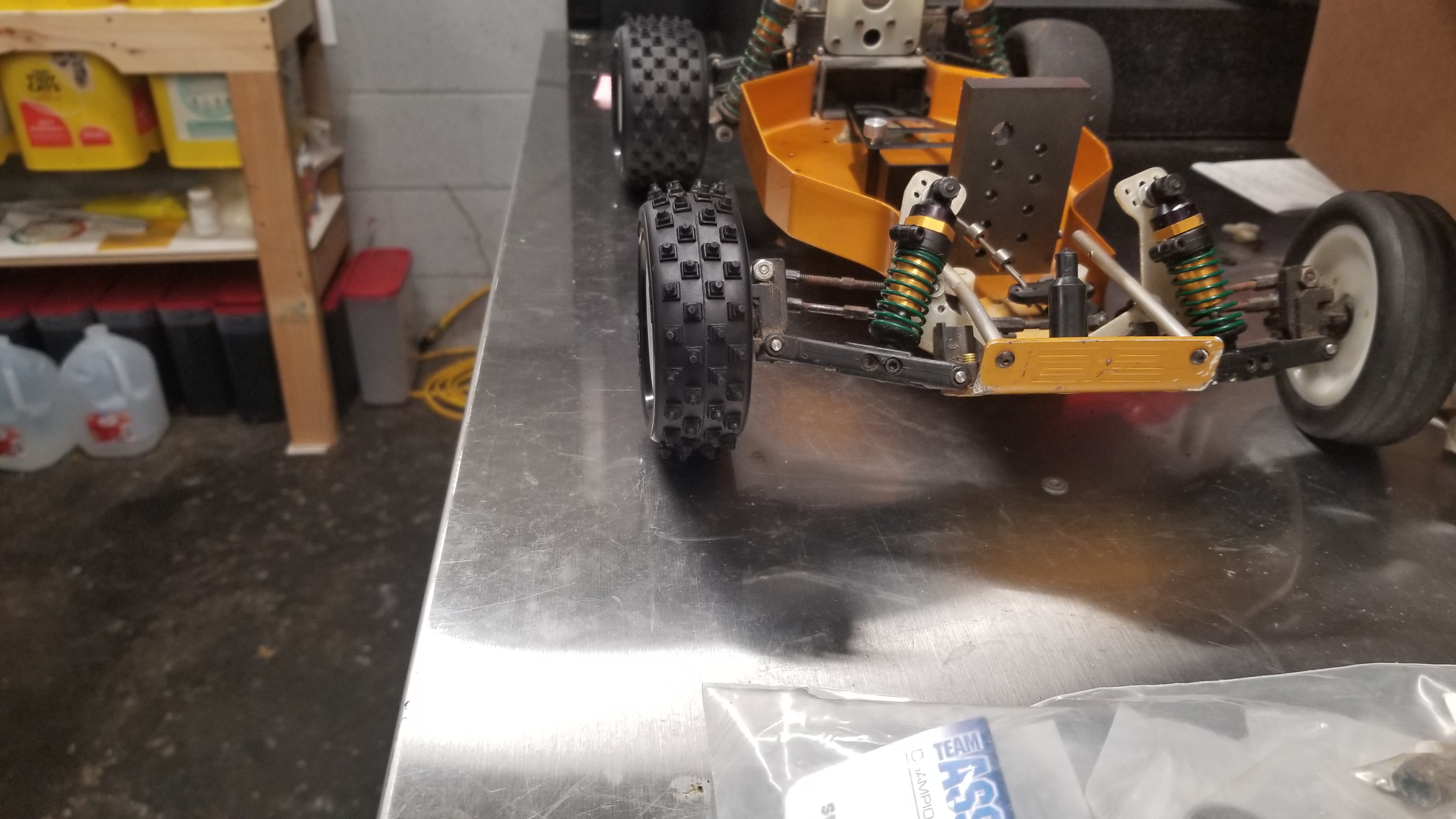

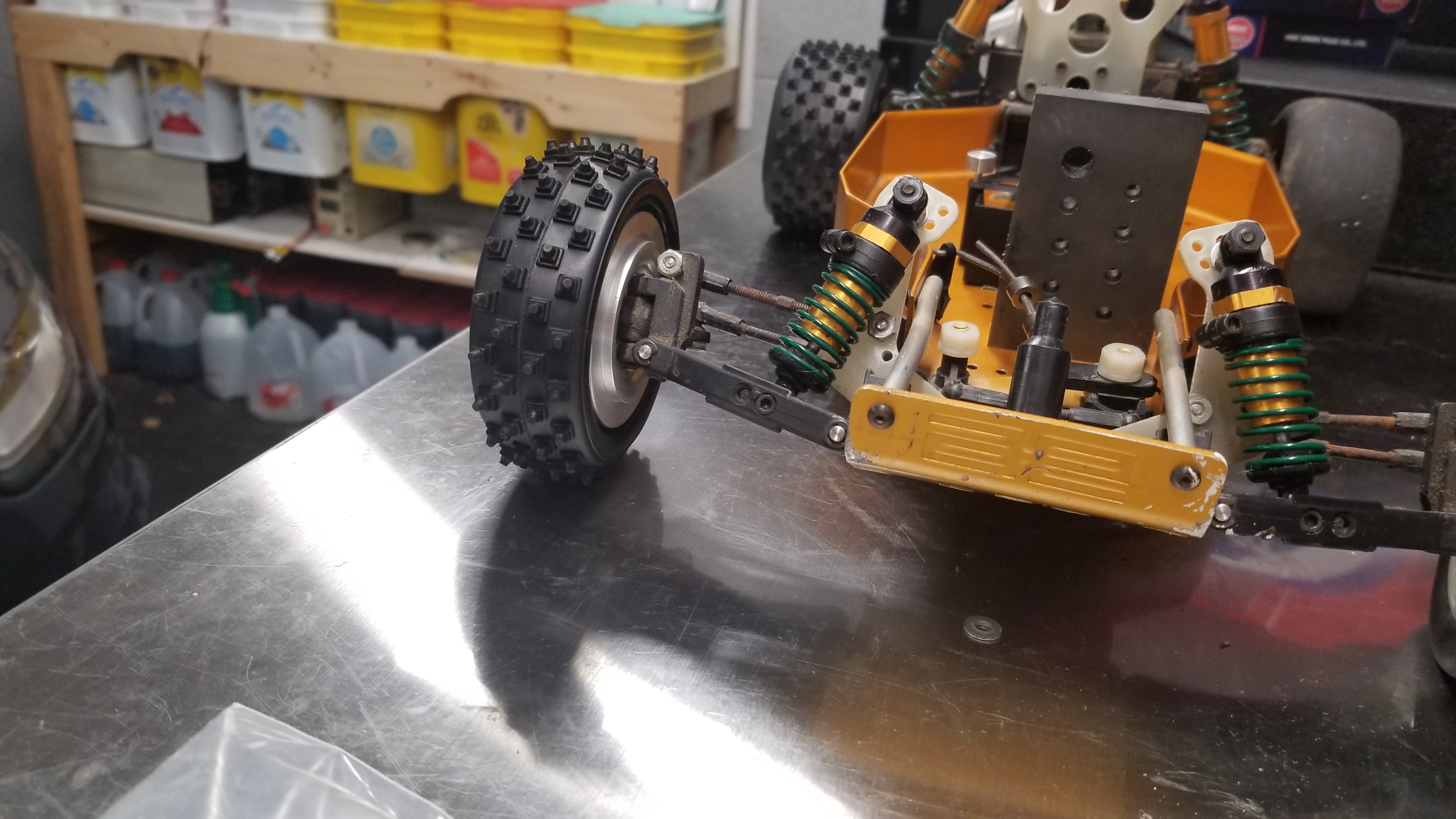

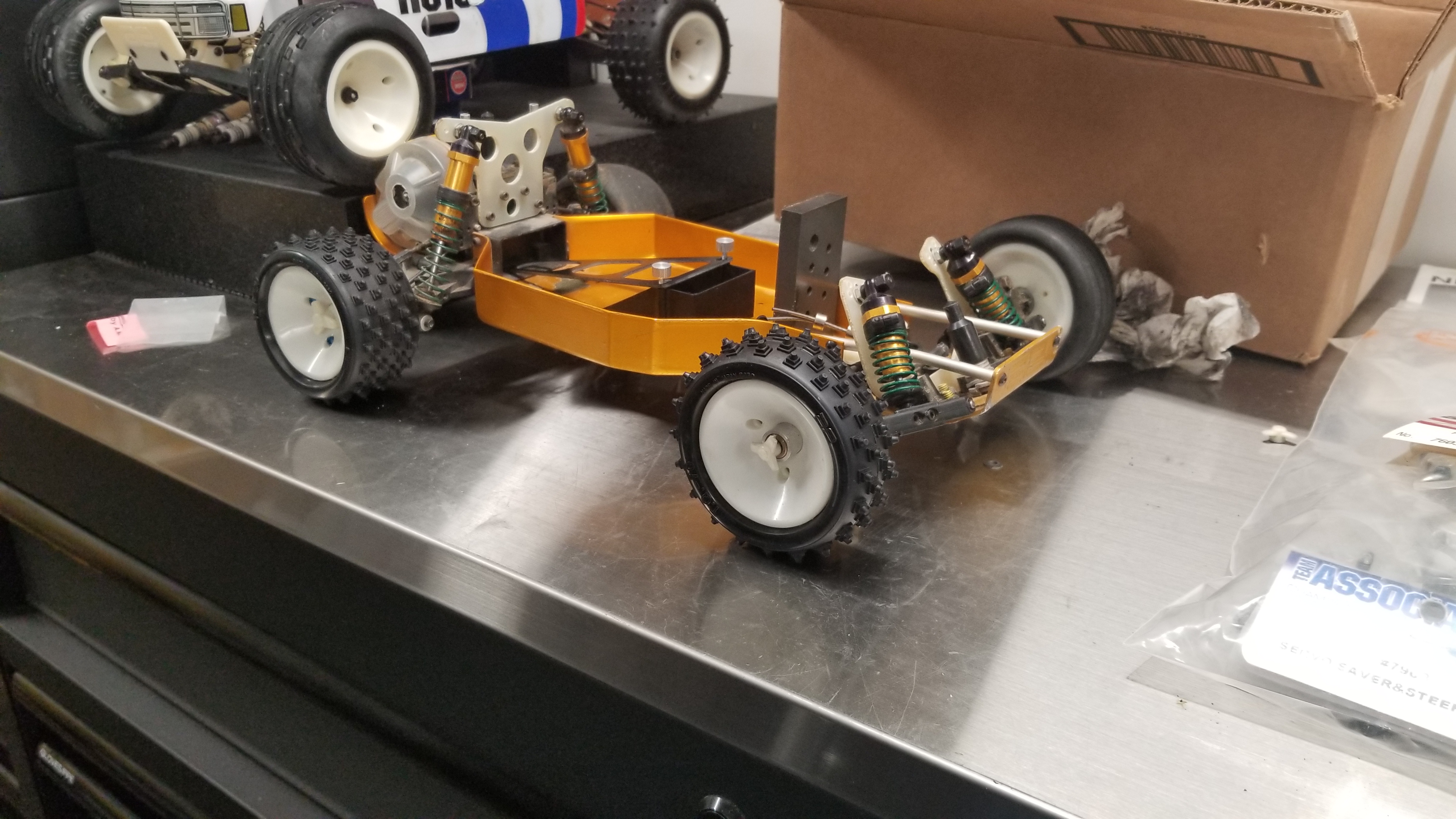

If these tires where cheaper and more available, I would try that out. I ordered some nylon bar stock last night and am going to make a custom set of 3 piece fronts in 2.0" diamater.
BTW, I tried the rear outer dish on the fronts. The offset is actually pretty good, but I don't really care for the look as much as I originally thought i might. Some pictures for reference.

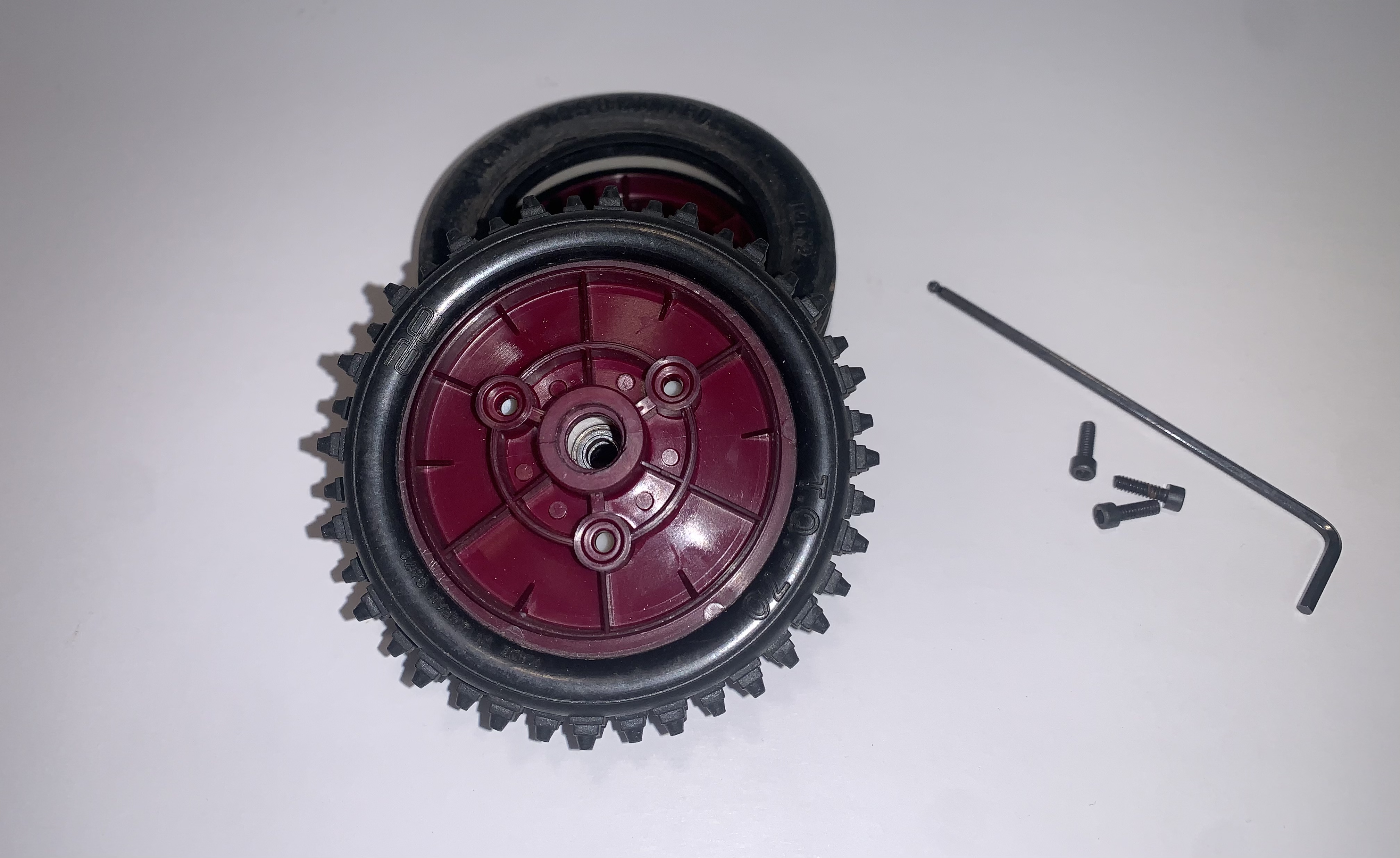

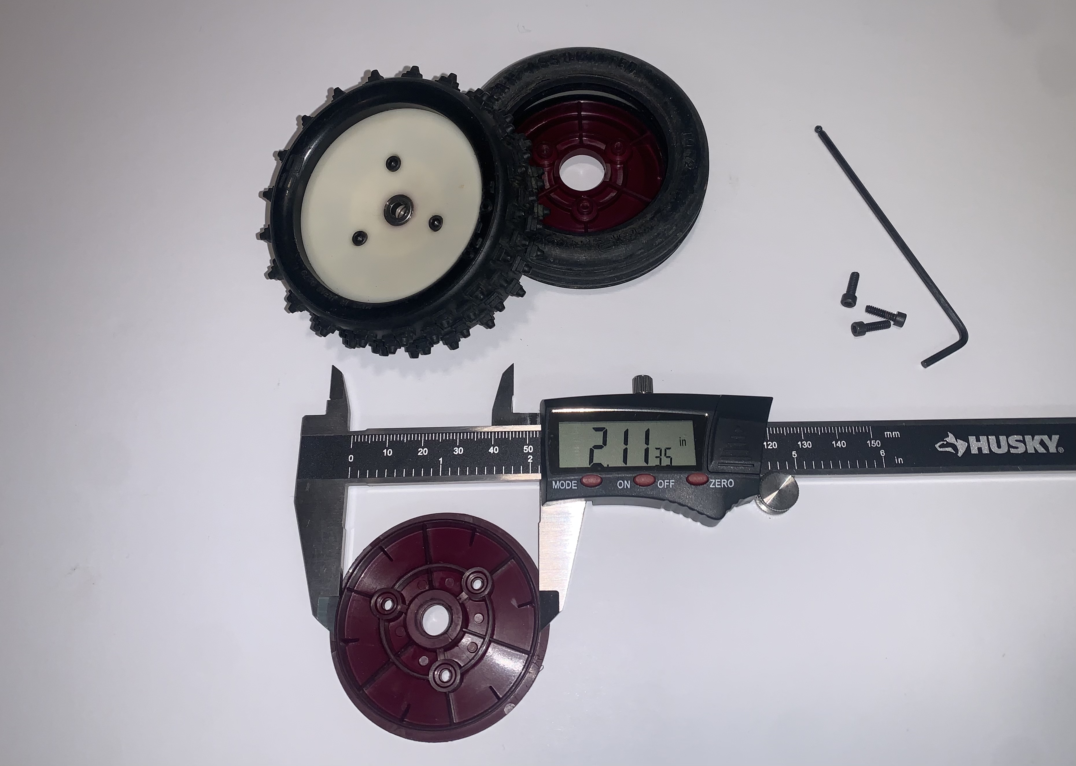

Ok decided not to disassemble the white wheels.
I’ve got a set of slightly used ones so I took them apart and measured.

Re: RC10 2.0" front wheel options for TQ70 tires
Here you can see they are the same size as the white one it’s sitting on.
