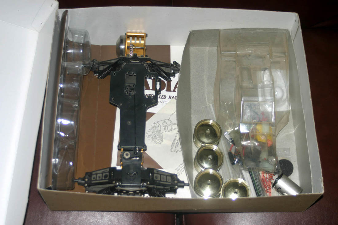

You guys have inspired me. Here is my 1 of 2. I need to dig out the other one, of which will be build as the Race Prep/US version. This one is in great shape, run once.... I think there is one mark on the back motor guard. Also have a set of NIP box art tires already for it ready to go on. Body was cut and seems to be very fragile, as the the rear mounting section is pretty much trashed.
www.gojammedia.com

After some discussion with Darryn, is sounds like my other one is the Pro Radiant or a Boost (not pictured), I need to pull it out to be sure. He says the one pictured is throwing him for a loop. :D

What you have there appears to be one of the "specials" that Race Prep rushed out to rescue the flagging sales of the original Radiant. I have NEVER seen one in the flesh before - so great that you have found one. As you can see on the "Race Prep" version of the Radiant you have has ball bearings, Oil filled shocks, Race prep motor etc. This was a vast improvement over the terrible standard shocks supplied in the original kit (honestly worse than the worst of Tamiya shocks!!). The shocks appear to be development shocks as well - because the lower cartridge area is significantly different to those used on the Boost and Pro Radiant.This car you have also appears to have a Radiant Pro style bumper and front shock tower. Pretty amazing stuff I have to say - that is truly a rare bird indeed. What a terrific kit.......
The Boost and Radiant Pro had "mid mount" motors. The cars were pretty much identical with the exception of the bodies and lower chassis. The "Race Prep" Radiant Pro had the best layout for the chassis with a saddle pack configuration. Sadly the cars were way behind the times, with Belt drives totally dominant (we are talking very late 8's to early 90's here!) - they simply could not compete against the mids and dogfighters.....hence why I love the one I am rebuilding in this thread - as it is one of the ones that the original owner refused to give up on and converted it to a mid belt drive......I really want to keep it period correct.
