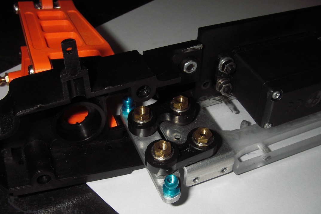

Hi all, this is a build i'm currently working on, i use to own 2 of these buggys but i sold them quite a long time ago to a bloke that now we have become good friends, i've always love the Boost and a couple of years ago i got my hands on some parts that was going to help with the re-building, i'd like to thank Jason (Bormac), Darryn (RC Retro), Alex (Incredible Serious) and Tony (Dirt oval RC) for the help with parts and info.

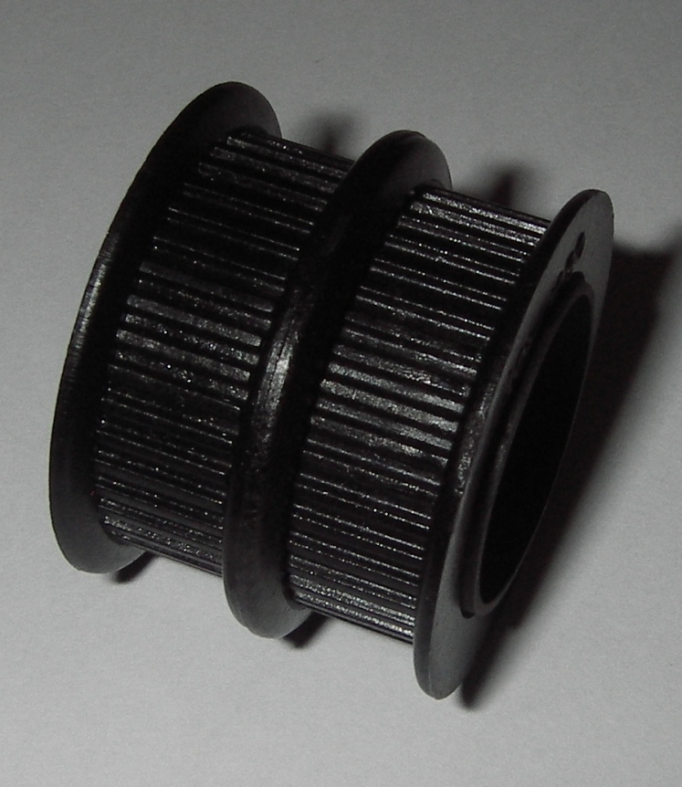

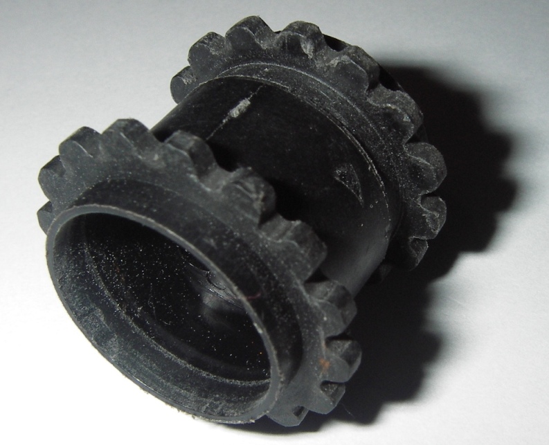

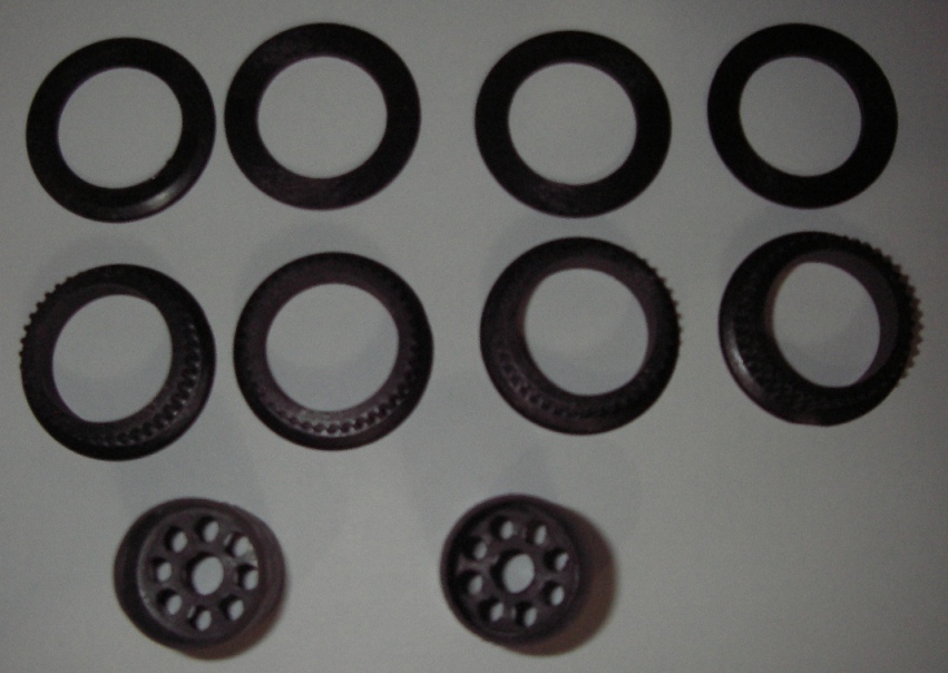

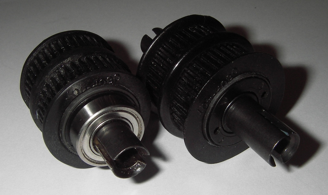

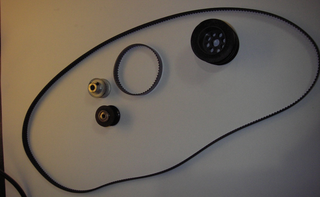

The first thing i wanted to do was get rid of the chain drive and convert it to belt drive, so i got on the web and ordered some timimg pulleys and belts, i then got the original chain pulleys and removed the teeth, i then machined the pulleys to fit nice and tight (like a finger in a nuns bum) I then glued it all together with industrial super glue. (hopefully it should all hold together from what i've been told)

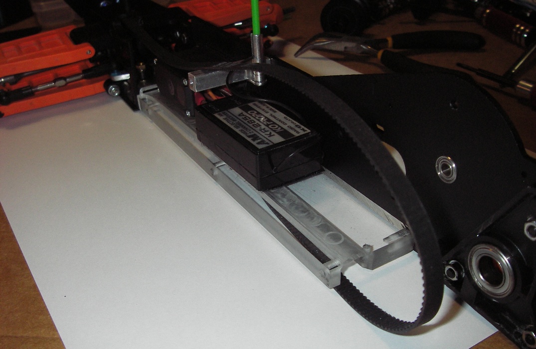

I then had to make a new bottom belt cover, i used 8mm clear perspex, i machine a groove to suit the belt, i also drilled and tapped it so i can screw it to the side chassis plates and the bottom chassis plate to it.

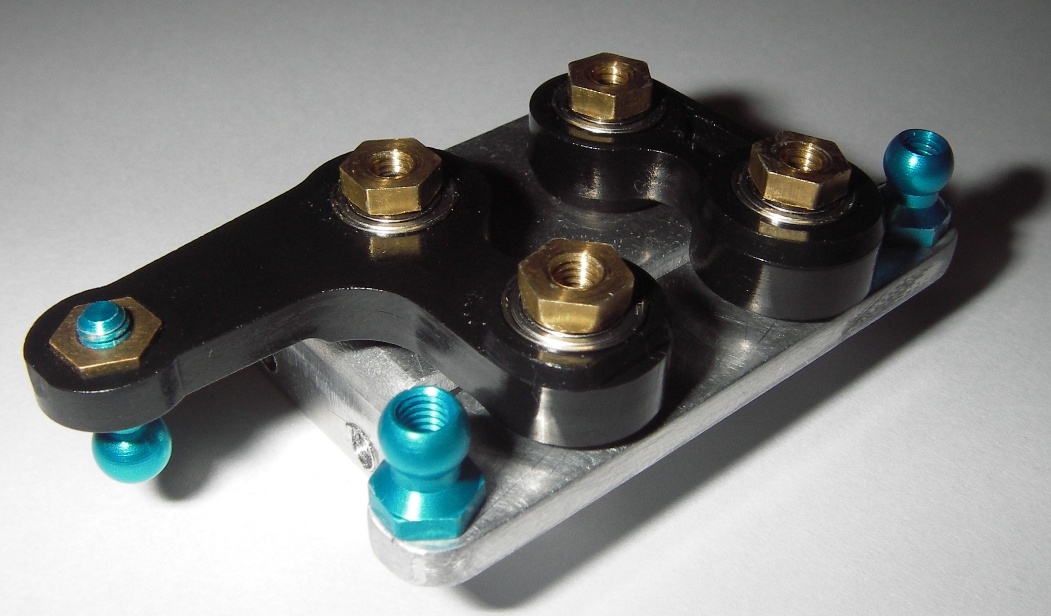

I then had to work out what steering i was going to use as i wasn't able to locate the original set up, i tried a few different types but i found the Avante set up was the best, it was also ball raced which made for nice smooth steering, all i had to do was make a new steering plate, as the Avante one was too long.

Now that my friend is blinkin art!
Really impressive work mate. Super Tidy and clean.
I will have to post up some pics of the orginal belt conversion that is on mine..not as nice as yours though!

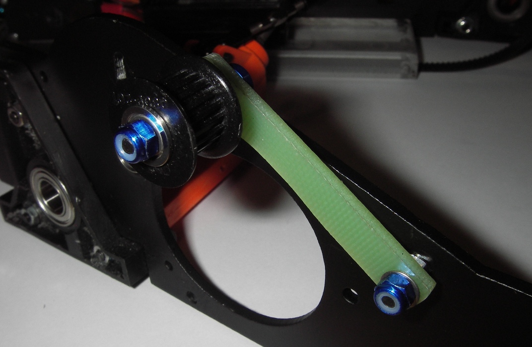

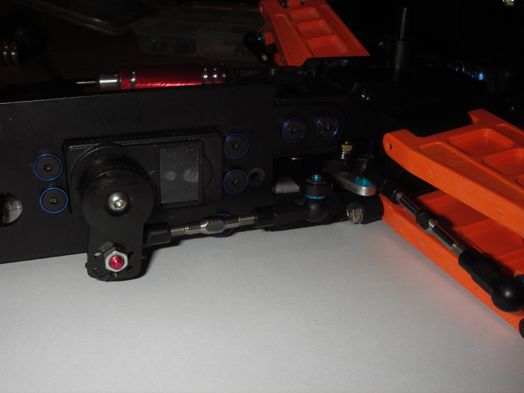

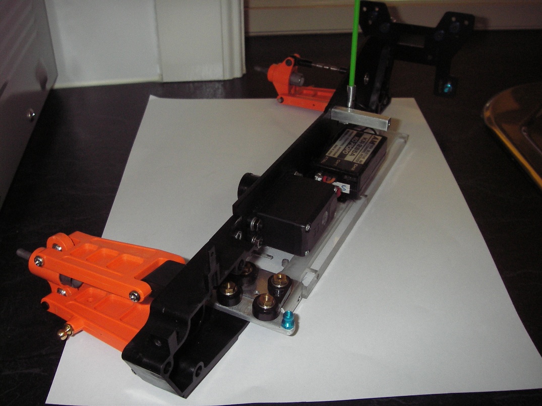

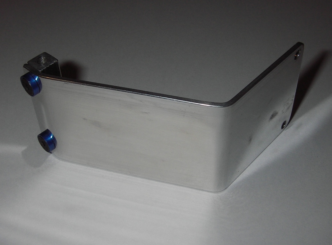

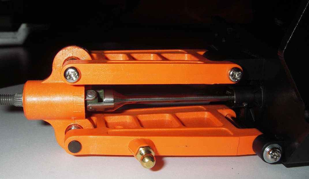

Re: AYK BOOST BUILD
Hello all, got some more pictures of the build, there’s a close up of the steering set up, I’ve also had to make a rear bumper as I could not find an original, I’ve also made a belt tension , and I couldn't find the original dog bones and you wouldn't believe my luck that I found the Avante cv joints fit perfectly and I can run standard hex head wheels now, hope you all enjoy the build so far.
cheers Bullfrog
cheers Bullfrog

Re: AYK BOOST BUILD
Maybe you should make a little skidplate to protect the servo horn when bottoming out?
This is going to be the best Boost ever!

Re: AYK BOOST BUILD
Good suggestion!
Perhaps even better would be to flip the servo saver upwards and run a long ball stud etc....alot less prone to damage that way.
Cheers
Darryn
Cheers
Darryn

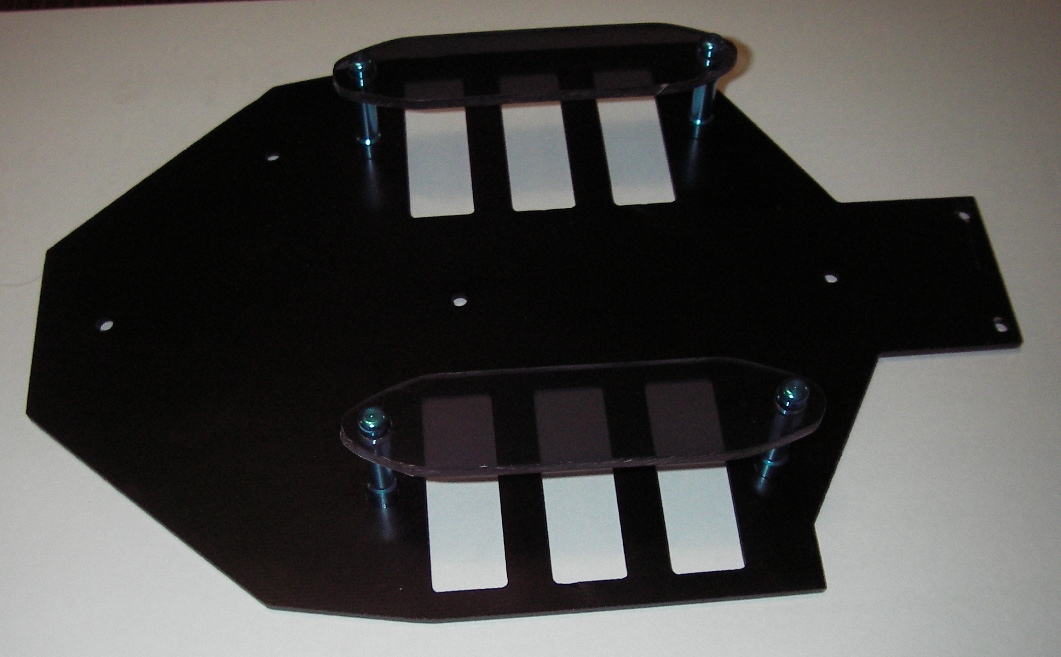

Re: AYK BOOST BUILD
thanks guys for the info, i've got a bottom chassis plate that i'll use, that should protect the servo saver i think, correct me if i'm wrong, I brought 3 racing battery post that i'll use as well, and i made the battery strap from 4mm tint perspex.
more to come
cheers Bullfrog

Re: AYK BOOST BUILD
That should be good
the perspex... I'm a bit worried about brittleness to be honest. Usually the baterry paltes push on the batteries which means the plates are allready in a stressed state.
