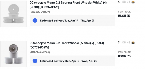

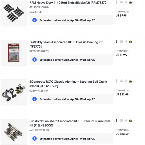

ok, so I ordered a few things tonight. Still need to get some body mounts (not a biggie) and a wing wire and buttons.
Posts: 3536
Has thanked: 269 times
Been thanked: 2094 times
Re: Basement find
You should have asked first. Those rear wheels are for 3/16" axles, your car has 1/4" axles.

Post by RC4X4 »
juicedcoupe wrote: Thu Apr 14, 2022 10:18 pm You should have asked first. Those rear wheels are for 3/16" axles, your car has 1/4" axles.
Wonder if I can drill them? Bummer😒

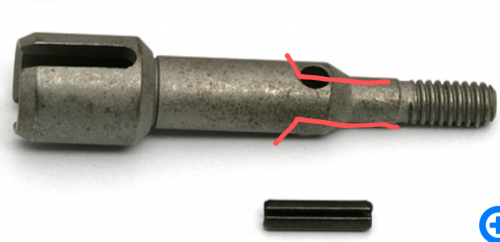

Re: Basement find
Not sure how much success you'll have trying to drill the 1/4" axle taper. Getting off center could make for a really wobbly wheel.

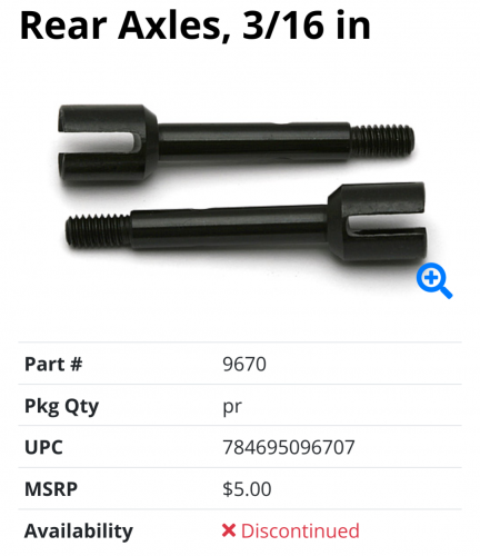

Your rear wheel options probably are:
1. Get 3/16" rear stub axles and flanged bearings. Axles aren't readily available.
2. Get Custom Works Short CVD kit and again 3/16" flanged bearings. Right now most places appear to be out of stock on the Short CVD kit
3. Get 12mm hex adapters and hex rear wheels
4. Get 1/4" rear wheels. Need to consider the rim size preferred (1.6", 1.9", 2", 2.2")
5. Get additional tires for your original wheels

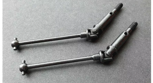

Is the worlds rc10 the same as mine as far as cvds go?
Posts: 3809
Has thanked: 2605 times
Been thanked: 2978 times

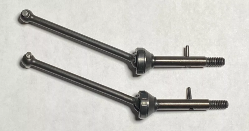

Re: Basement find
RC4X4 wrote: Fri Apr 15, 2022 7:45 am Is the worlds rc10 the same as mine as far as cvds go?
Looking at online build manuals, that's a maybe. Some versions show 1/4" axles, some show 3/16" axles. There are also universal joint axle assemblies that are all seem to be 1/4" axle (2nd photo).

Re: Basement find
If you had a metal lathe or know someone with one, the 1/4" axles could be trimmed a little so they accept 3/16" wheels and still use the 1/4" bearings.

Re: Basement find
Post by RC4X4 »
Frankentruck wrote: Fri Apr 15, 2022 10:58 am If you had a metal lathe or know someone with one, the 1/4" axles could be trimmed a little so they accept 3/16" wheels and still use the 1/4" bearings.
I will do this on my lathe thx for the idea!

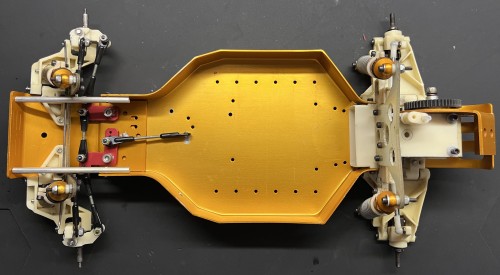

Post by RC4X4 »
Did a quick clean up, just to see whats under the grime. It will make a really nice runner!

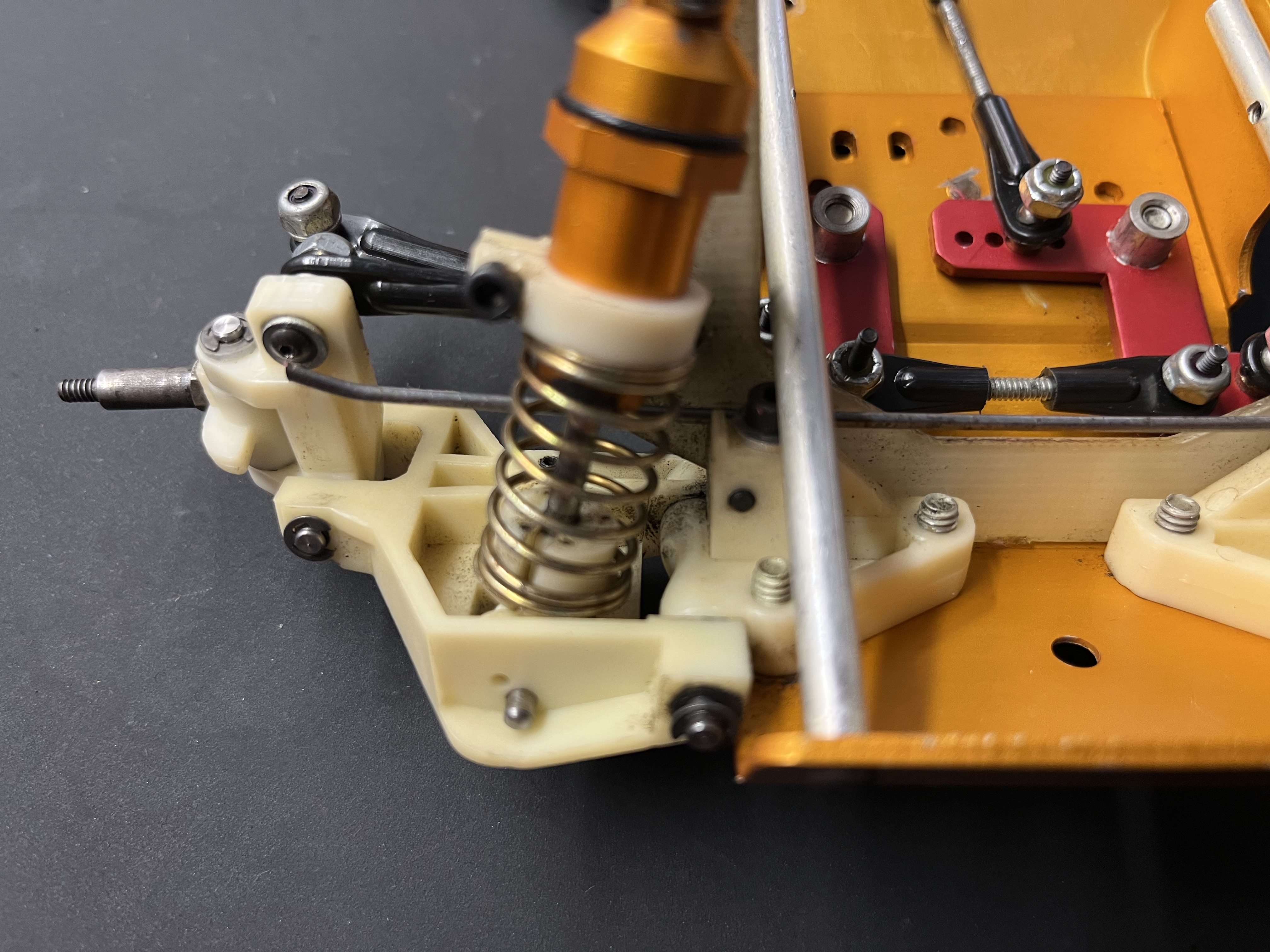

Re: Basement find
Post by RC4X4 »
Does anyone know who made this suspension limiter?

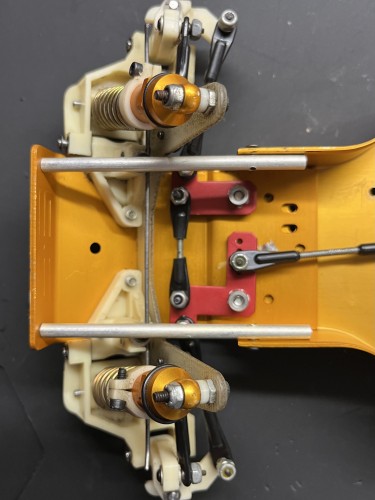

Post by RC4X4 »
a few pics of the first cleaning

Re: Basement find
It did clean up nicely.
That looks like a straight wire was being used in place of the front sway bar, which would have had ball cup connections to the front arms.
