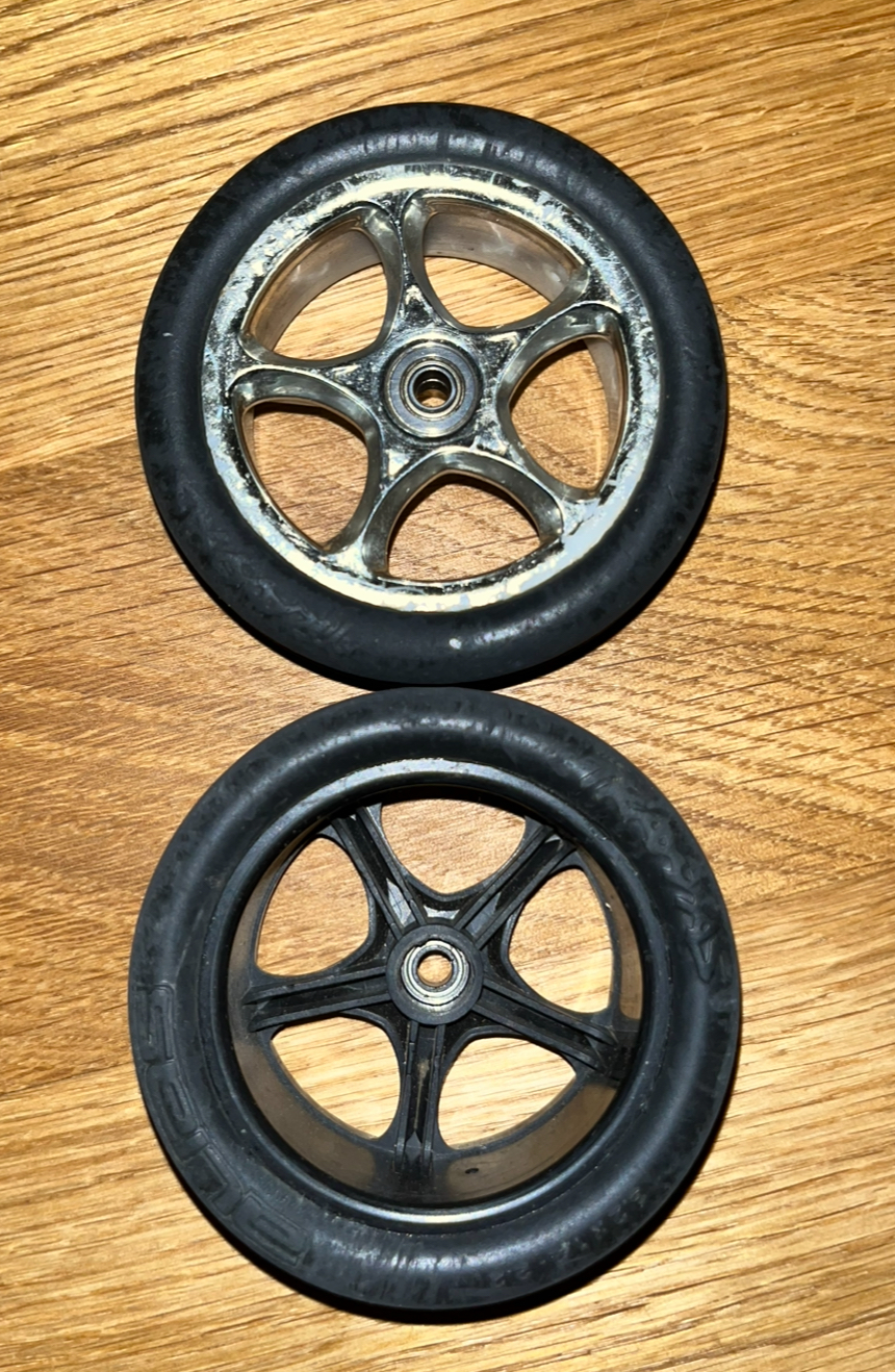

[quote=Frankentruck post_id=561289 time=1706820133 user_id=14233]
Kermit is pretty well cleaned up, but now I need to figure out what to do for front wheels.
The rears here are Bandit 2474 pin drive wheels, but the matching Bandit 2475 are also a pin drive wheel. I would prefer the fronts to be the old fashioned bearing in wheel setup. Any thoughts what I might use?
[/quote]
JC Racing 5-spokes for Traxxas (2.2")
TRA 2671 (dished 2.1")
TRA 1775-X (2.1")
I'm not sure what the original Bandit bearing-in-wheel part number is..but they might be out there somewhere. And I've always thought that some Tamiya wheels might fit but have never confirmed.

TRX-1-3 wrote: Thu Feb 01, 2024 5:54 pm
TRA 1775-X (2.1")
TRA1775-X
I can confirm that Tamiya biw rims will work just fine, also Kyosho rims (not sure about the offset) and HPI Super Stars if you can find them.

Frankentruck wrote: Thu Feb 01, 2024 3:42 pm Kermit is pretty well cleaned up, but now I need to figure out what to do for front wheels.
If you have a drill press and a step drill with 1mm steps, you could take the current bandit wheels and drill the current 5mm hole out to 10mm - don’t go up to 11mm, there’s not enough material for that. You’ll get a nice snug bearing fit, if you drill the last step with a10mm (better 0.3932 inch = 9.978mm reamer) Add two 5x10x4mm FLANGED bearings and presto you’re all set.

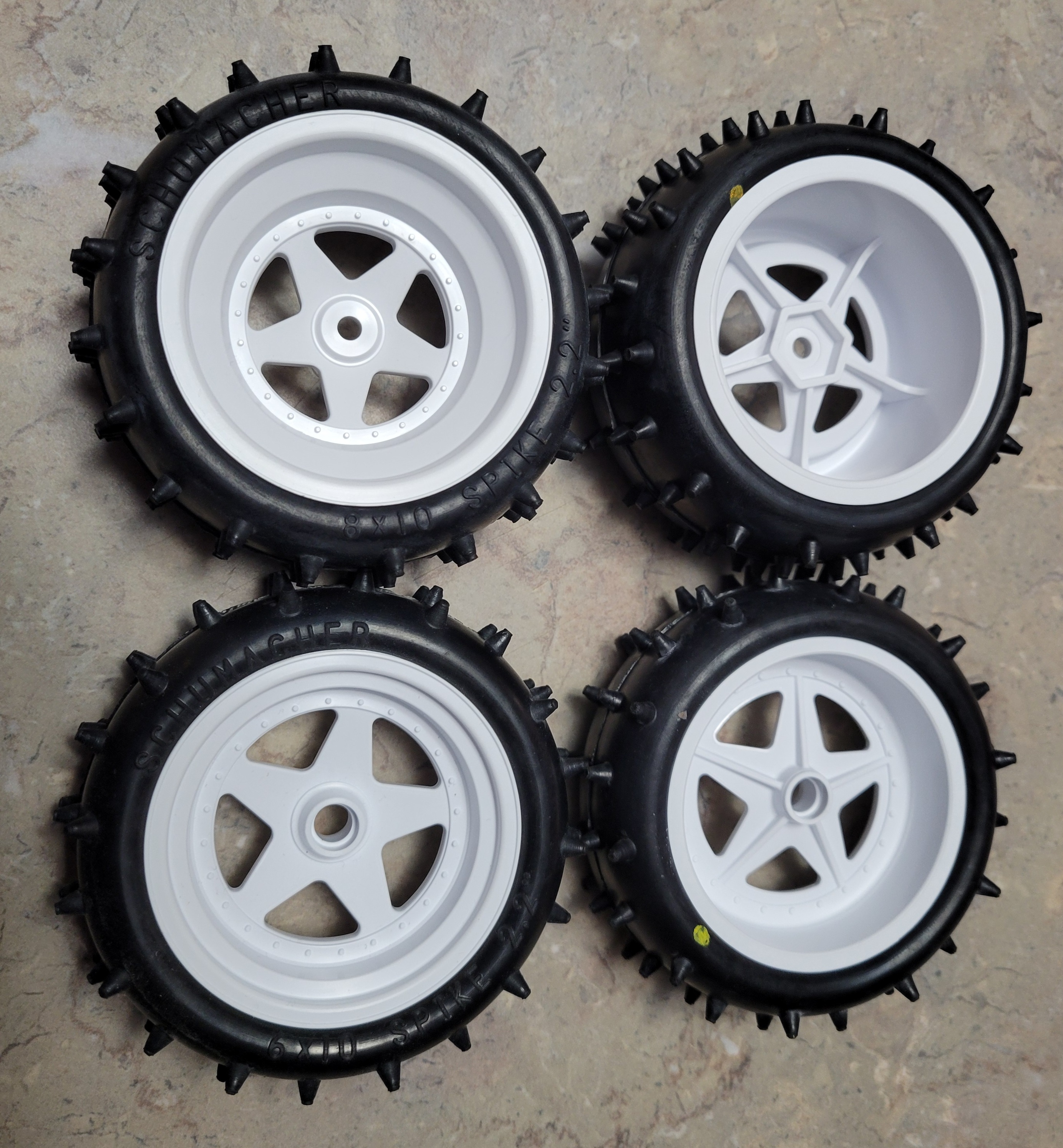

These are Kyosho Turbo Scorpion (re-re) wheels.
The rears are 12mm hex.
The fronts use an 8mm (or 5/16") OD bearing.

juicedcoupe wrote: Mon Dec 09, 2024 2:27 am These are Kyosho Turbo Scorpion wheels.
:shock: Ok, I stand corrected, I would have sworn, that Kyoshos are also metric, either 10 or 11mm OD.
Sorry if I mislead anyone.

Chewbacca wrote: Mon Dec 09, 2024 2:38 am :shock: Ok, I stand corrected, I would have sworn, that Kyoshos are also metric, either 10 or 11mm OD.
Some might be, especially newer models.
My post was simply showing those particular wheels as a possible option, not calling anyone out.

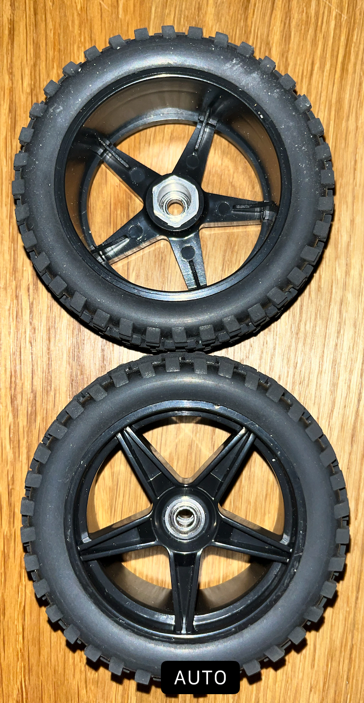

I’ve also converted front hex wheels. For those you have to add a 12mm hex with the according hole. Again 10mm in my case, but have also done 3/8 for a Losi Jrx Pro SE. For that conversion I used 12mm hex bar stock, and a lathe. But you could just drill out some non clamping hex adapters from Ali Express for example.
