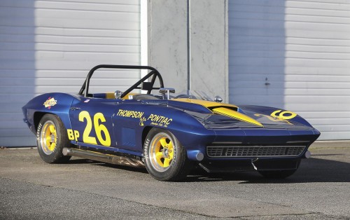

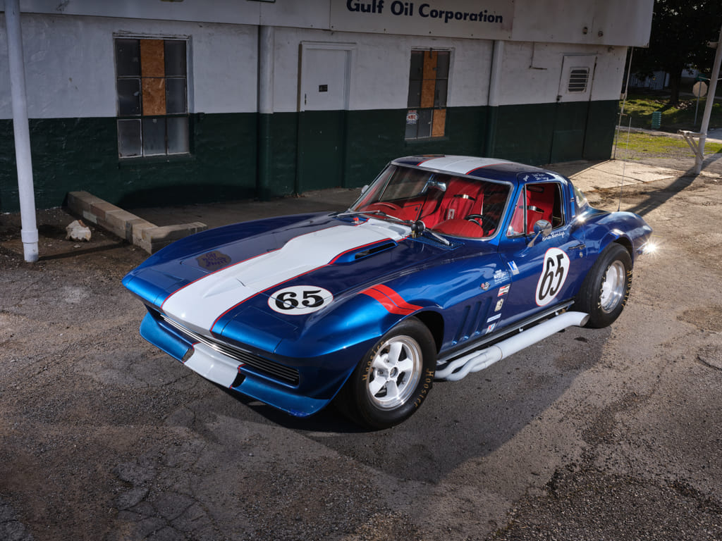

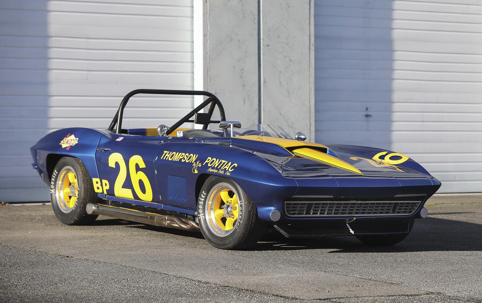

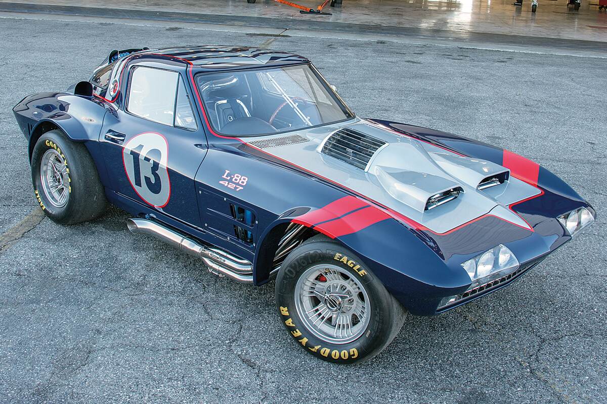

Car is looking good. Might not be the Nassau blue you intended, but it's just about bang on for Admiral blue. Very pretty as is.
Depending on how far you want to go there are a few options...
If you just want the stinger in white, Hobby Lobby sells single 8.5x11 vinyl sheets for $1.50/sheet. They're thin like a decal and you could use one of the original stingers as a guide to cut new ones...
Maybe even in yellow, for a Sunoco look...
Or go a step further. Duplicolor and Plasti-dip both make peelable paints in white, silver and every other color. Could mask off and spray the outside of the hoods, etc. add decals and get something like...
Or more gnarly colored...
And if you tire of it, you can just peel the paint off like a decal and start over.
Many possibilities...

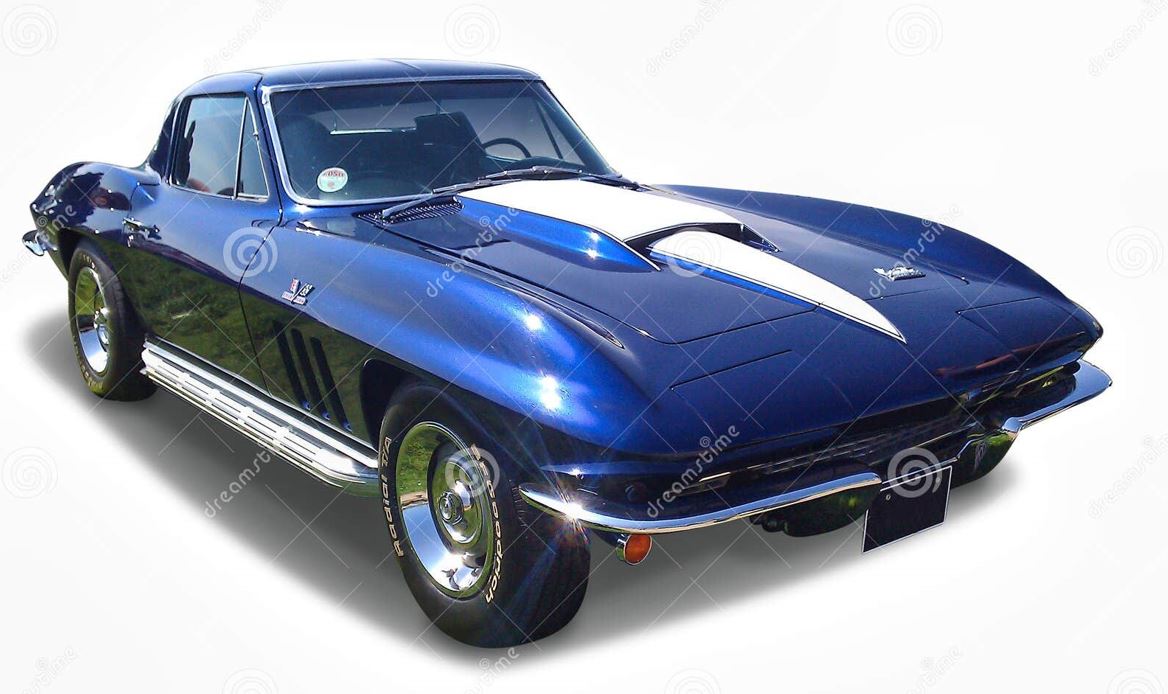

Much thanks, @Dangeruss! It does look like Admiral Blue! Those are some sweet racing decal choices you listed. I was hoping to go scale look with magnetic body mounts, and stay era correct with matching the '67 I was trying to tribute, but this may already be beyond the scope.
'67 C2 Corvette was the one-year only color of 976 Marina Blue Metallic, really wanted that one, but should've set my expectations accordingly, and to more than just the PS-16 Tamiya sample.
https://tech.corvettecentral.com/2022/03/1963-1967-c2-corvette-factory-paint-colors/
This '67 Marina Blue looks decent with the black decal.
Going to go with the black decal and leave the paint the way it is, if it's not serendipitous, perhaps it will still grow on me.
