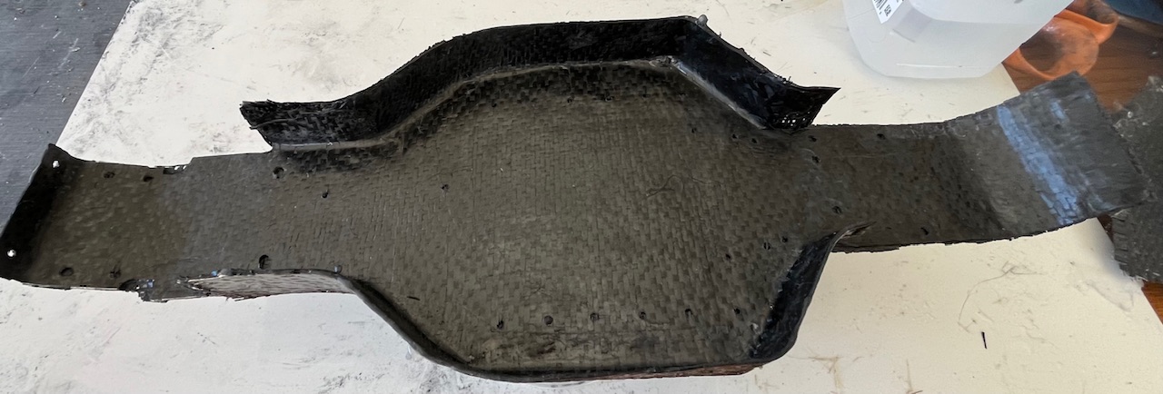

Great test results.
Learned a few things as well it is going to be a useful result.

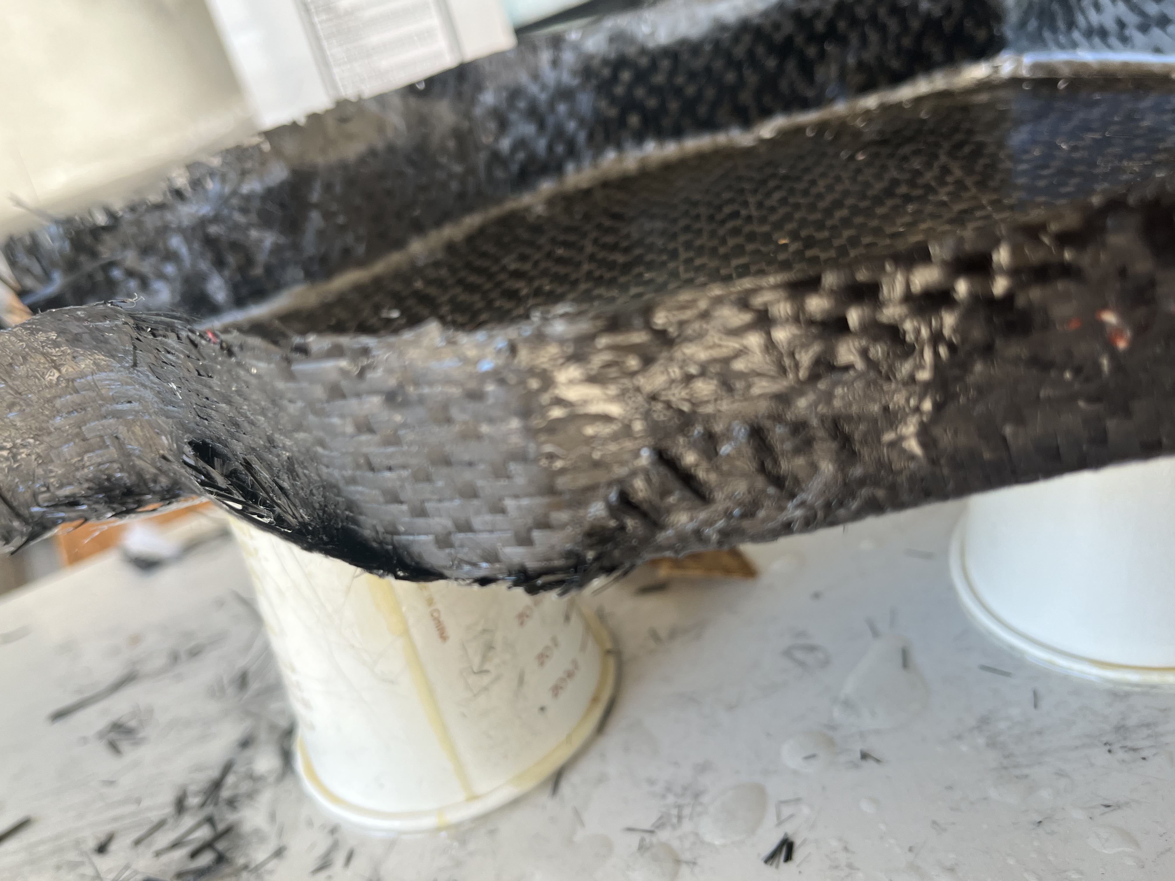

The chassis was resin light. The vacuum held, but the resin from the top did not diffuse to the outside layers.
The cosmetic effect of the 3 piece wasn’t great. There were lots of orphan strands of carbon fiber.
This may be helped with more resin, maybe not.

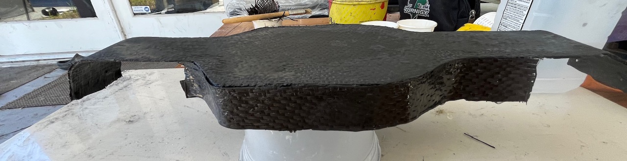

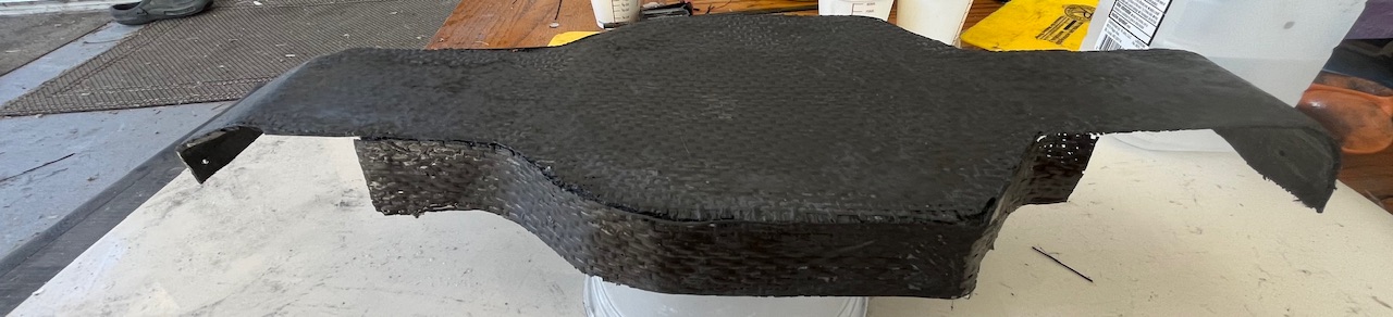

The carbon fiber is a directional weave. I mean for the bottom to have the major weave be along the chassis and it was across.
The shape Is good geometry is good. The walls are tall enough
The corners are pretty crisp inside and out
The nose plate accidentally has the proper angle that allows for the bumper and a body to be mounted.
Very few wrinkles That may be because of the lack of resin, the breather in multiple layers reduces the problems in bagging,

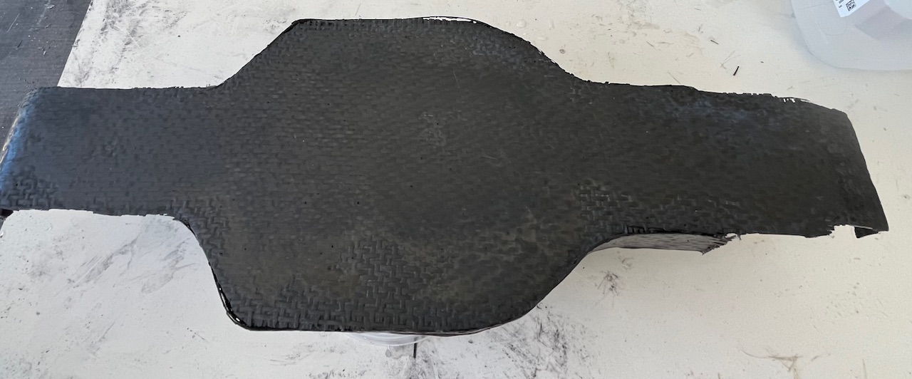

This is rigid and impossibly light.
Cosmetically it’s going to need a few hours of clean up but it should be just fine for my oldest who wants to make his rc10t as a model and not a running car.
I’m not sure if it’s the switch in resin, design or better technique.
I think I may trim in some cut down sides for this and add a layer of cosmetic material along the side to clean up the rough spots.
The bottom will need another coat of resin and sanding for appearances.
For the next on that is going to be a basher for a younger kid. I am going to add 1 or 2 more stiffeners and make the internal layers of fiberglass.

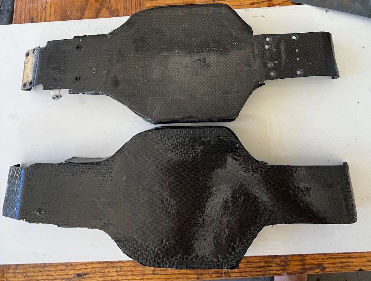

Here is the chassis with the sides and bottom cleaned up. Could have used bagging to get the sides a perfect fit.
Added the sides with the carbon fiber running the long direction. I’d been making these far to dry so I coated with a layer of resin. I mixed up 24 ml and that was far more than needed for the full bottom and sides.
I sanded things down with 1000 grit to smooth things over and added a layer of 2k clear
Here is the newest attempt vs the last one.
Need to finish it up tonight. I’d been working on these way too long and I need to hand it off to my kid so he can build up his 10t.
