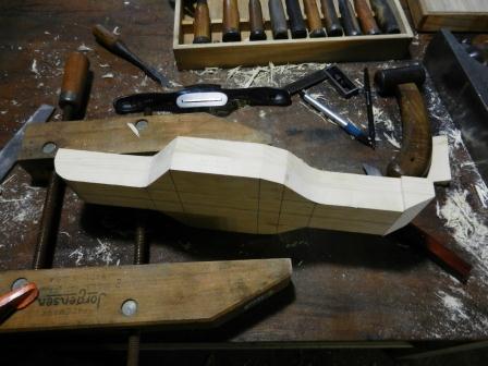

Buck roughed out. I'll need to refine the dimensions and transitions and then fillet were fillets need to be.

Re: Carbon fiber Chassis Experiment
Looks cool even like that. Someone started a thread on their own CF a few years ago, but I don't think they ever successfully completed it though. It was still a very cool thread. I look forward to seeing how this goes.
I had thought about making a positive out of an existing chassis. What I noticed (and this may just be the chassis set I have) is that the aluminum tubs are not very symmetrical.
I only have one new condition black b stamp chassis. And although it was better than the rest of my chassis sets it too was asymmetrical.
Also sides were not straight. I realize this has to do with the stamping processes but since I wanted to give myself the best chance of successes as possible I started from scratch.
It was interesting measuring up the old tubs since you discover that they used a lot of standard dimensions. Like the radius of the back is one inch. The inside depth is 1". The width at the back is 2 1/16". A bunch more dimensions like that.
Very interested in seeing this unfold, The buck looks good!...........in fact, it gave me a inspiration to create an RC10 made out of wood.....for show only
