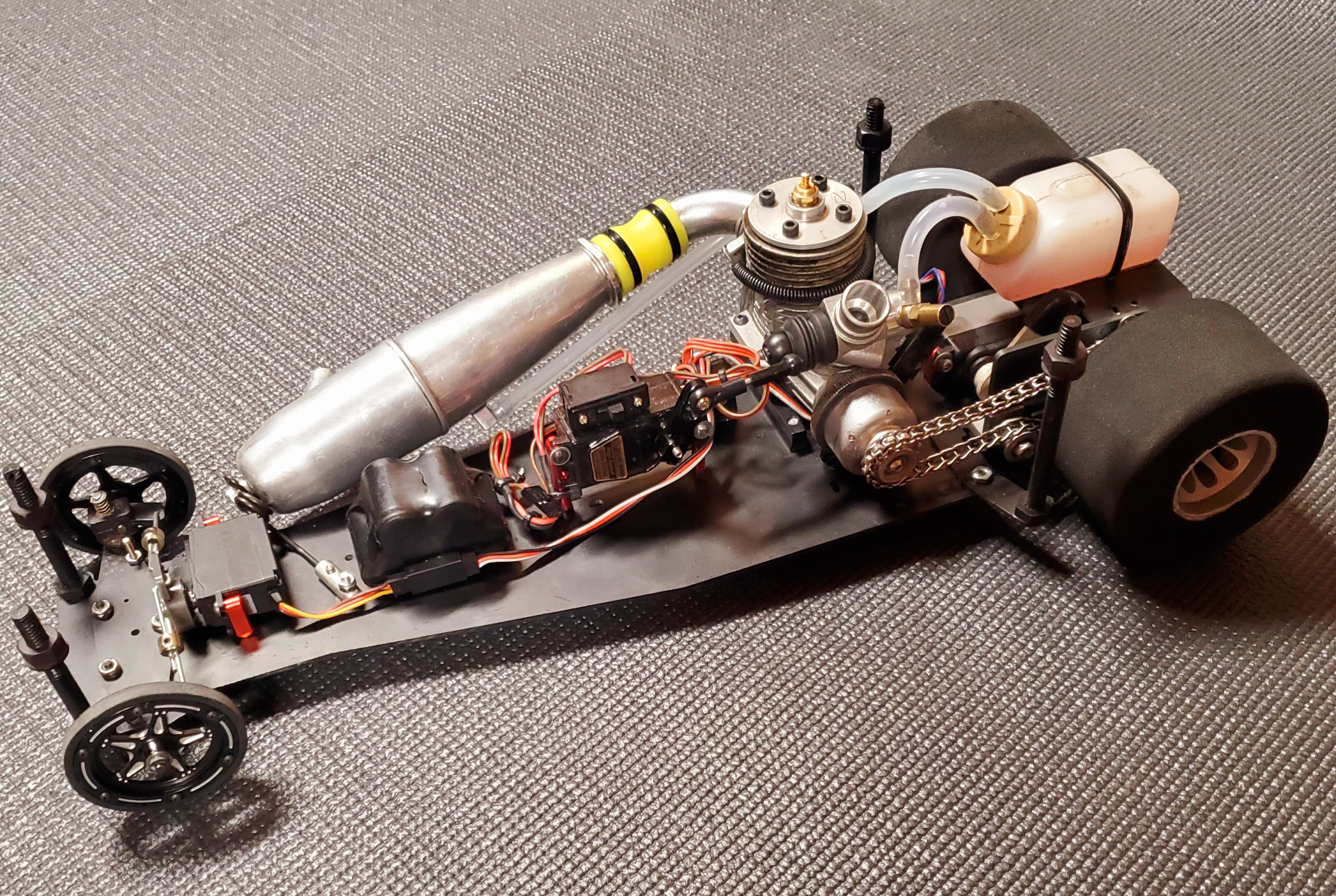

Phin wrote: Wed Oct 23, 2024 7:51 pm Or you could ditch the DD and use a combo of gears and sprocket on a jack shaft. Either engine sprocket to spur sprocket to pinion gear to spur gear on wheel/axle....or the more common engine pinion to spur gear to pinion sprocket to spur sprocket on wheel/axle.
Your idea of flipping the chassis over is it...half way there, working out fine (except exhaust header mods)...it has to have a chain drive, that's the whole point of the build!

Got it fixed...test drove it too...gonna do a new body, pipe fits inside the body now

Blew the clutch bell apart today...but early indications are huge speed...never got above 10% throttle...Thumbs has vid....will get it printed in metal and retest

:lol: :lol: on a plastic printed clutch bell ! Top marks :lol: I'll see if I can complete the parts list next weekend , had to work Saturday so not much progress this weekend , then you can get that metal clutch bell printed.

Got the metal clutchbell designed by Dadio on...it fixed the clutch issue...drives great...will make a few speed runs at next Fest
