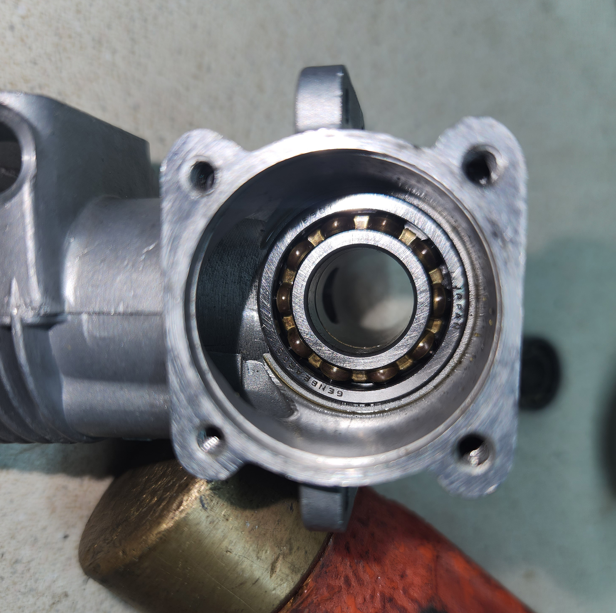

And down to the last piece; the inner bearing. Can't grab it on the outside, can't grab it on the inside. Heat?

Re: RC150 Nitro Engine Help
I use a heat gun, and slam it on a piece of wood a couple times. They rarely come out easily
Post by morrisey0 »
GoMachV wrote: Sat Sep 21, 2024 11:31 am I use a heat gun, and slam it on a piece of wood a couple times. They rarely come out easily
Worked like a champ! :D
