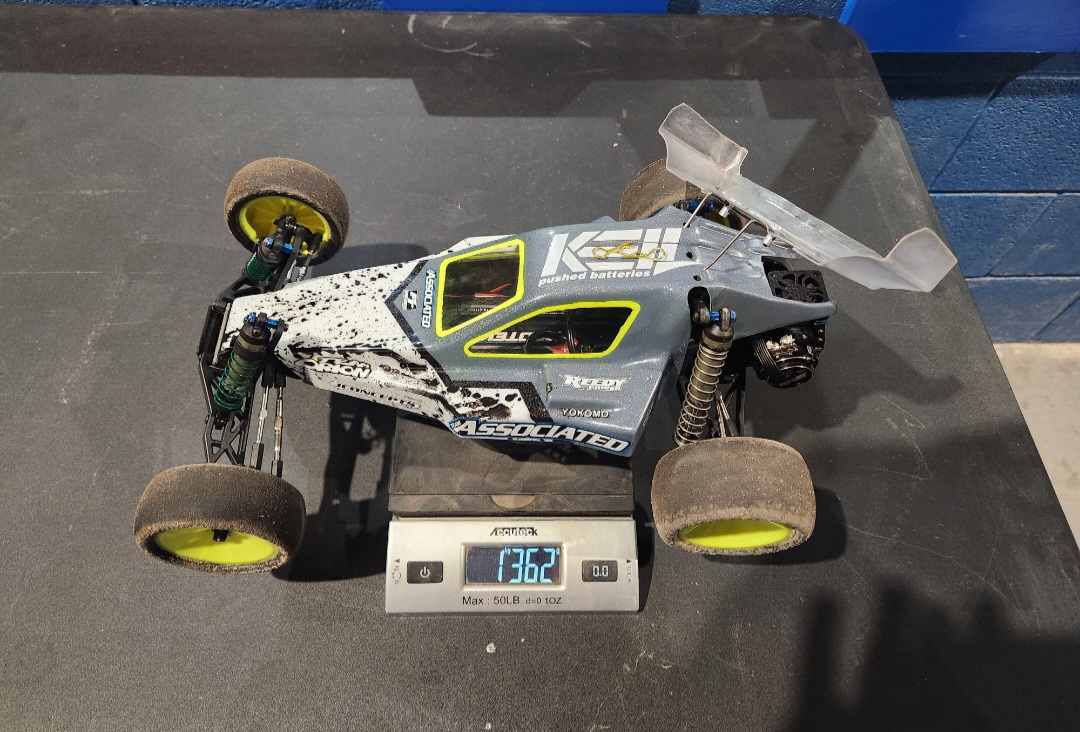

Little delayed. The B2 was way smoother on track than my RC10 by far. The 10 is a framing nail gun, the B2 is a high end 31.7oz 16 inch balanced framing hammer.
The B2 was initially twitchy and lacked off center on power grip. Weighing it yielded 1362g which we 4oz to light *explains why all the B2's were motoring all.of us last year*
Added the 4 oz where I saw fit, raised the FDR, went to 32k throttle resolution and used the HW softening value feature and it was better. Looking forward to some race condition track time to get it a little more there. But it should be fine

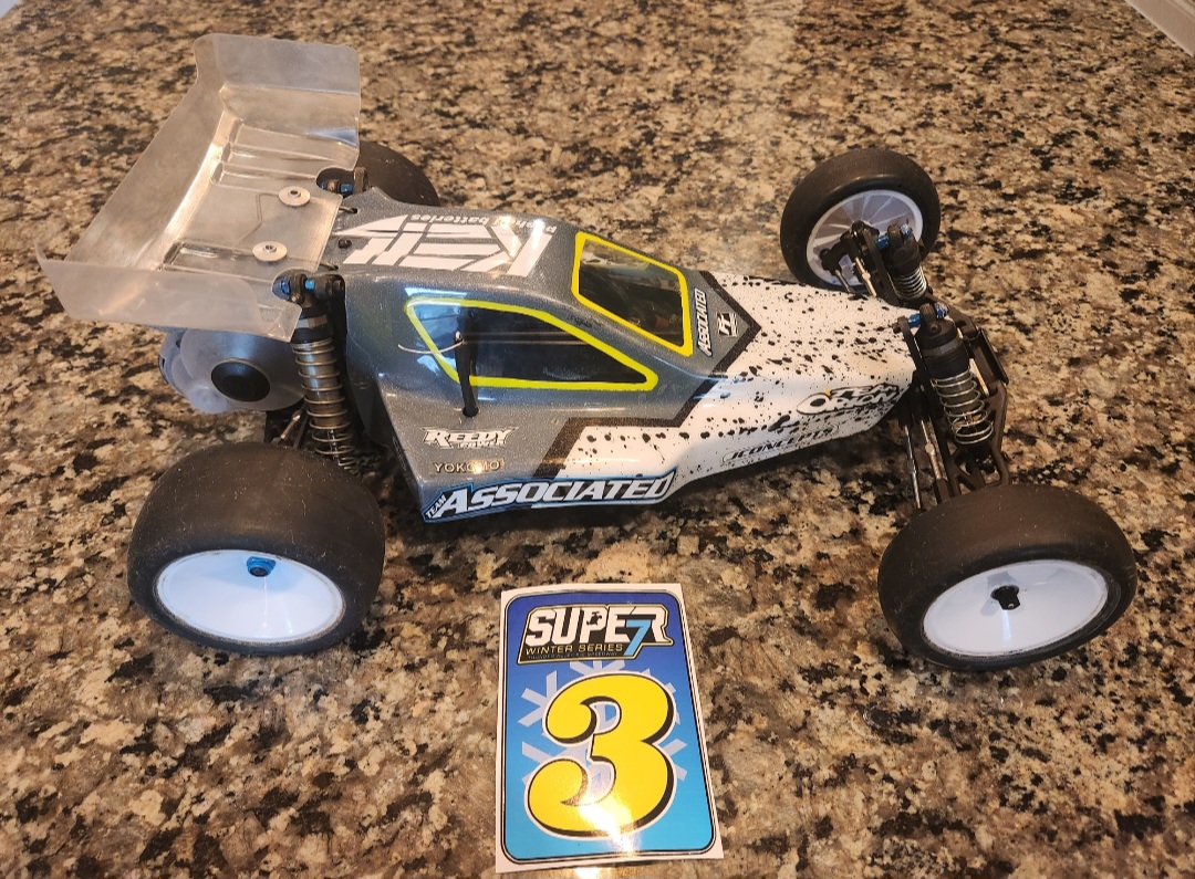

Shook this buggy out yesterday- took 3rd in 17.5 out of 17 entries and held 2nd for a bit. This cars fast lap was 12.9, the two TLR sponsored drivers that finished ahead of me were g we getting 12.3's- so for a 30 year old buggy...that's not bad.

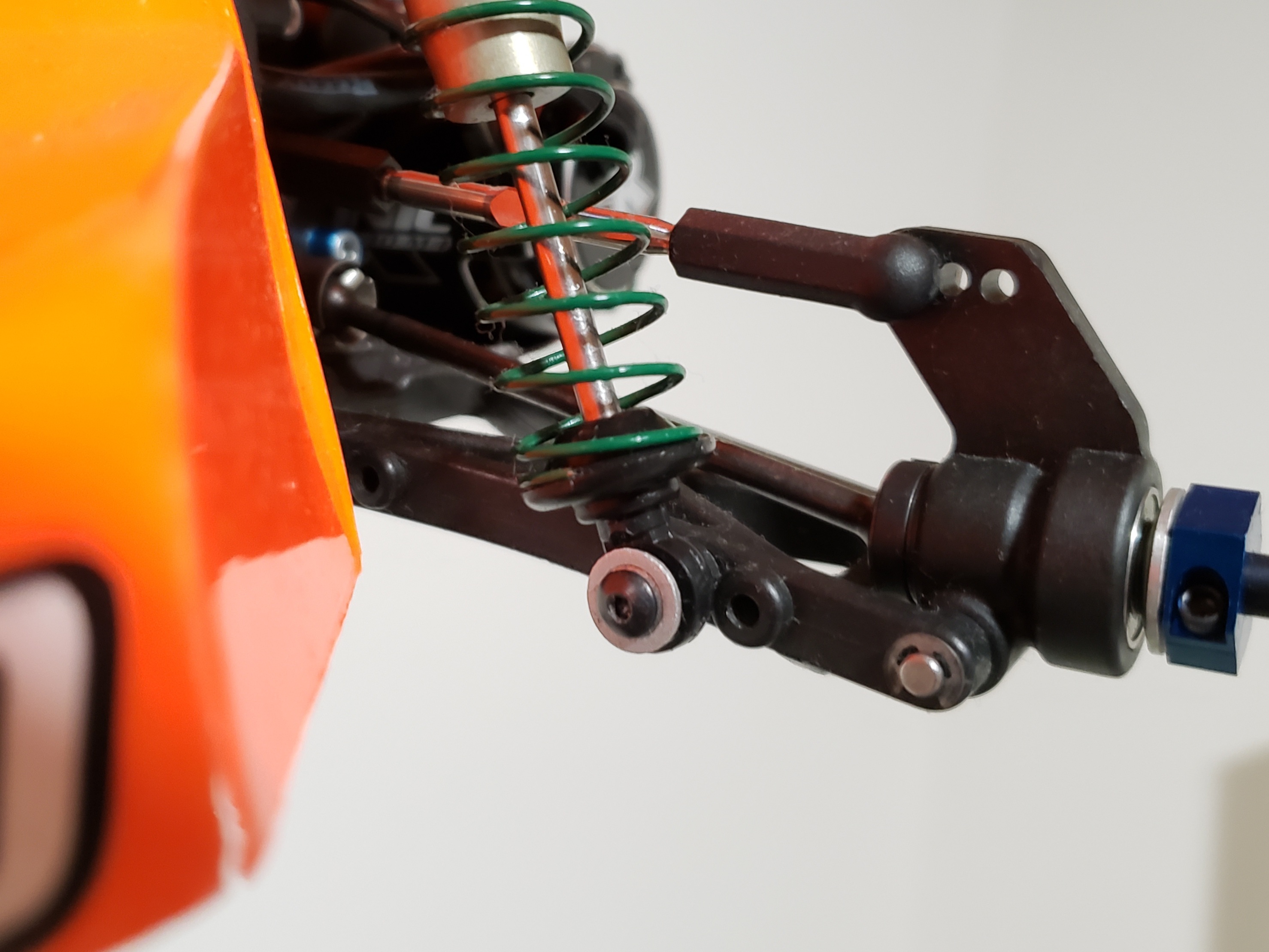

Looks really good in the vid. Did you try the inside hole on the lower rear arm? Dont change the spring or internal limiters, just go up 2.5 or 5wt in oil. The increased droop will help around the slow corners and the decreased shock leverage will make the rear lean a little harder in the fast corners. It will be a little softer overall in the rear but now the rear will kinda follow the front around the turns instead of being so locked in when using the outer hole on the rear arm. Mine has B3 rear arms, but its the same concept with the B2.

I hadn't tried the inside hole, during the track time I changed to middle hole on the rear tower for a little faster corner set, up to silver front springs for a less twitchy feel. It's still way more of a handful to drive than it looks and with my option tire it is way more responsive to steering input....but I was having trouble hitting my marks.
