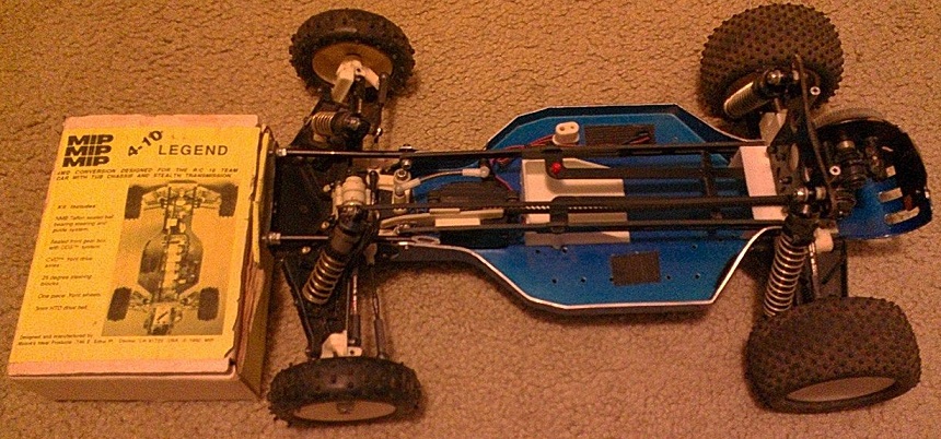

Remember that 4-10 auction on Ebay two weeks ago? Yeah, I'm that guy. I stayed late at work to snipe the auction (all is fair in love and war), which ended in both laughter and tears as I realized what I had done to my wallet. My apologies to any of you if you were bidding on it and lost - I get very competitive with auctions like this.
https://www.youtube.com/watch?v=KGVUl_epkoA
I readily admit that most of the chassis is worn and not so useful for a shelfer. But hey, it's a 4-10, and at least the 4-10 parts are in good enough condition. I plan on doing a complete resto for this, with a few modern twists. There have already been some very nice "vintage" 4-10 projects on here and they are great, and my take is that I don't want to repeat somebody else's work. Nobody has done a WOIN 4-10 as far as I can tell, so guess what? It's on like Donkey Kong.

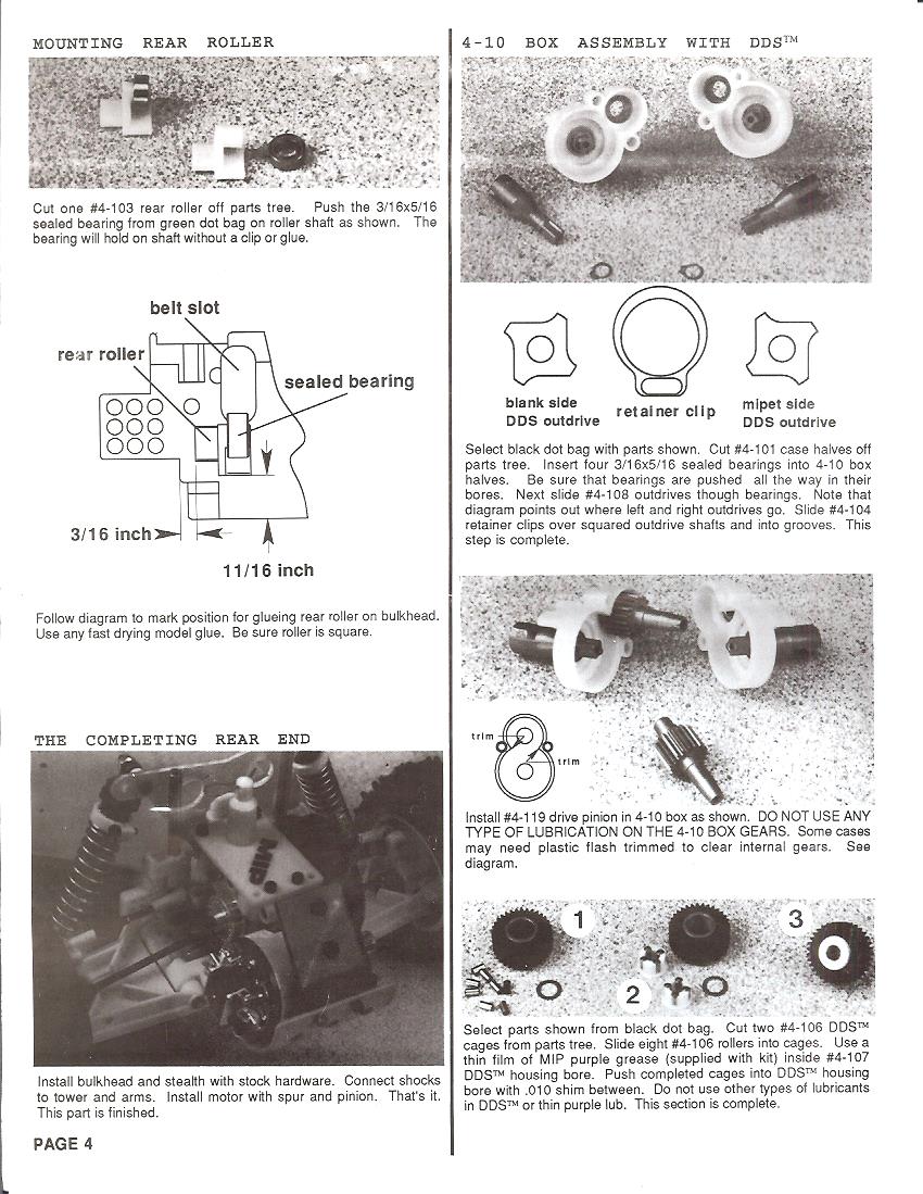

Btw, your missing the rear belt roller. That's why the belt is on the bulkhead. The bottom is the slack side of the belt, and the roller will prop it up
Manual is located here
http://www.rc10talk.com/viewtopic.php?f=82&t=586

This one, I can't remember where I found this page, might have been here some where, I down loaded
the whole set.
I see Gomachv beat me to it.
Cheers, DaveM.
the whole set.
Cheers, DaveM.

Ah, yes. I have that part in the box. Was wondering what that was.
Thanks for the manual, guys. Much appreciated.
