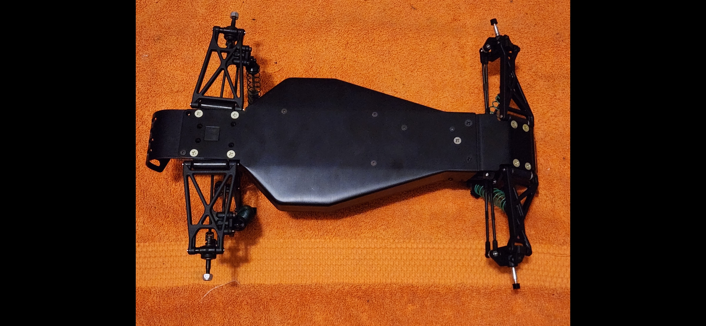

Really clean and mostly NIP parts build from 8 years or so ago...going to be my race truck for the Jan Tamiya World Classic Vintage race here at WORC.
What I'm starting with-

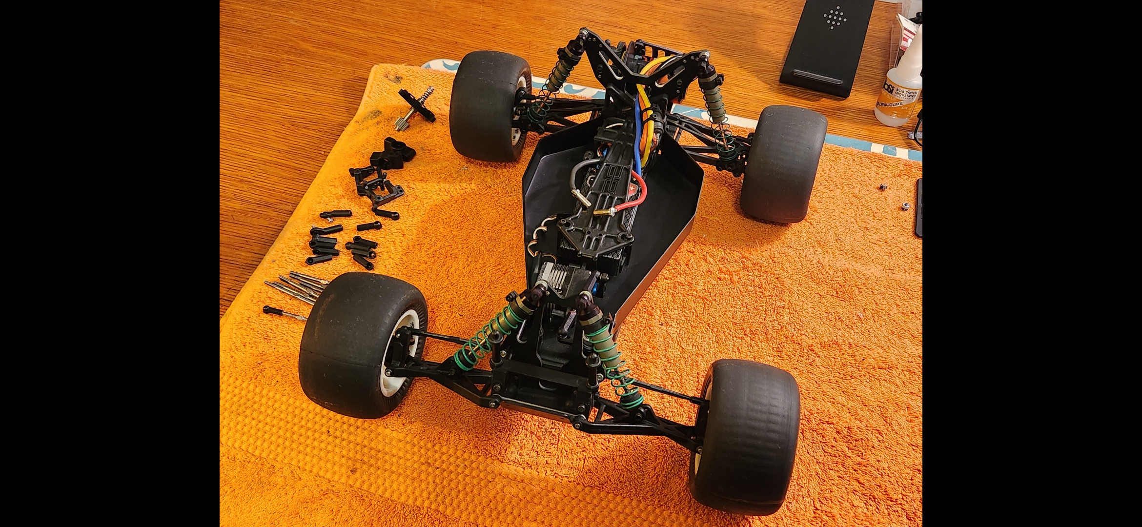

Some minor progress since the rest of the gear is cleaned up from the VONATS

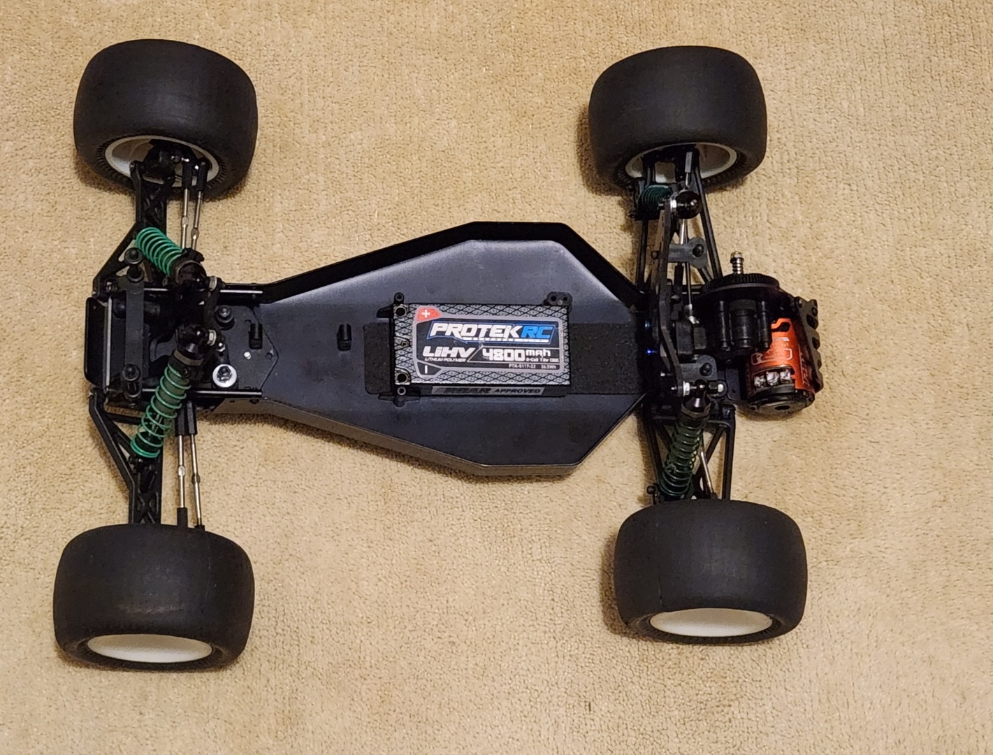

Plan will be to add 13mm T6.4 shocks on it, widen the front end with adjustabiliy options for axle height and width, rear CVD and rear hubs with increased roll center and axle height options, titanium turnbuckles and pins, 3mm ball studs, RC10 worlds or Factory Works steering and new electronics, then sell off the new built stuff like shocks and such to offset the cost a bit. Might paint the OE T2 shell tonight

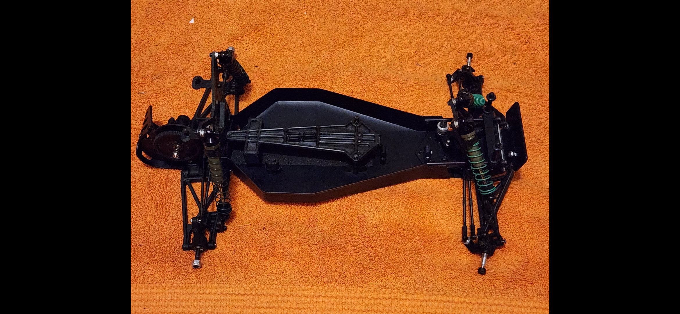

Little more progress. Ti parts on, ballstuds changed geometry updated. The front end was a lot of work to get the bump steer corrected. Kinda surprised me honestly
