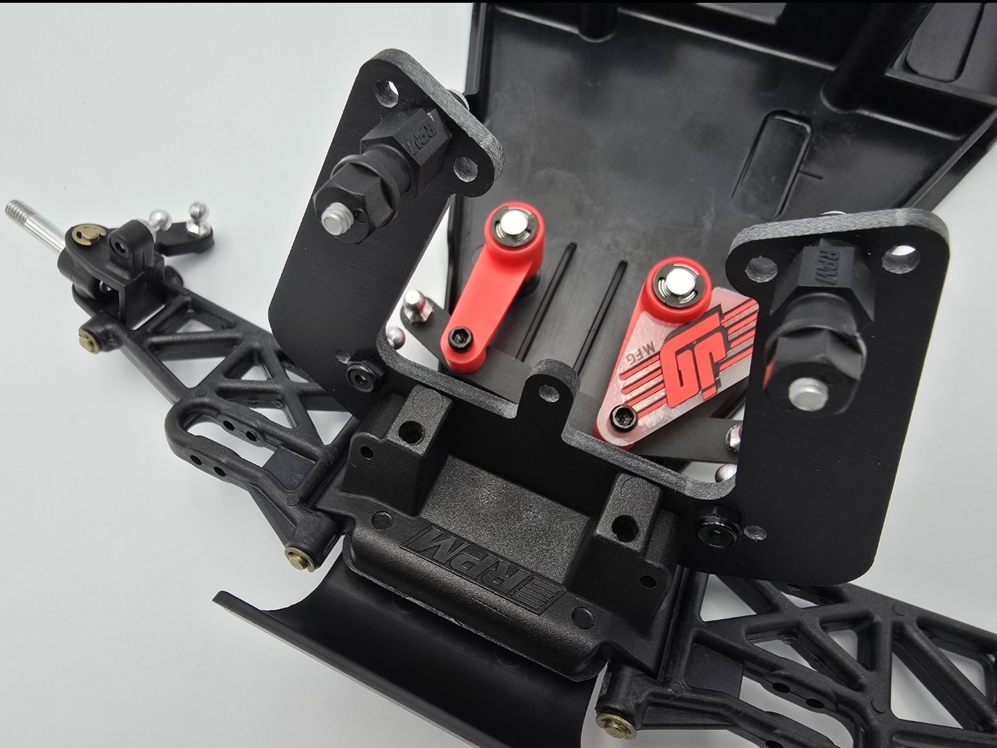

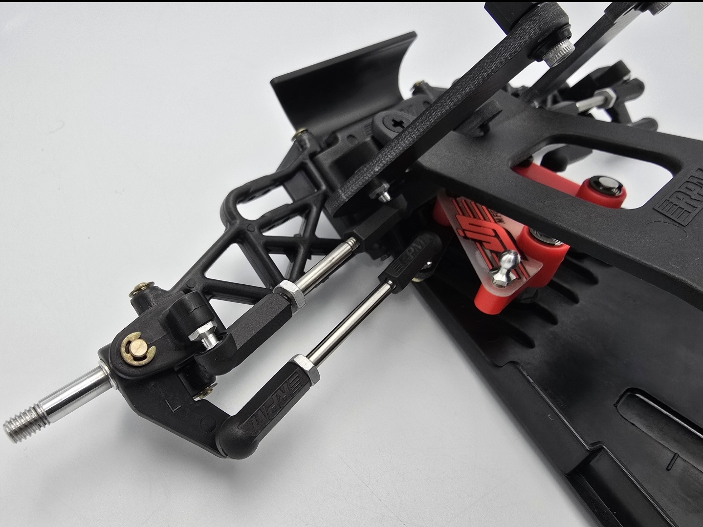

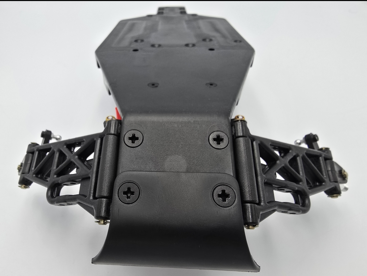

Lavigna wrote: Wed Feb 19, 2025 9:12 pm Steering mounted. Arms built up with Tecnacraft titanium gold hinge pins, gold e-clips, and Trinity aluminum ballstuds.
I didn't know the JG brace fit on the bearing belcranks too.
Lavigna
Posts: 1462
Location: Petaluma, CA
Has thanked: 1099 times
Been thanked: 1418 times
Re: Losi JRX Pro SE build
Post by Lavigna »
It fit like a glove. I was sort of wondering myself.

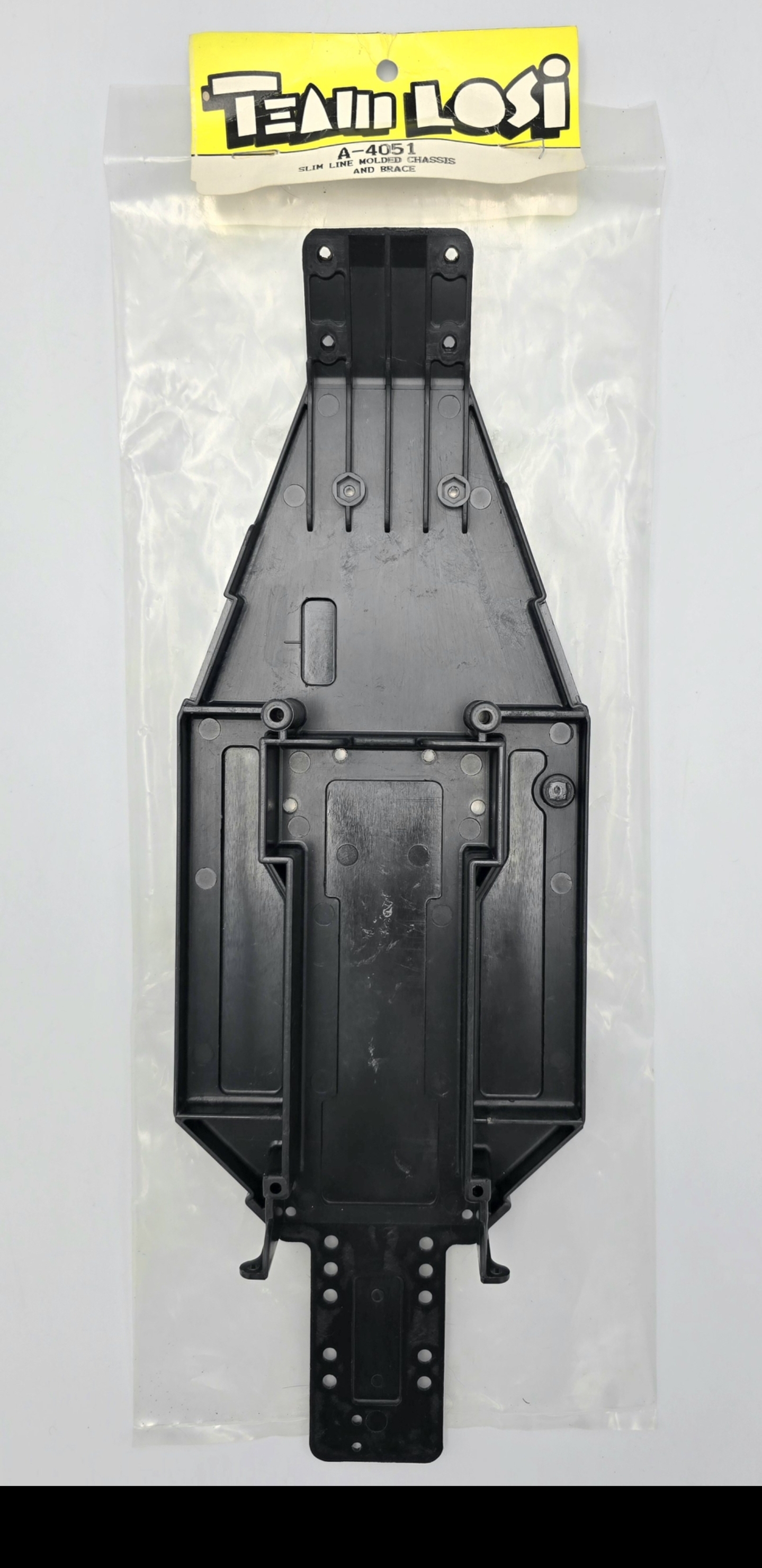

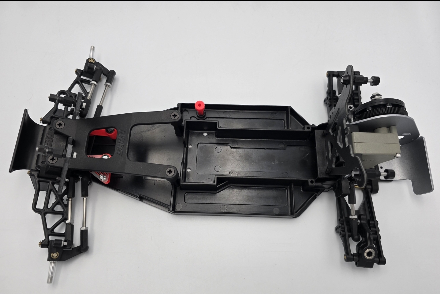

One last shot of a factory fresh chassis, before it gets bolted up.

nice with the titanium shafts and aluminum studs, I was gonna mention them steering cranks came with standard bearings back in the day but fit the flange bearings nicely.

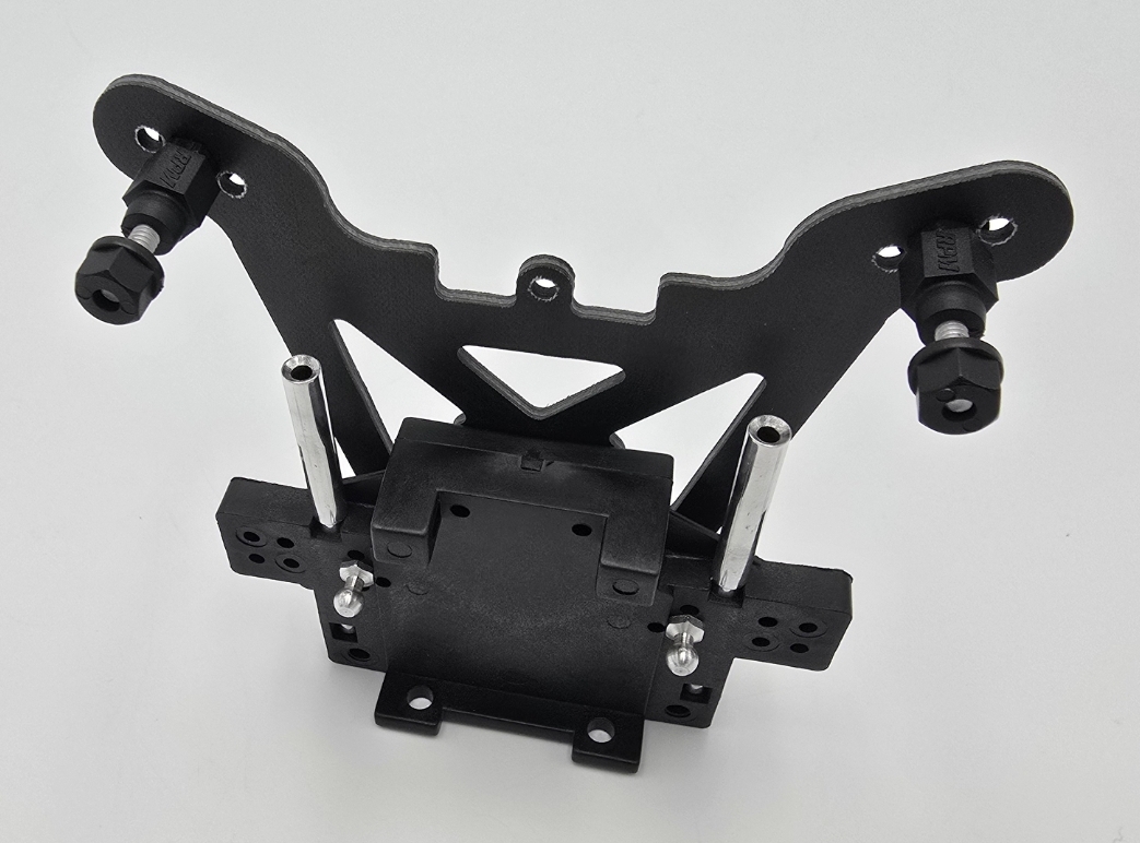

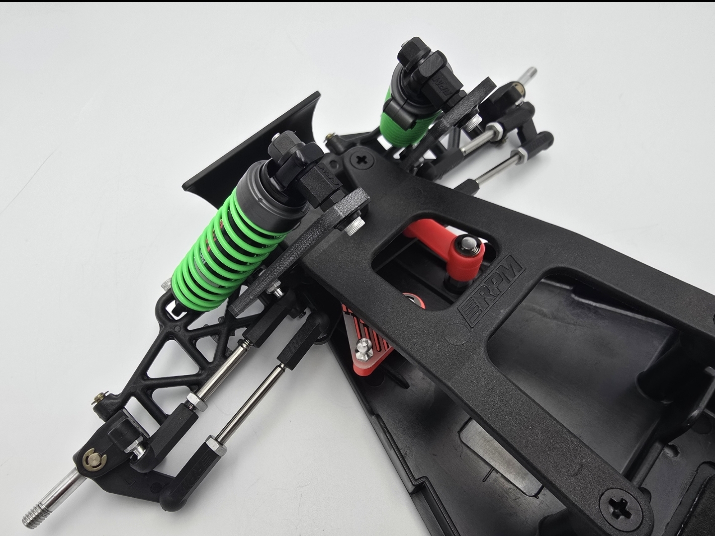

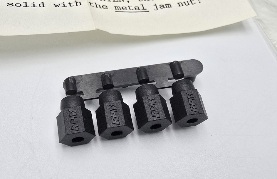

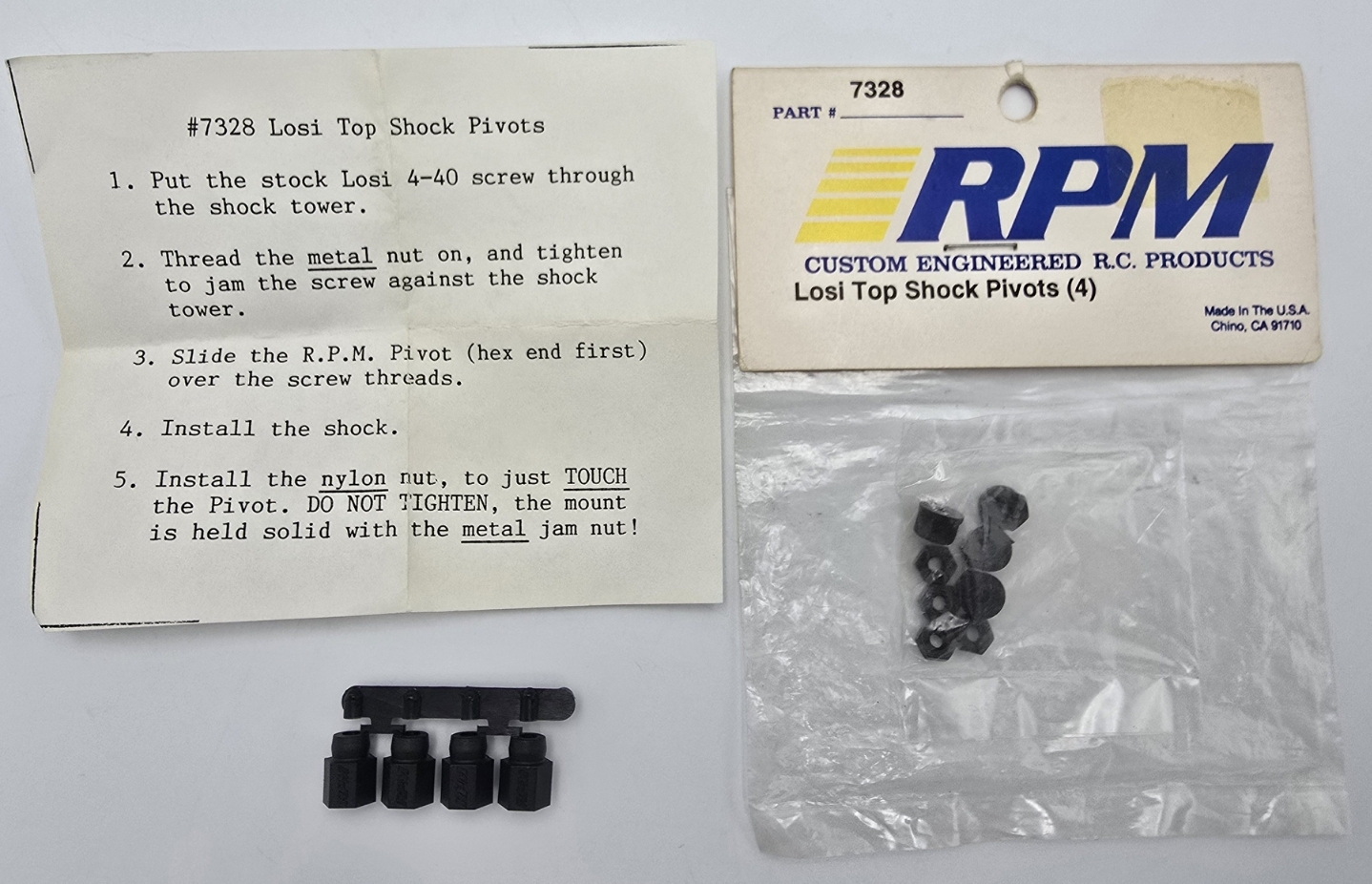

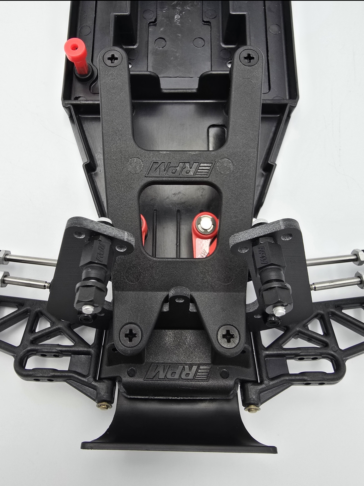

I'm using these rare RPM shock standoff. I've never mounted a set before. I love the small detail of the RPM lettering on them. The Jammin tower is attached to a RPM bulkhead. Aluminum 4-40 and 8-32 hardware used throughout.

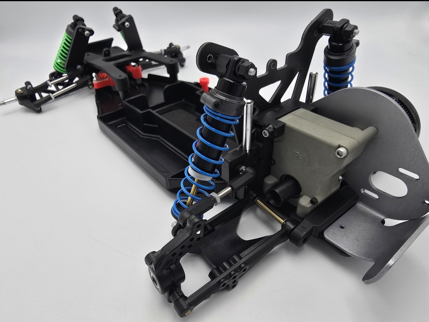

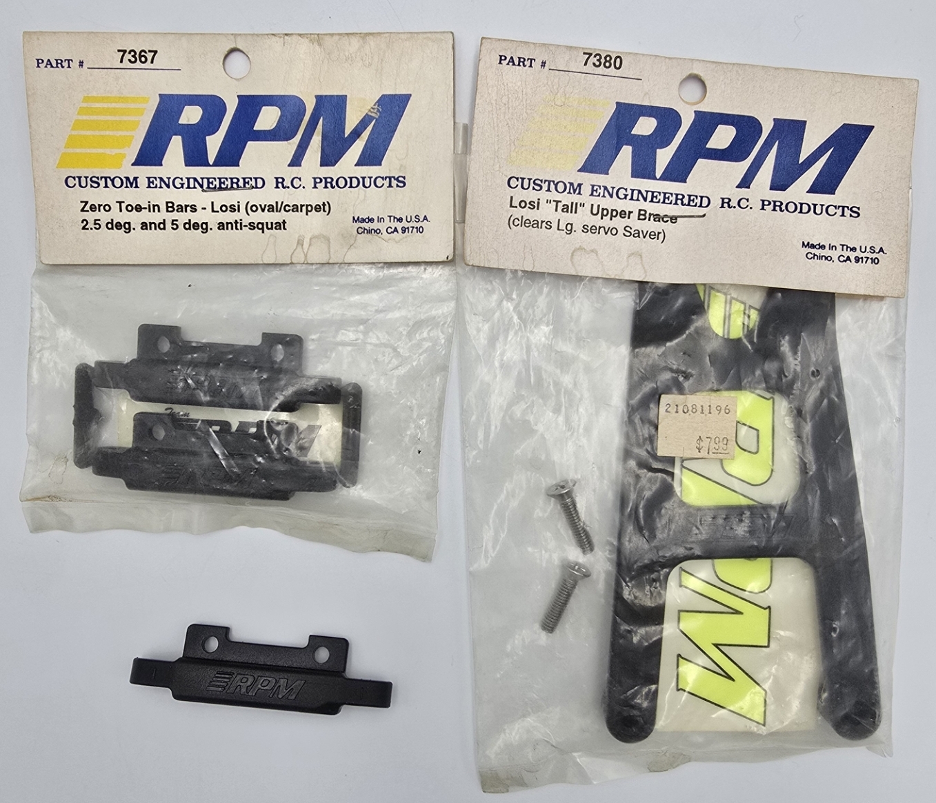

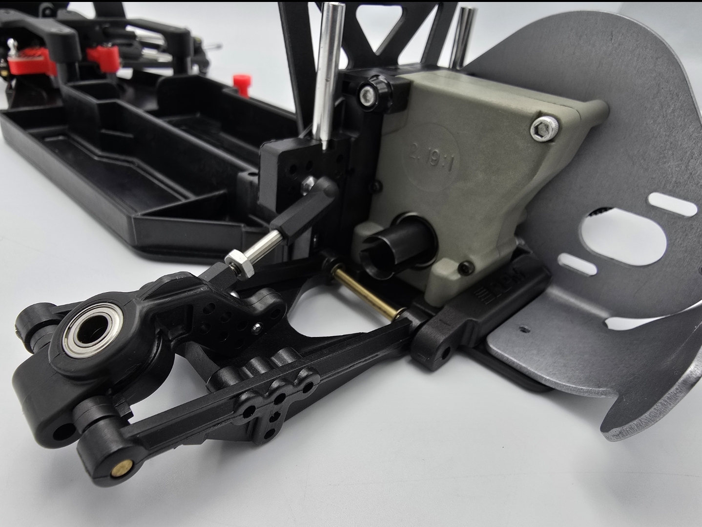

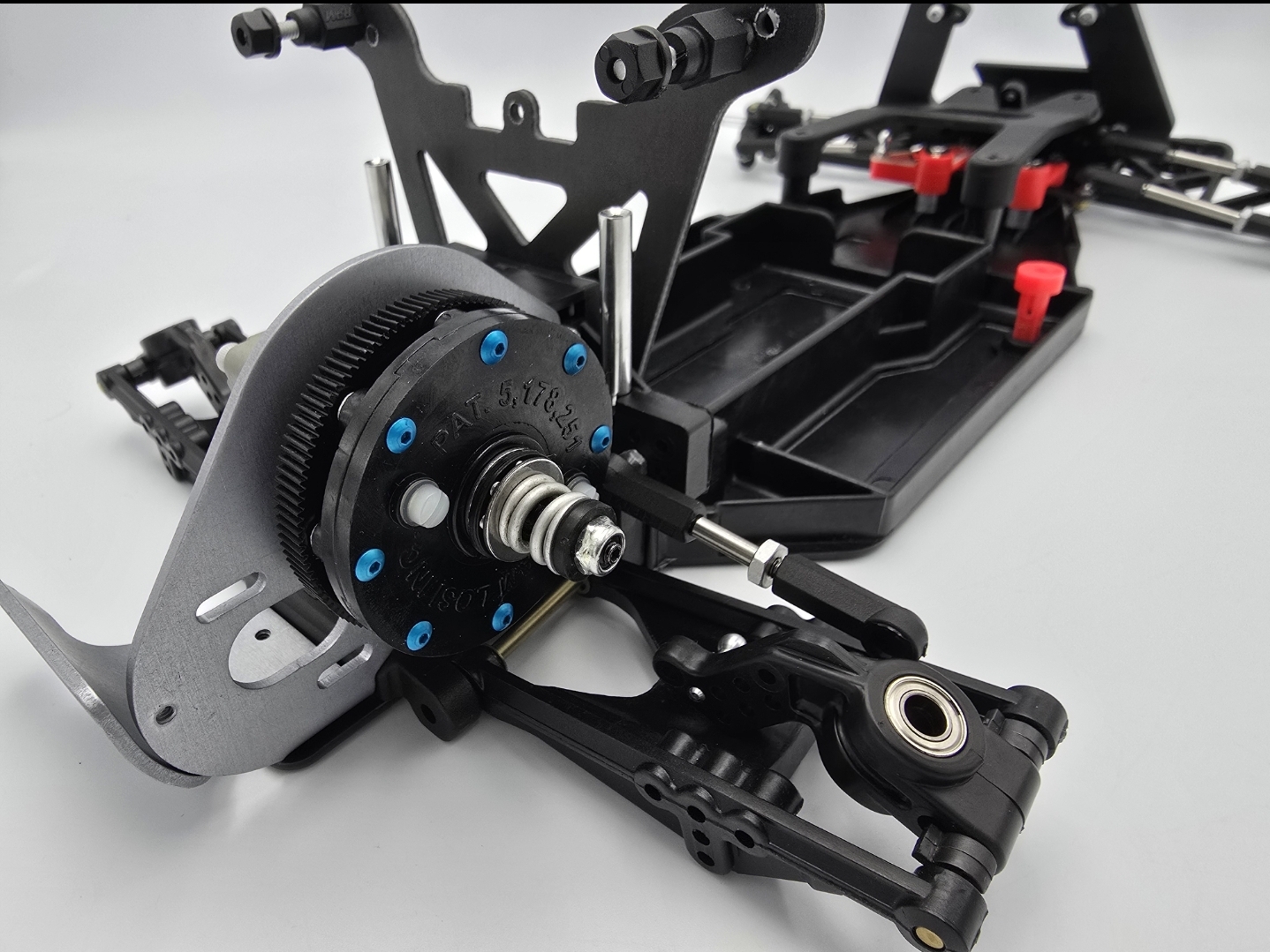

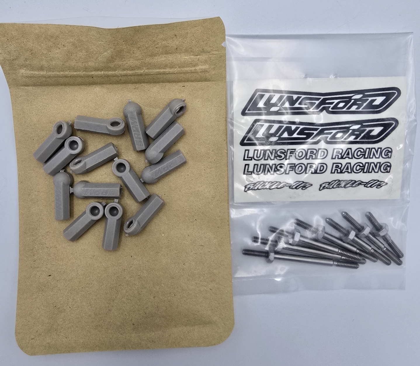

Rear end assembled and installed onto the chassis. Using Lunsford retro turnbuckles and RPM ends. I was planning to use these cool vintage grey units, but remembered they are for a larger diameter HD thread. RPM rear carrier and chassis brace finish off the slider.

Those RPM 0 toe rear mounts are a thing i didn't know existed and now i want them

RogueIV wrote: Sun Feb 23, 2025 3:52 pm Those RPM 0 toe rear mounts are a thing i didn't know existed and now i want them
I might have some...let me look tonight. I'd never use them to race with

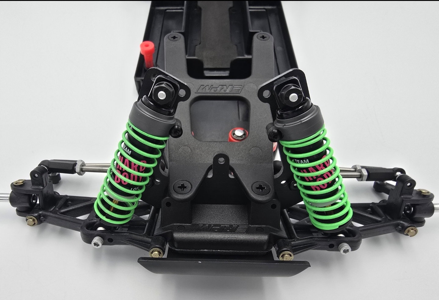

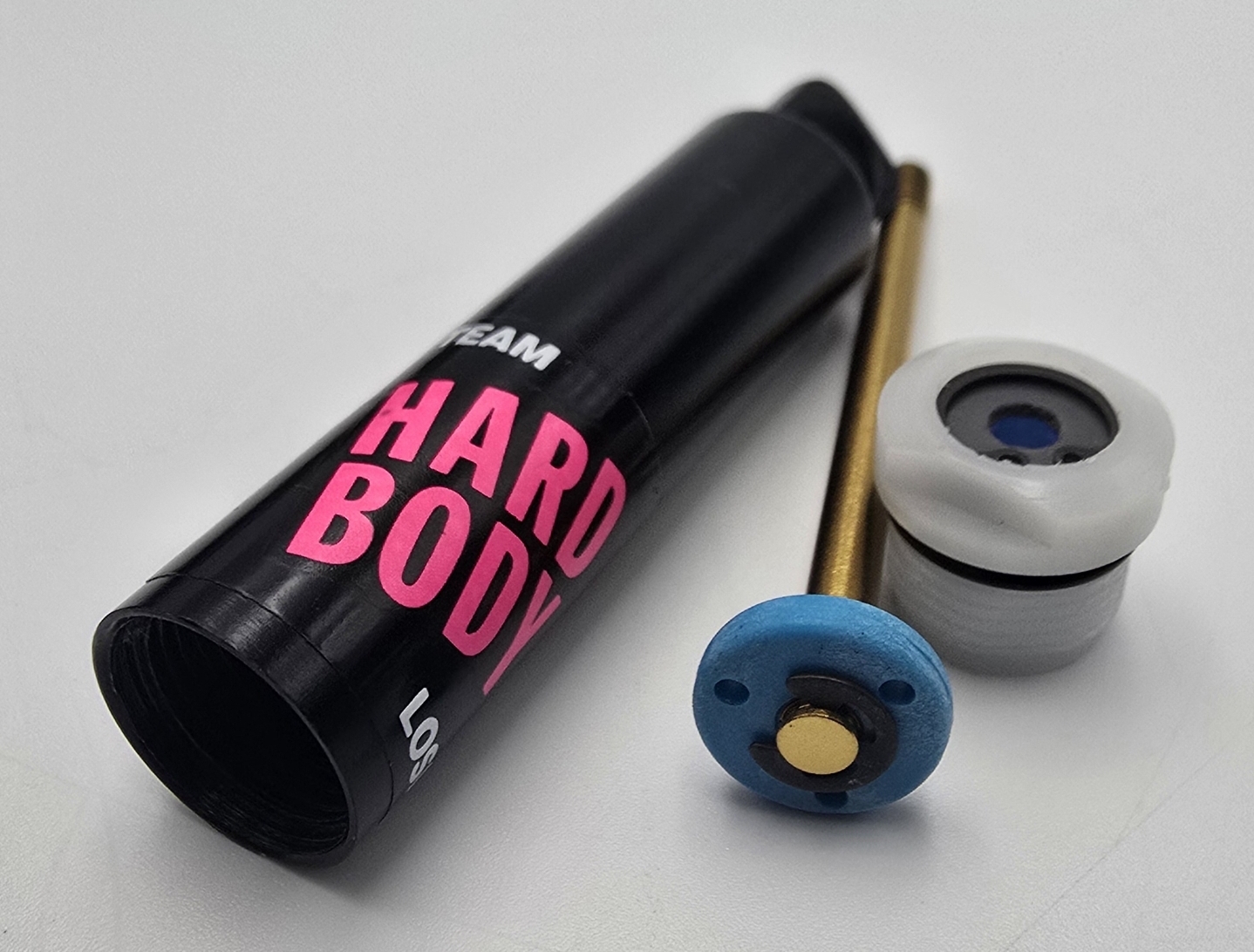

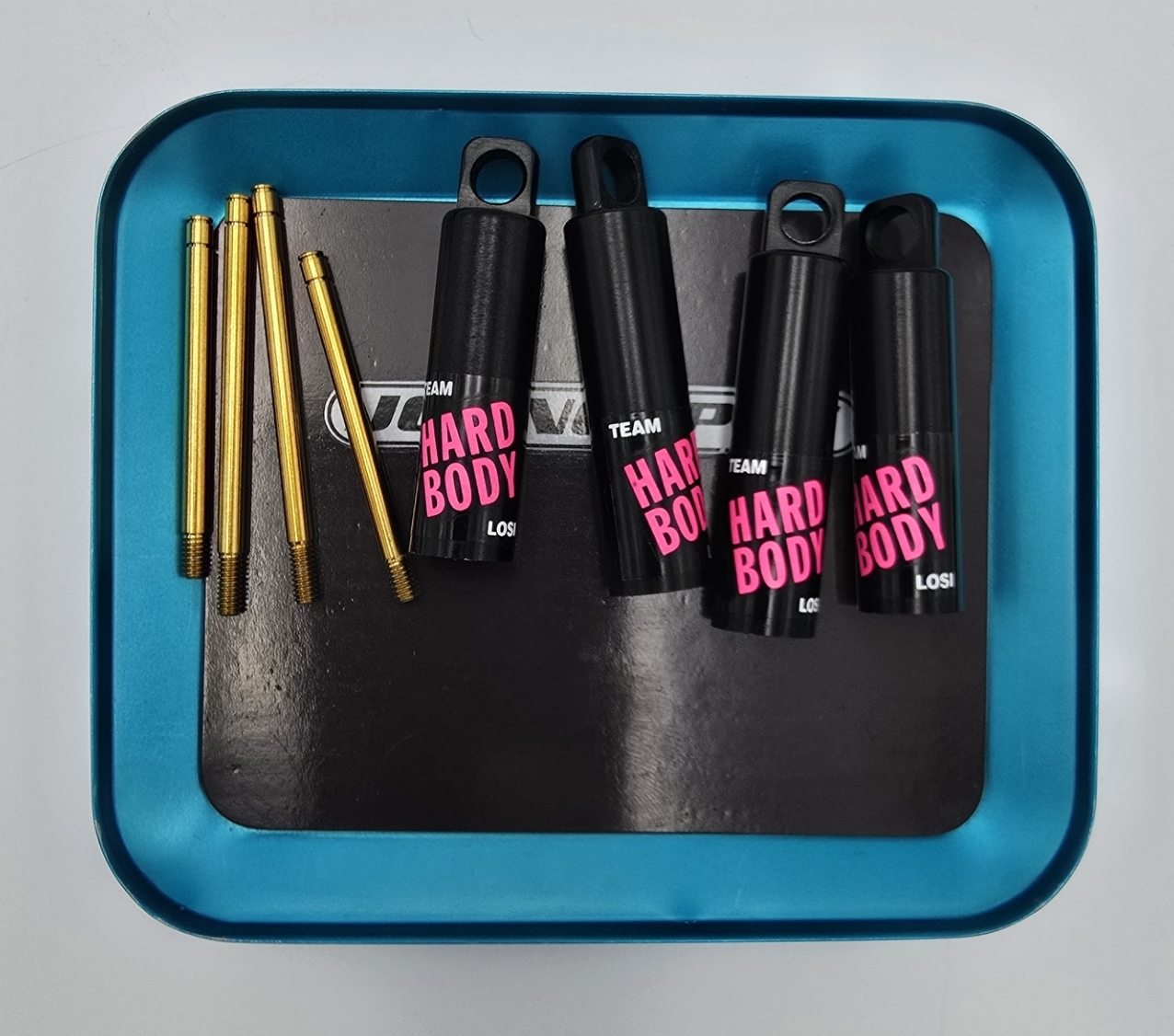

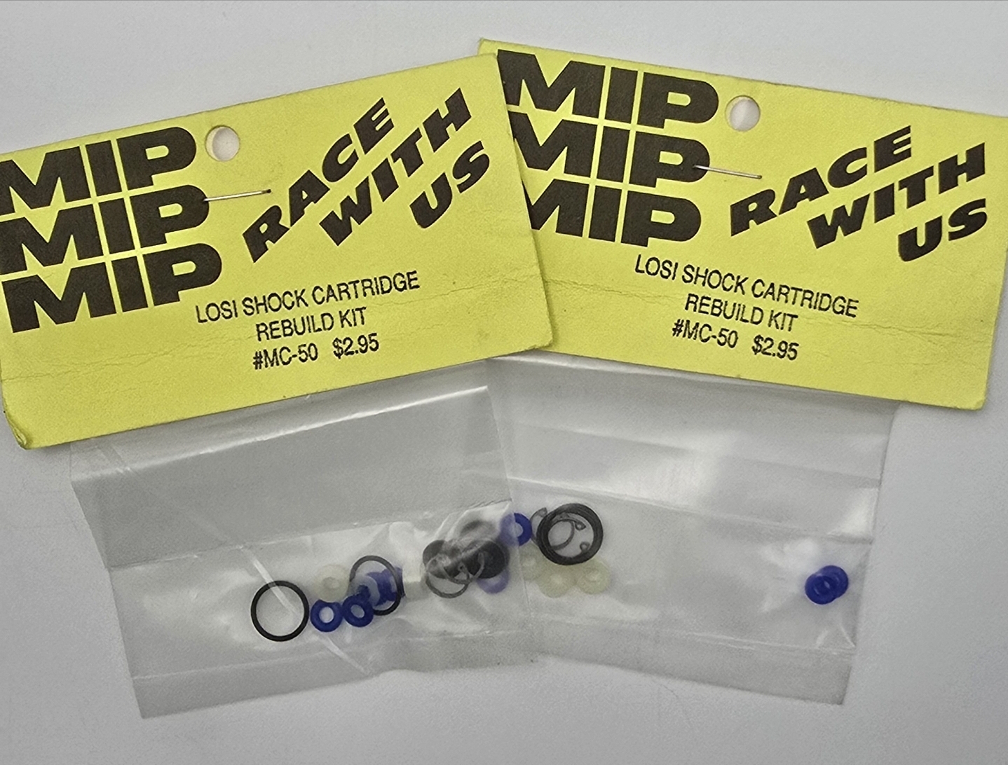

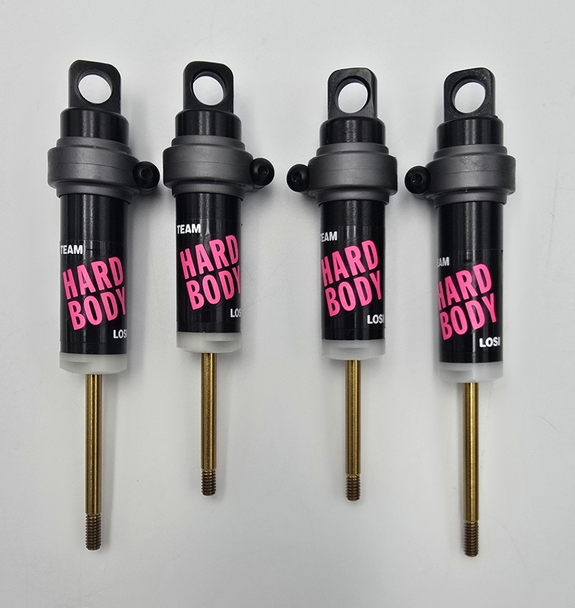

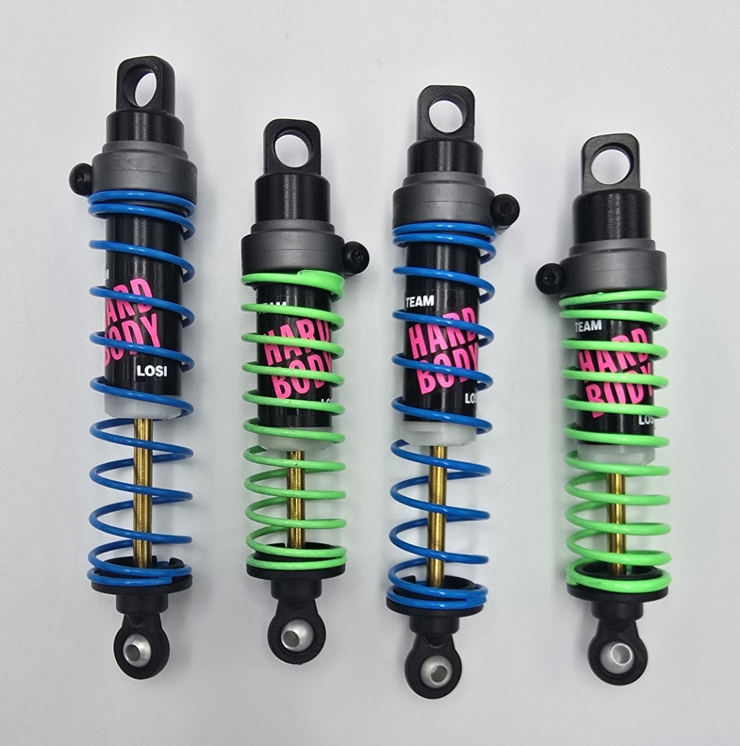

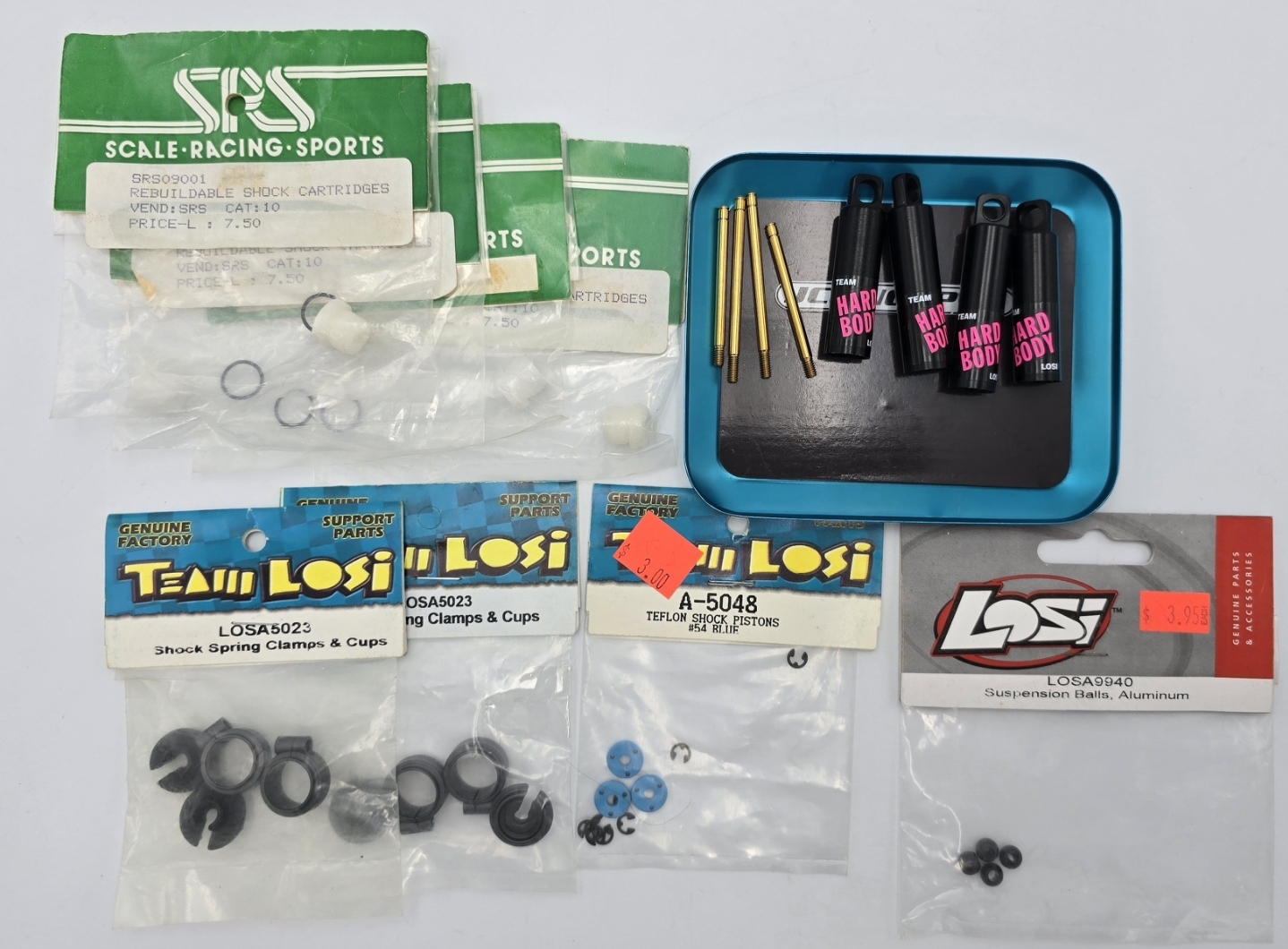

Shocks built using SRS cartridges and MIP internals. The internals are held in by a snap ring.
I'm not sure on shock spring color. I had sourced front and rear shock sprinks in black, for a cleaner look. However colored springs just seem to suite an SE.
