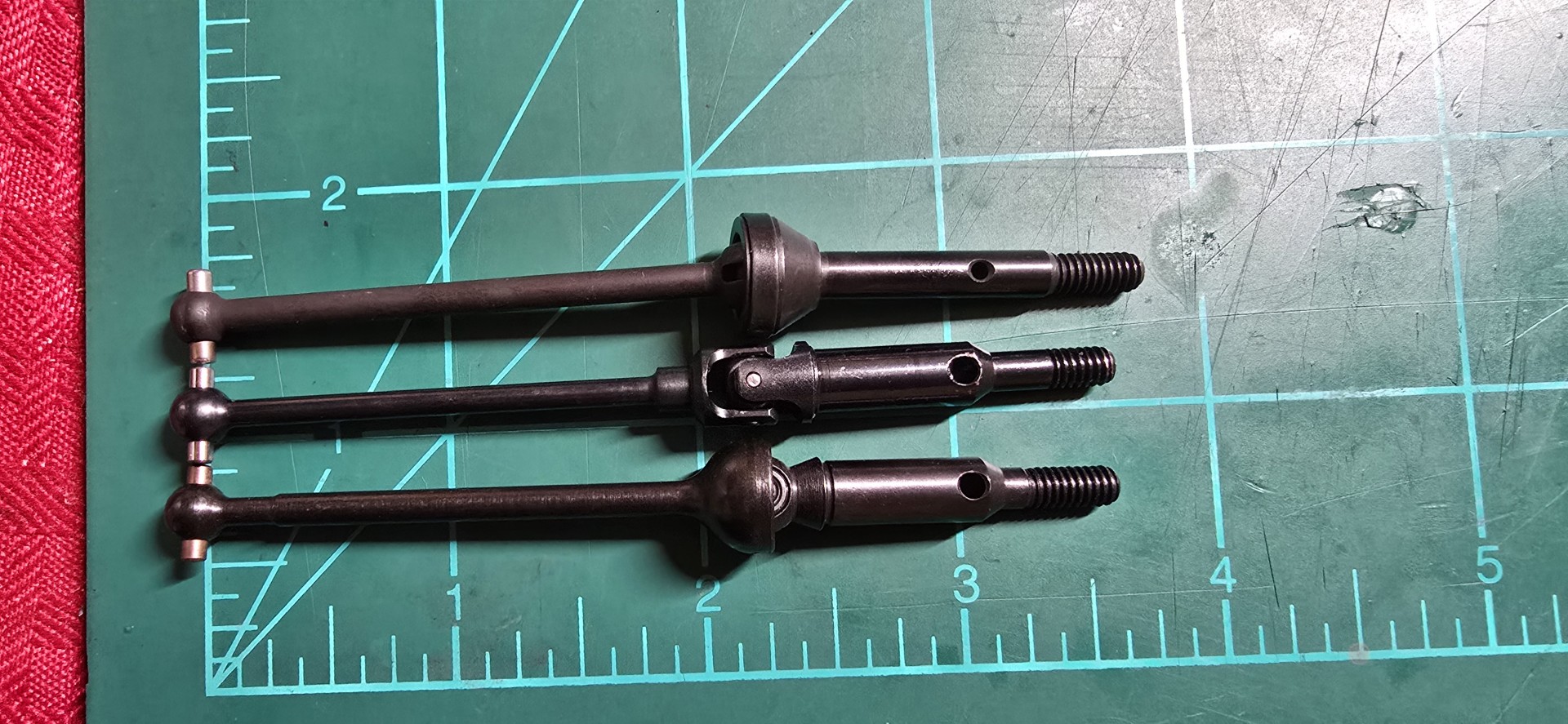

An additional option is the the FanRC +1.5mm CV axle kit (part FR-0064L). These are 3/16th axles that work with JConcepts Mono 2.2 inch wheels, but they require a shim and bushing accessory kit (part FR-0064-ACC), worlds style rear hubs and 3/16 ID bearings. This is not a particularly cheap option and will run $50 to $60 plus wheels. I have the MIP CVD kit #24110. It seems to be about the same length as the stock U-joint axles.
Top Fan RC, middle Re-Re stock, bottom MIP #24110 CVDs
Top = Fan RC +1.5mm CVDs,
Mid = RC10 Team car Re-Re stock axles
Bot = MIP #24110 CVDs.
I ran my OG RC10 Graphite with the U-joint dog bones right on the ragged edge of popping out of the Stealth transmission outdrives and got away with it for years, but both it and my Re-Re team car now have the Fan RC +1.5s. I did have the stock U-joints in the Re-Re team car at first and the tubing solution worked but it was close. The +1.5mm axles provide an extra margin of safety.
