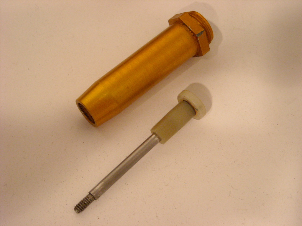

Do you have any down travel limiters on the shafts inside the shock bodies? If you are using the stock 1.32" shock bodies and shafts then you should and maybe you don't have enough in the shock on the side where the dogbone is popping out.

when the SP1 was made, the gold pan still had 1.32" shocks that needed 5/8" rubber fuel tubing on the INSIDE of the shock, with the 1.32" shock shafts. I would suggest starting at that point, and checking travel and bone alignment. it may be that is all you need. I never had the SP1 new, or it's instructions, to see if MIP recommended any particular down stop settings different from stock.
CVD's were not around at that time, it may be that the SP1 outdrives are a bit short compared to stealth and 6 gear, the MIP CVD's may be slightly short. another thing you can do after limiting the shock travel is to put all the shims on the inside of the hub, if you haven't already done so.

slide the tubing over the shock shaft to limit the down travel

Yes tubing like rcresto showed. The rc10 manual shows a picture or describes the step.
