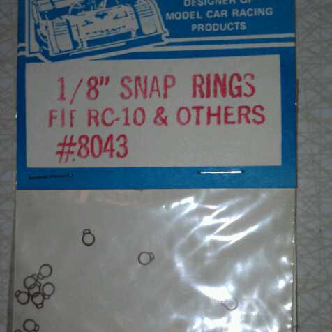

An alternative to e-clips are snap rings aka circlips which have been used and sold for R/C applications. Although I imagine they would catch on more things once the part that protrudes orientates itself towards the ground.
(Pic stolen from eBay)
snap rings.JPG (17.6 KiB) Viewed 3018 times
Those are a little odd as I'm not sure how they go on. Hopefully there's a slit where the square hole is.

You can buy snap rings from McMaster-Carr. I have them on my cars since I kept having problems with e-clips popping off too. They are a bit of a pain to install but you'll never have to worry about them again. A good snap ring plier helps installing them.

Can anyone confirm the correct size for snap ring retainers for the RC10/T? I want to order some pieces like the Parma shown above, but am confused on sizing. Thanks.
