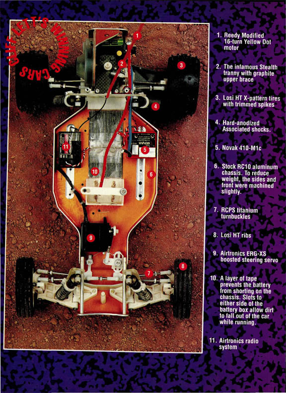

Post by ROH73 »
"Opinions and discussions are very welcome here, but if there is something that you are posting that you are A) claiming as fact. or B) think might get people 'pissed'. take a second and think about whether or not your opinion is valid and contributional, and not some recollection of something you read in rcca years ago or your own personal idea of the marketing schemes and production cutting costs of the corporate giant that was associated in the early 90's."
I can't fathom why a recollection from RCCA is not valid or contributing the this online forum/knowledge base, especially when that recollection is accurate. From the December 1990 issue, an article entitled "Inside Cliff Lett's Winning Cars," shows Lett's RC10 with milled pockets and specifically states "You might think that the slots and holes machined in the bottom are there to reduce weight, but, in fact, they allow dirt to fall out. This is a great idea, because dirt increases weight and affects handling."
Please see attached scan, showing pockets nearly identical to the ones in the Worlds chassis'.

Post by Eau Rouge »
From reading that magazine on and off for 20-odd years, it wouldn't be the first time they had no idea what they were talking about. :wink:

I remember Cliff Lett's car having the vertical sides of the tub having elongated milled slots all the way through. Maybe that is what they were referring to? They couldn't have been that idiotic to think that the shallow slots milled in the belly pan allowed dirt to fall out. :?
