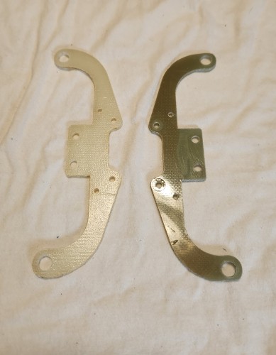

So, let's compare parts side by side. From here on out, Tamiya parts will be on right, and Extratoy on the left.

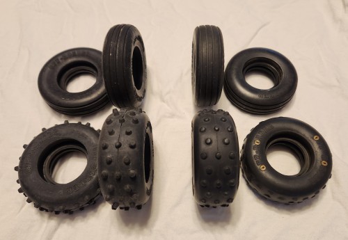

Random start, tires. Very similar except the Extratoy stamps a tag of ES-802 between the OFF ROADER stamps. Everything else seems identical.

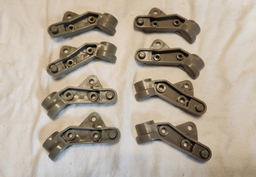

Now just a series of the "grey" parts used throughout. It is hard to tell in the pics, but the Extratoy parts are a little lighter grey than the Tamiya parts.

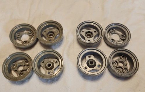

The wheels are identical mechanically, but the Tamiya ones are a silver'ish, and the Extratoy ones are the same grey as all the other parts.

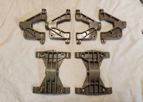

Rear bumpers.

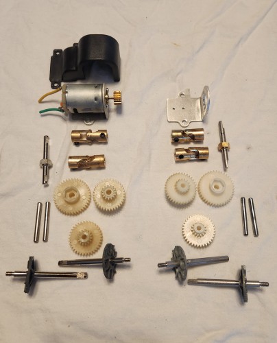

Transmission. This one is a little interesting. Note the Extratoy driveshafts are plated (chromed?) and have the extra safety lengths on the ends, and the Tamiyas do not. The Extratoy also came with a trans gear cover, which the Tamiya did not. The Tam I got did not have a motor, and I thought that would be easy to get, but 360/380 motors with nylon endbells aren't out there like I thought they would be. The Extratoy came with a white nylon endbell motor, and the Tamiya should have a black nylon endbell.

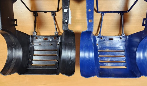

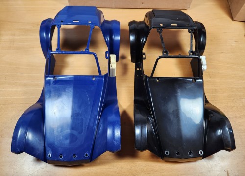

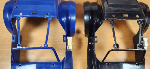

The body. 80% identical exceopt a) not same color, b) roof top mounting holes slightly different, and c) two piece rear louvers on the Extratoy. Material "feels" identical.

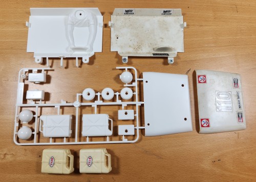

Body accessories. The Extratoy did not come with a driver or roof/front lights, but the Tamiya ones mount directly on. The jerry can bottom round/square holes are slightly off, but not a big deal. I realized I forgot the front susp / steering above. They are both very similar. The springs and screws are different color wise, and the steering link hardware is a little different. My Extratoy did not come with a front or rear bumper, but Tamiya ones screw right on. I would guess them to again be 90% identical to Tamiya.

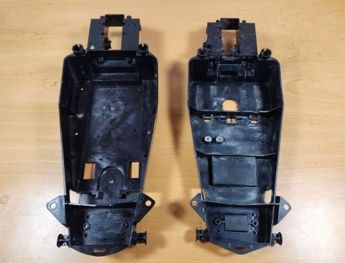

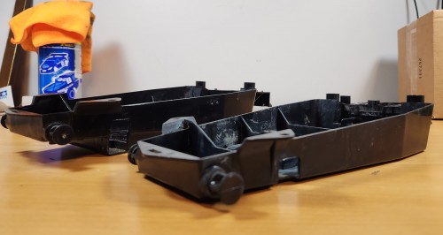

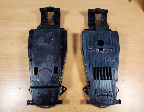

Then there is the tub. This is the main part that is different .................. yet really, the same. The front and rear suspensions are the same mounts, but the mid-tub is very different. One is meant to mount standard RC components to, the other whatever electo-mech gizmos they had. The Extratoy tub is much deeper. Both of mine are in poor shape at the moment, and both holding up progress. The Extratoy simply needs plates installed so that HG RC components can be installed, and the Tamiya needs a bit more work on removing whatever TF some PO painted/globed all over it. The Tamiya tub will never be very good, but will be good enough for me to finish the current build on it. Hopefully, I will find a great tub in the future, and move everything over to it.

Interesting! Just enough difference to confirm the parts didn't come for the same tooling.
Depending upon your definition of "clone", I probably would call them a close copy.
On the other hand, I see the HG P407 as a true clone - a virtual part-for-part carbon copy of the Bruiser whose parts probably came from the same tooling.
Anyway, it's interesting to see a side by side comparison and ponder what could have motivated them to make this RC buggy. If one is investing big $'s in new tooling, why make something that already exists? Was the HB really that successful bitd?
