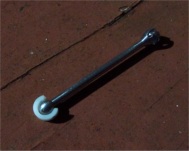

i have been using the same pin cushions in aluminum cvd bones and aluminum outdrives in my 10t based oval truck for the past 2 years with virtually zero wear. this is in my weekly racer that gets used in the stock trucks class. the only trick i use is i grind down the legnth of the steel inserted pin a few thousanths and when re inserted space the pin with equal distance space on either end so i can fill the small cavity with superglue. the reason i do this is sometimes the steel pin can slide out like halfway and the plastic will not so the glue has prevented that. i tore grooves into many rear arm mounts and spur gears and smoked 1 GM3 motor before i firgued that little trick. with all that aluminum in the drive train the truck rockets off a corner,the accelleration is unbelievable, espically in a truck turning 4" schumacher tires.
Re: RC10B3 4WD
Yea i was worried about the pin sliding out, that'd ruin the front gearbox. Do you just superglue the pin with pincushion into the original hole and it stays ok?

if the pin were glued in you could not get it back out if it needed to be replaced due to wear. actually the plastic sleve is slightly larger in diameter than the dogbone hole. you slide the plastic sleve into the bone, center it, then insert the steel pin. when you slide in the pin there are tiny ribbs inside the sleve that expand the sleve when inserted and keeps it tight. however i do have 1 set in my edm car that for some reason the pin seems to walk out. i have seen some dogbone pins once removed that were serrated to keep them in place and others not. they were both mip bones but had different pins. so i just had to dimple the aera next to the hole in an effort to slightly deform the hole, this has worked well and has not walked out since.

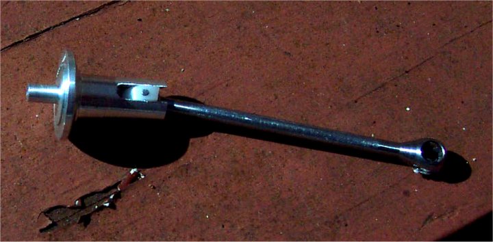

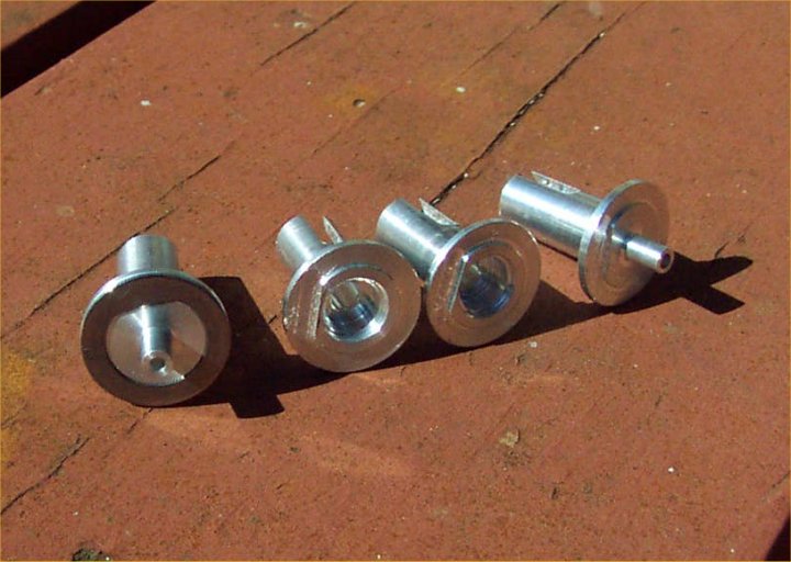

I made the aluminium outdrives and the outdrive blade thingos, i'll use pincushions on the CVD pins I think. Made it D-drive, I can still use normal rings if I want. They weigh 4g vs 10g for originals.
Broke my 2mm end mill doing the slot on that CVD so i've gotta wait til next week to get another one..

Is that freehand or CNC Bugle? Either way, they look great! Both the outdrives and the blades, nice work.

i take all my aluminum outdrives and make them accept d-rings as well. i can use either losi d-rings or tc3 d-rings. i.r.s sells d-rings in packs of like 10 or so, thats what i use.

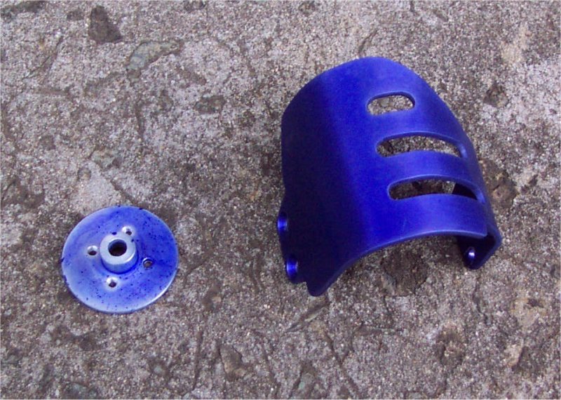

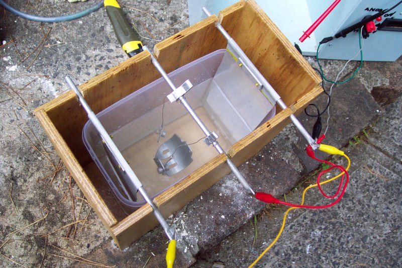

Got an anodising setup working, did a few test pieces to start with in red, blue and gold. The gold dye looked like the chassis tub gold on the packet but came out pale gold like the chassis screws, gonna have to try a darker orange.. My dad made the constant current power supply for it, cathodes are really thin Al printers plate clamped onto Al tubes. Hanging the bits by Al mig welding wire fixed with Al thumb screws I made and some pegs on the top tube to give it a good connection. Had to keep everything above/in the acid aluminium because any steel will ruin it.

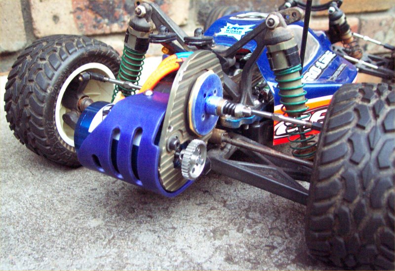

First actual parts I tried dying are these B4 parts. Made a motor guard because the original nylon one is incredibly flexible and bends solder tabs on brushed motors, not so bad with brushless though.. Made a new outer slipper plate old style that mates to the original B4 inner and uses B4 slipper pads so I could use spur gears smaller than 78 teeth for 17.5t motor gearing.
Was sealing it with steam and I dropped the damn slipper bit in the water before it sealed and most of the dye ran out! Motor guard is good though.
