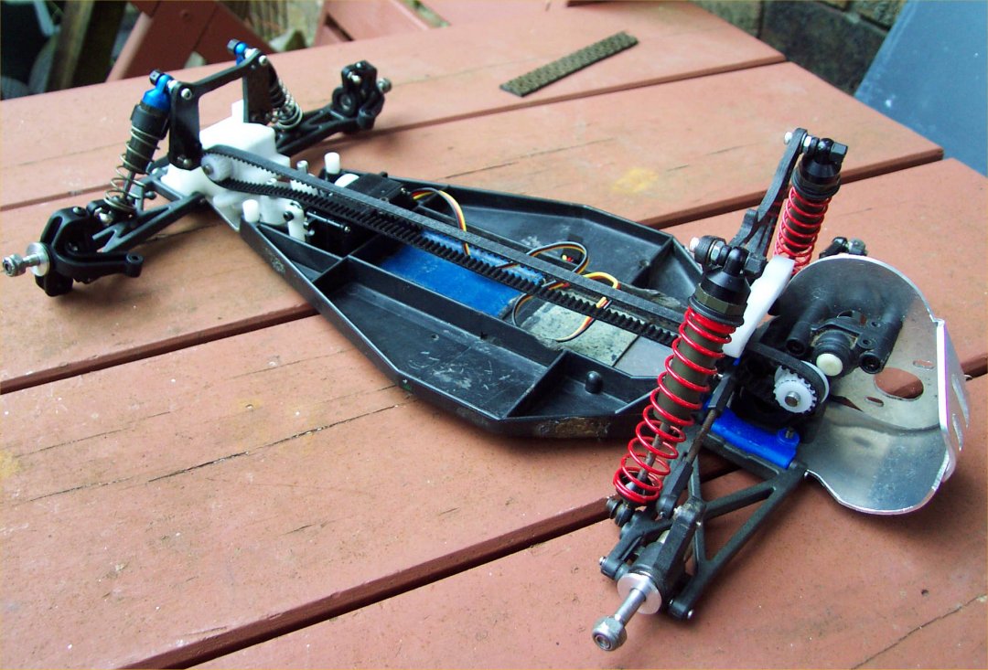

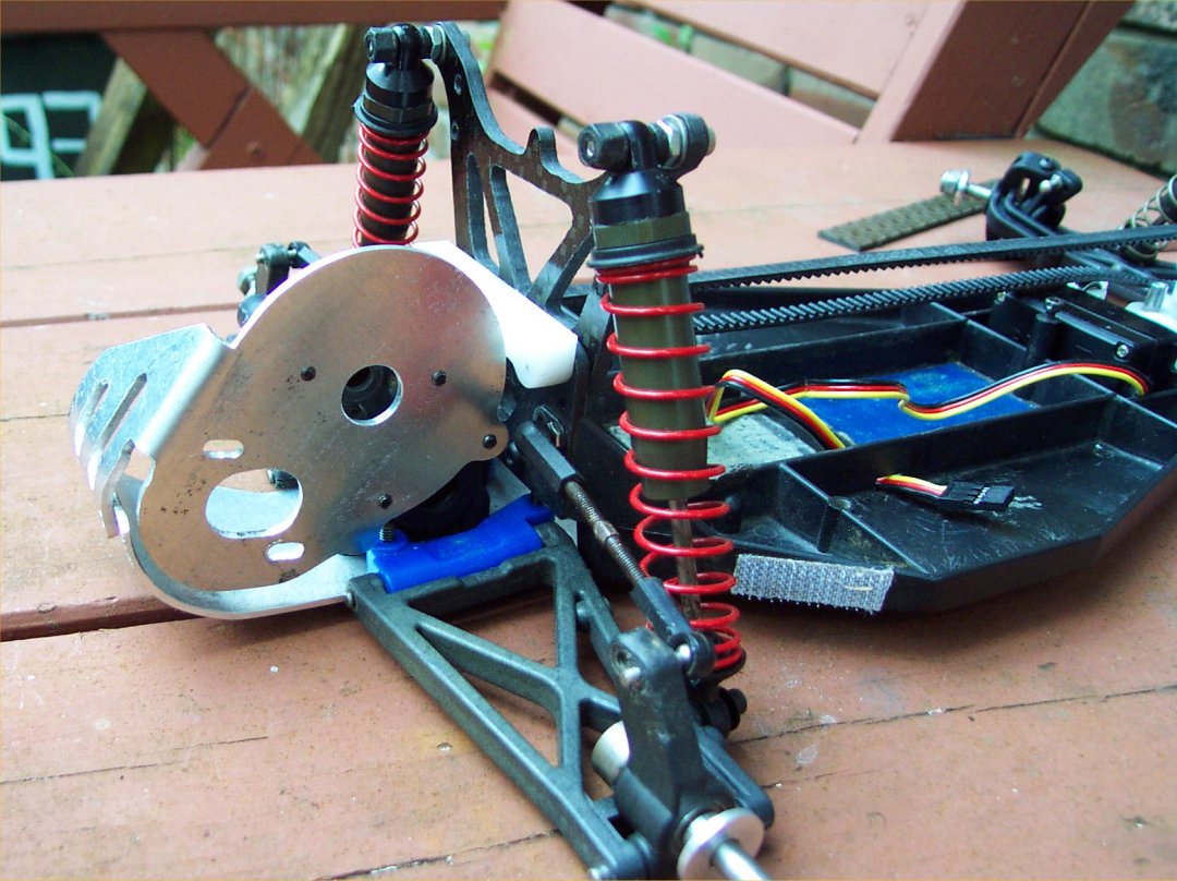

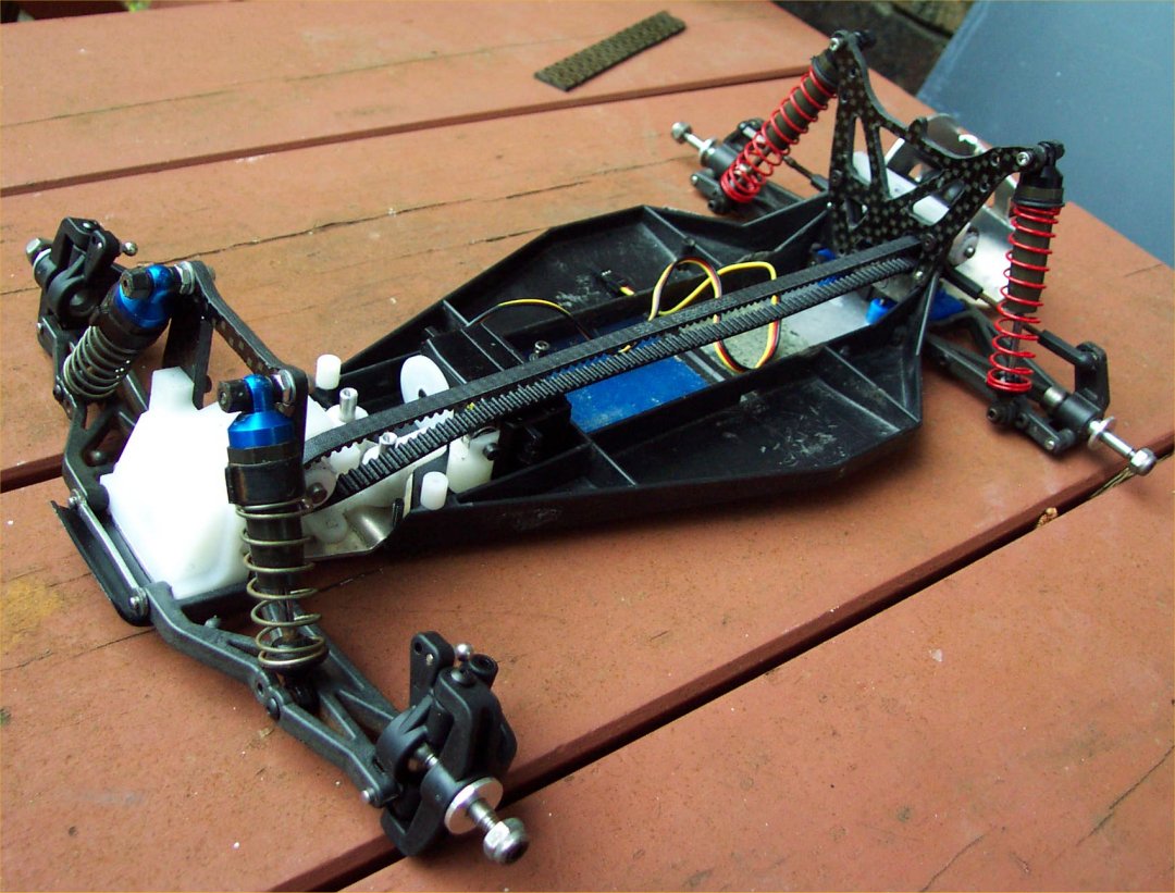

Something i've been working on, not alot left to do. Obviously MIP legends inspired :wink:
Started off with a B3 and now I don't really have much B3 left in it
Specs
B3 chassis which had the front brace knobs snapped off so that's why i've put delrin ones there.
B3 front and rear arms, rear hub carriers
B44 front steering knuckles and caster blocks
Custom delrin bellcranks with rack type thing B4 style
B4 standard rear wheels for rear
B4 rear wheels with the inner bead chopped off and modified offset for front
2.25:1 Stealth transmission (needed the spinning idler shaft), idler gears pinned to the pulley shaft.

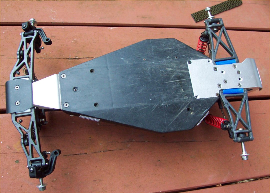

Custom made rear chassis plate, rear arm mounts 4mm further out each side to clear the trans, motor plate is a copy of the B3 one but attaches to 2.25 trans.
Custom made front chassis plate with 10 degrees kickup.

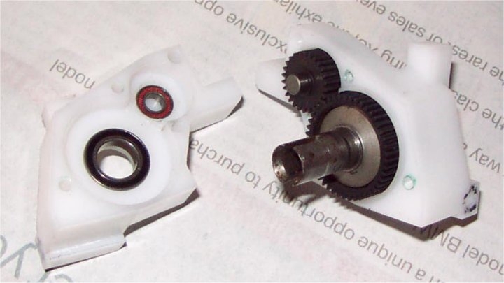

Machined delrin front gearbox housing/bulkhead for standard stealth diff gear and idler.
3mm pitch HTD belt
3.5mm carbon fibre shock towers
Still gotta make the driveshafts and finish the outdrives. Made aluminium outdrives and i'm going to make some "blade" things to go over the dogbone pins. Then clean up the chassis plates and motor plate and anodise all the aluminium bits blue.
Then I need to make the front and rear transmission braces,
Belt system needs the tensioners mounted properly, and the drive pulleys need to be finished with a plate on the outer side and a screw to hold them onto the shaft.
