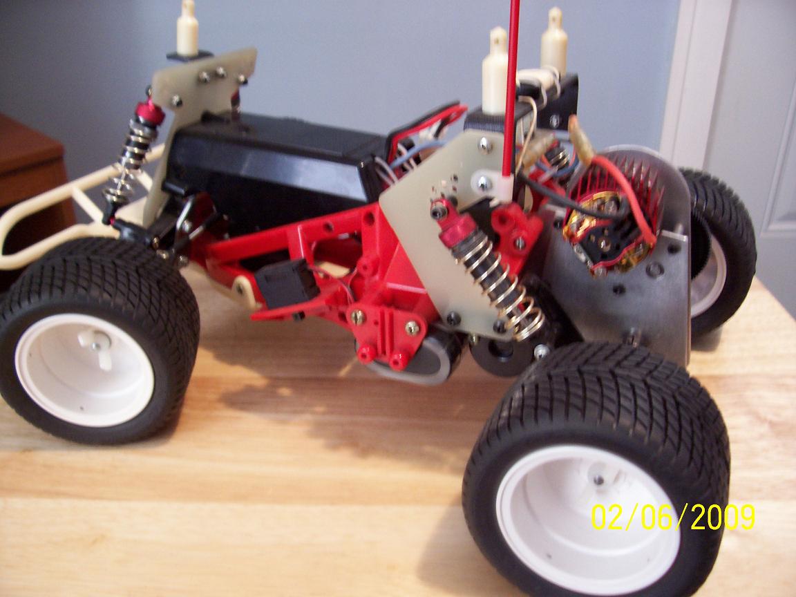

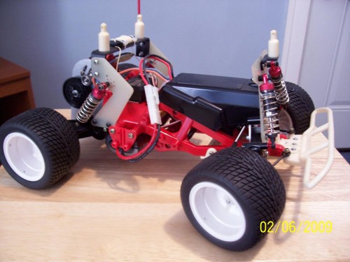

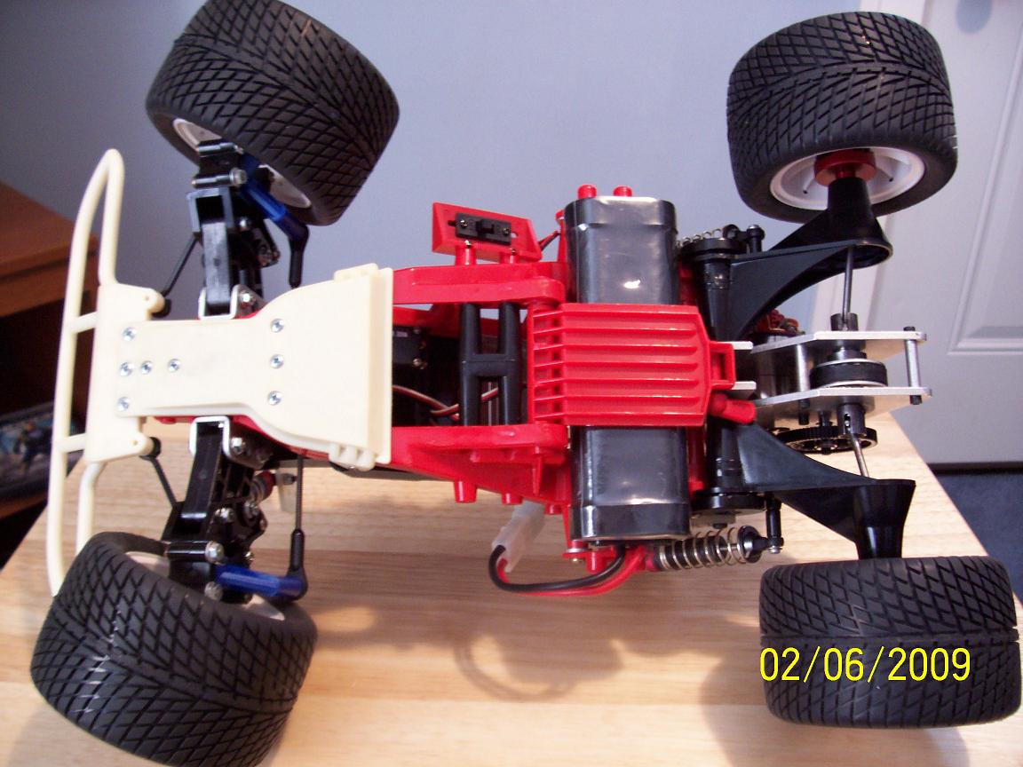

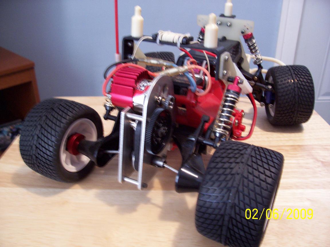

Well i just paid for my doner truck i won on ebay.Man i can't wait to get this I think this will make a perfact match with my sassy chassis.Now i just have to wait on the auction for the rear Jg shock mount and body mount to end and then for them to all come in and i will begin putting it togather.Here is some pics of the doner truck

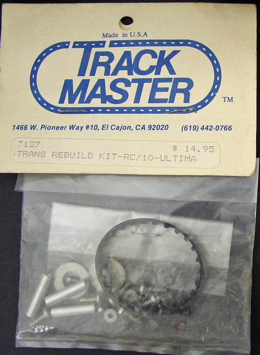

This is a pic of the trackmaster rebuild kit. From what I remember all the transmissions used the same internals, but had different plates and/or mounting adapters for the different applications. the rebuild kit comes with the belt and all the diff rebuild parts. I picked this one up off ebay for about $20 last year. I no longer have it as I included it in the sale of the sprint car which had my only trackmaster trans. Nice trucks, hope the info is helpful
