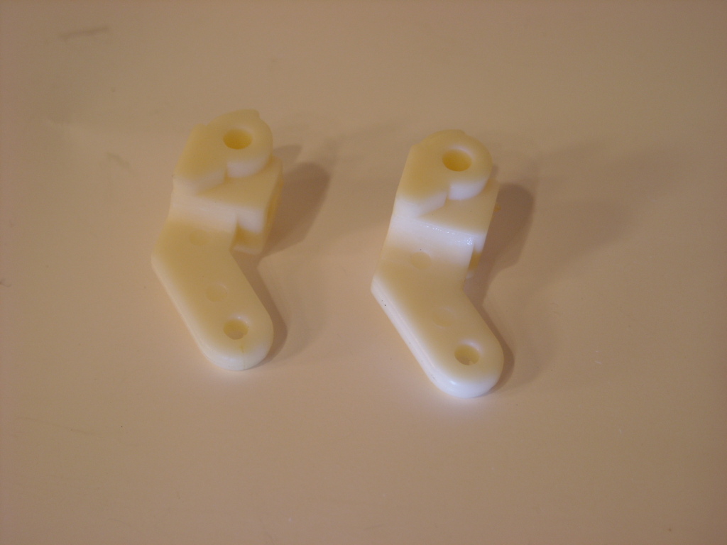

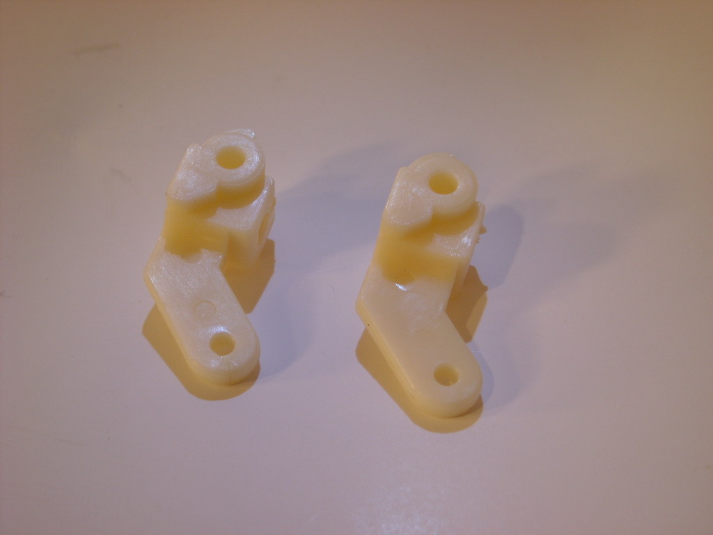

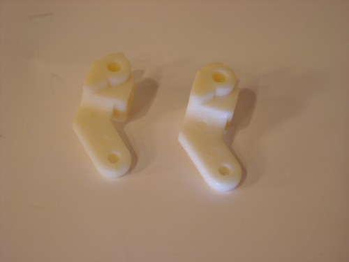

Hey Rod,
Has this off-set steering arm variation been noted?

slotcarrod
Posts: 4415
Been thanked: 45 times
Re: THE FIRST 25 YEARS OF THE RC10 (See page 1)
Post by slotcarrod »
No, I never noticed! Can you give us more details on them Brian?

RC10resto
Posts: 3009
Has thanked: 1488 times
Been thanked: 550 times
Post by RC10resto »
Just discovered by accident while replacing a C hub on my current early car build.
AE added some meat to the steering arm at some point (late 1985?).

hugger19
Posts: 1759
Has thanked: 25 times
Been thanked: 143 times
Post by hugger19 »
are the white suspension parts on the early light gold chassis cars any different then the later cars beside the rear shock cups. i noticed a post on here that the front steering arms are a little thicker on the early cars.

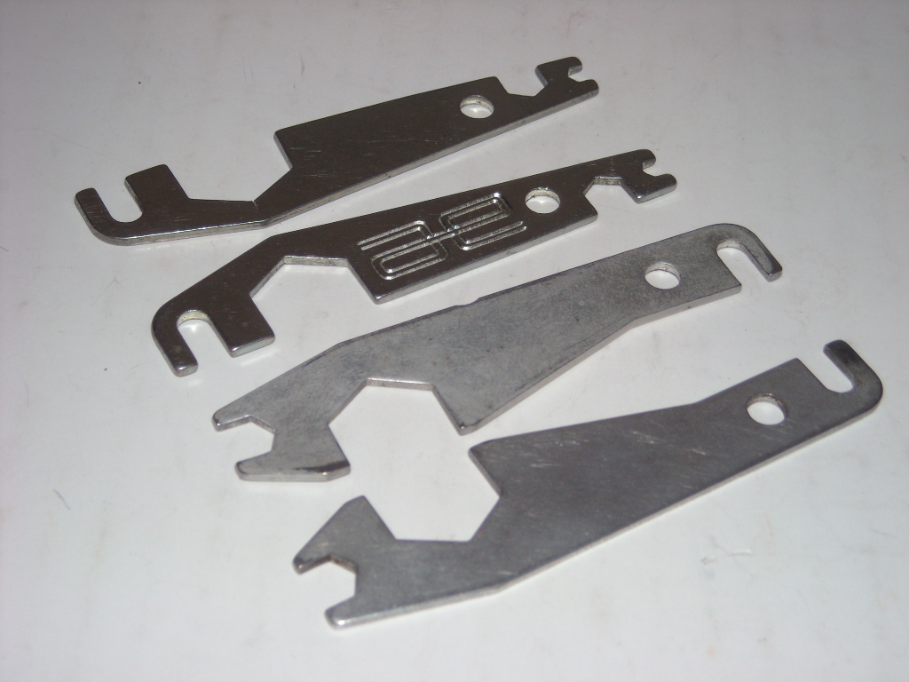

Also the shock tool that came with earlier cars are not stamped "AE" while later ones are.

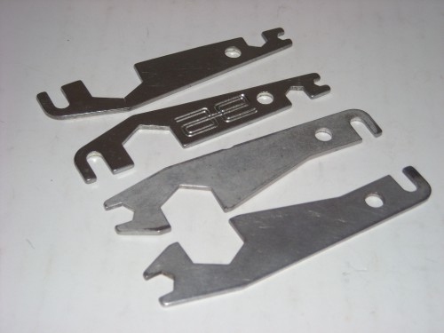

RC10resto
Posts: 3009
Post by RC10resto »
C'mon Rod - just picture the tool with no logo :roll:
Wait, they are different - I never compared them :oops:
slotcarrod
Posts: 4415
Thanks Guys. I will put that pic up later Brian! :wink:

RC10resto wrote:C'mon Rod - just picture the tool with no logo :roll:
Haha I did not notice that either. I never had both tools next to each other to notice the different placement.
