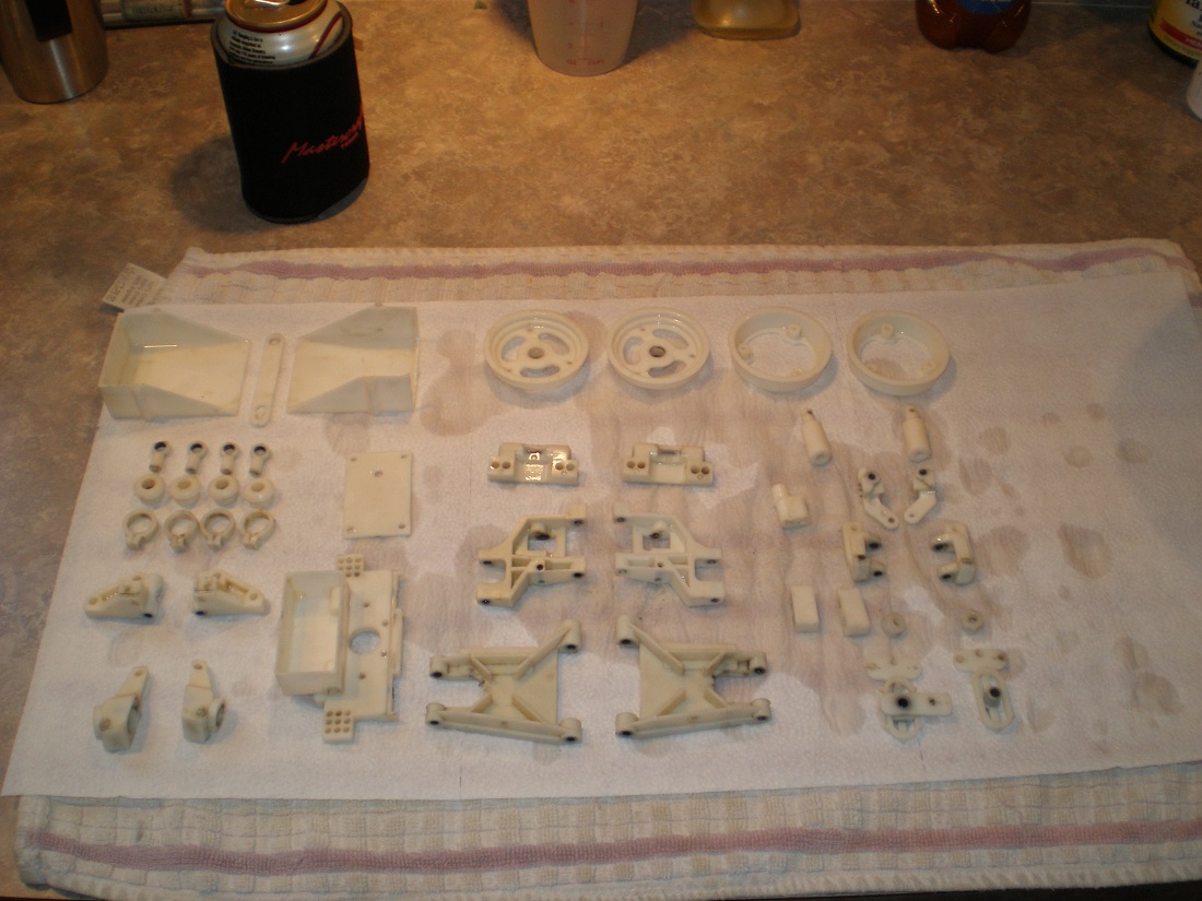

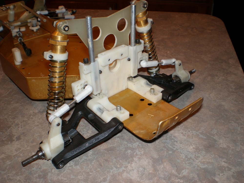

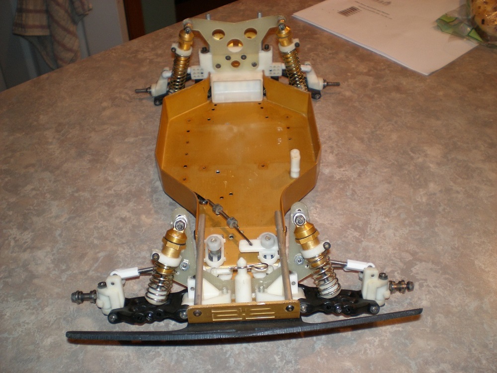

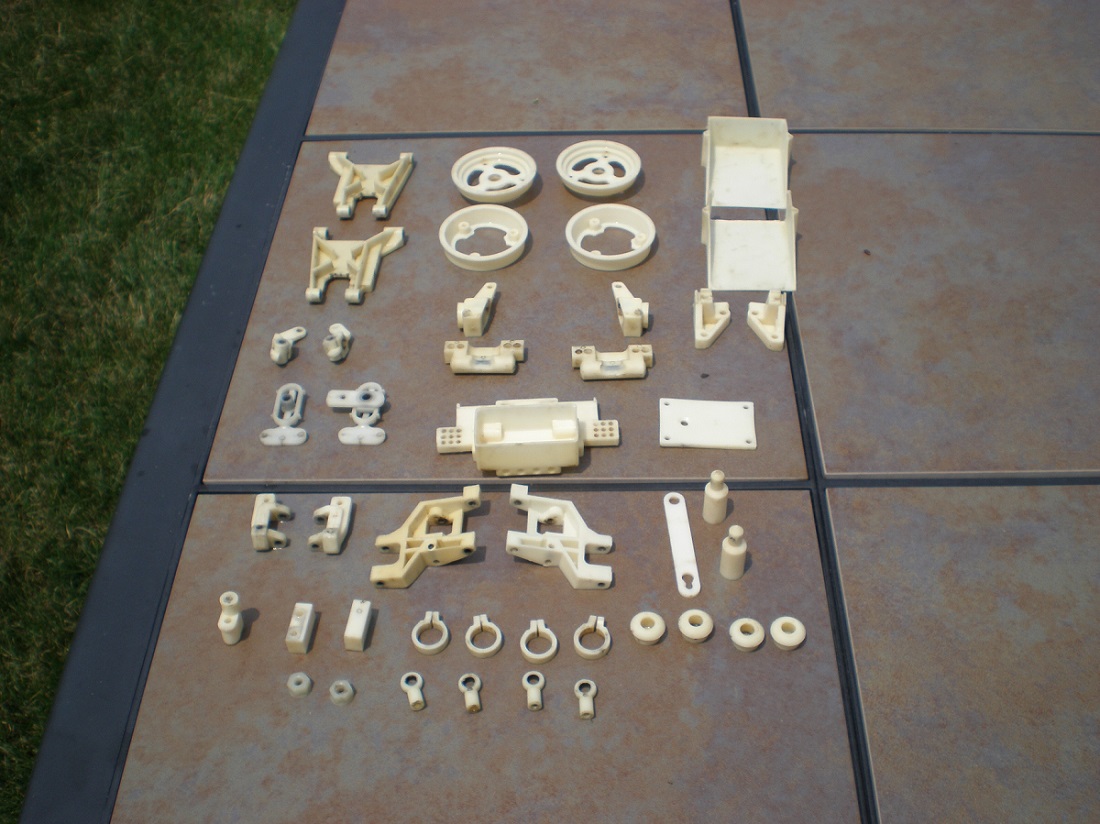

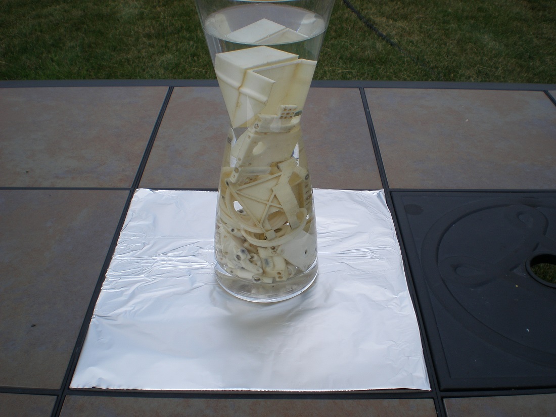

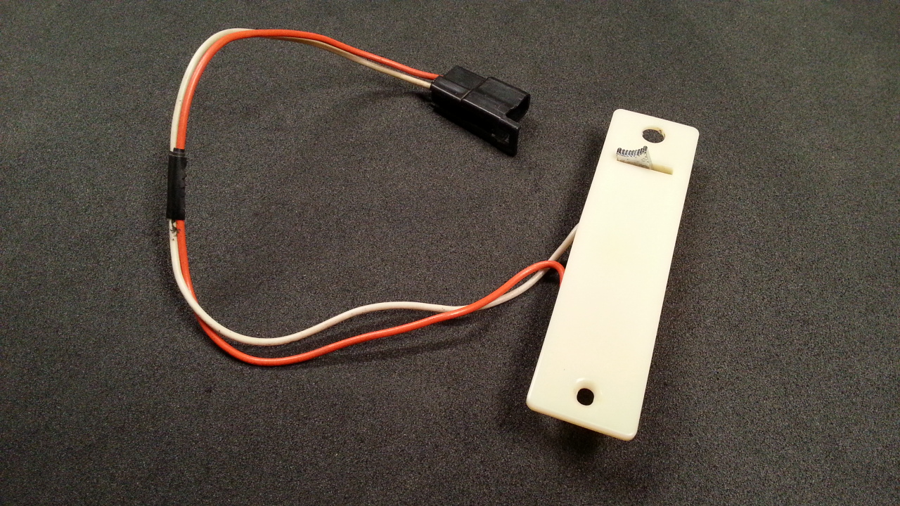

I just finished soaking my parts. I did a 2-day soak, both on sunny 80º days, with a blacklight used overnight. I did not achieve paper white like others have on here. Maybe I could have soaked them longer but they currently match a NOS front arm thats been in the dark since I picked it up years ago. Will post pics tonight. This is the first time I've ever stripped down the car to bare nothing. Will be fun building an RC10 like the kit it was back in 1984-85 :D
Flatoutdodge
Posts: 8
Joined: Mon Jun 17, 2013 9:38 pm
Re: Anyone tried this? Yellowed parts white
Post by Flatoutdodge »
Welp, here's my attempt. NOTE: The ball cups are brand new RPMs. I did not soak the originals. And yes, I realized I was using the wrong side of the aluminum foil :roll:

Yep I did. That one pic is after I boiled them. One thing I did notice is that the nylon seems to have shrunk slightly around the holes and the parts seemed to be softer and more flexible.
