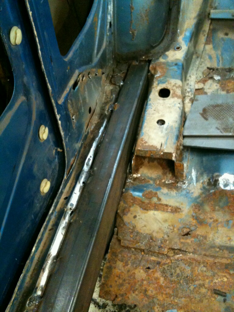

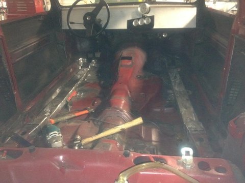

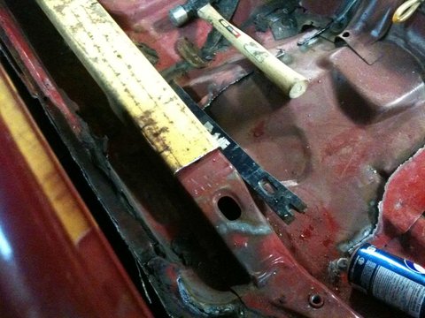

Got a little time to stare and come up with a plan on how I'm going to redo the rear suspension. Nice solid piece of 2"x3" inside of the rear frame rail cut to fit the floor shape. Then I will add a piece of angle that ties the frame rail to the side of the body and to the trans tunnel. Then for the heck of it I'm going to run a piece of tubing from the top of the frame rail to the side of the body again a little higher up.
Just a couple mock up pics so far. I've moved the rear heim joint over to the side of the bracket on the rearend and not in the middle.

There's not much "heavy" structural metal there. Have you thought of running some subframe connectors from the rear up to the front? Much easier to tie in the rear end solidly and add a lot of strength to the car. Also if you do add a cage later you can easily tie it into the frame connectors.

I thought I took some mockup pictures of what I planned on doing. Which was pretty much just like the blue car. Only problem was the tubing I bought was way too thick. I had the drivers side cut and almost beveled up ready to fit and I decided to weigh it and it was right around 25lbs. I eventually decided against it. I'm trying to only add heavier metal where absolutely necessary. I still need to get it to a scale but I'm hoping it weighs sub 2100. Maybe wishful thinking as the rear end was almost double the weight of the old one. But I've also pulled out 40lbs in just the windows and doors along the way let alone all the other little stuff. That little 4cyl was a tank when I was loading it up on a trailer to a guy who bought it.
It may get some sort of frame stiffener down the road. But at the relatively low power it has now I'm holding off.

I made some time to get back on this after work today. The new arm is adjustable so now I won't need to trim the rear of my fenders for the slicks. And I will be able to get the car a full alignment.
Anyways, nothing pretty here just some dirty patchwork and some reinforcing steel. Not going to run a support to the door pillar. Chances are depending on my 1/4 mile time it may need a roll bar. Don't want to have to much stuff to move out of the way later.

Looking good, I hope it takes care of your wheel hop issues. Definitely looks stronger then before. The Heim joints should free up the rear end too.
