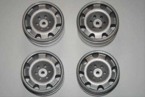

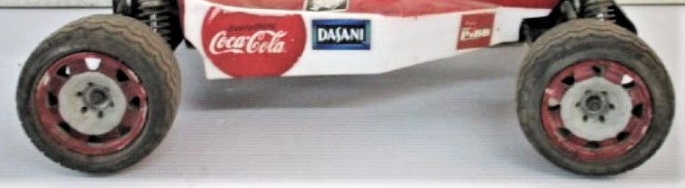

Going back to the wheels that I resurrected, I was satisfied with them because of how they were initially.
Then I tried my best to clean and restore. But I did loose the outer "lip", it was just too chewed up.

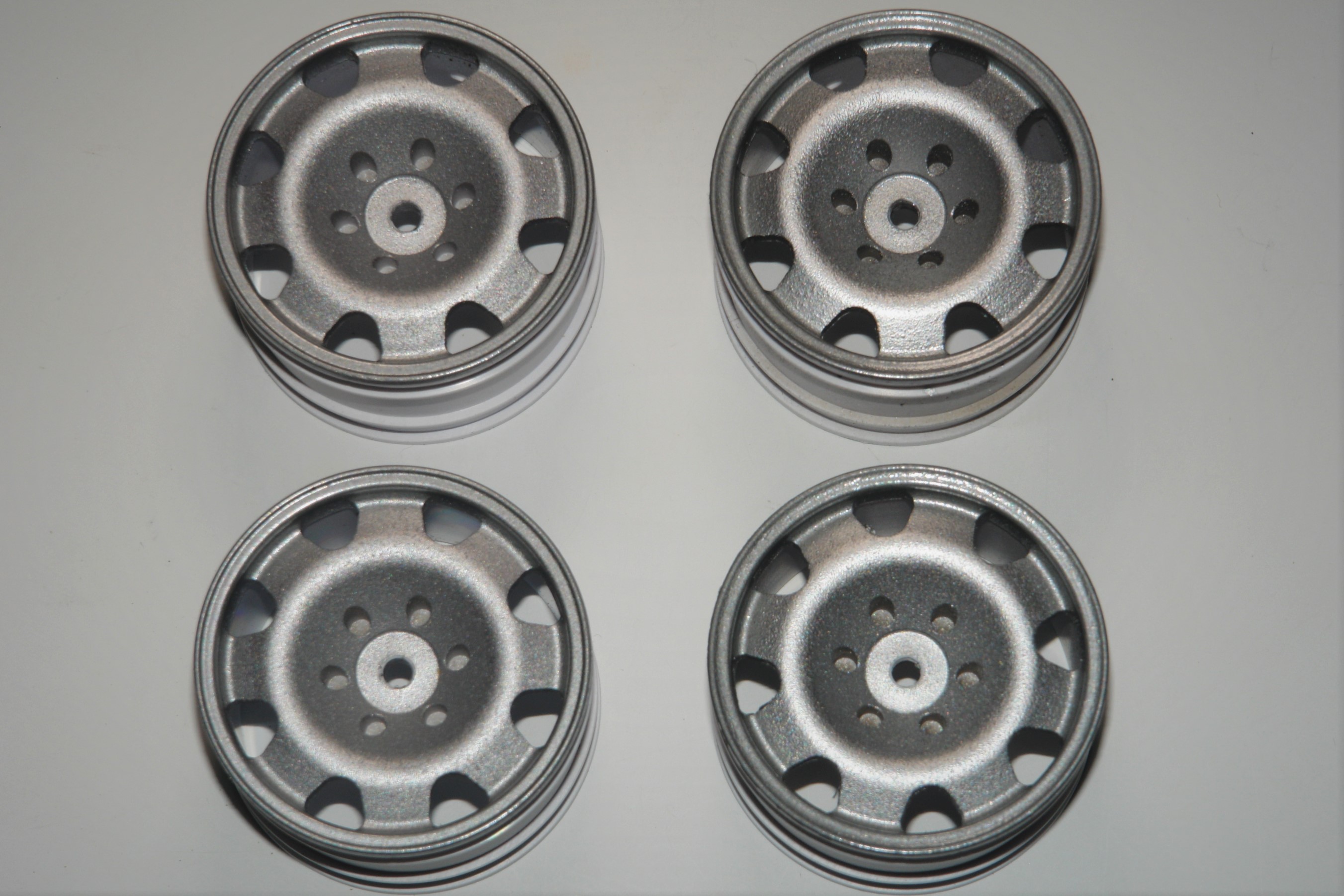

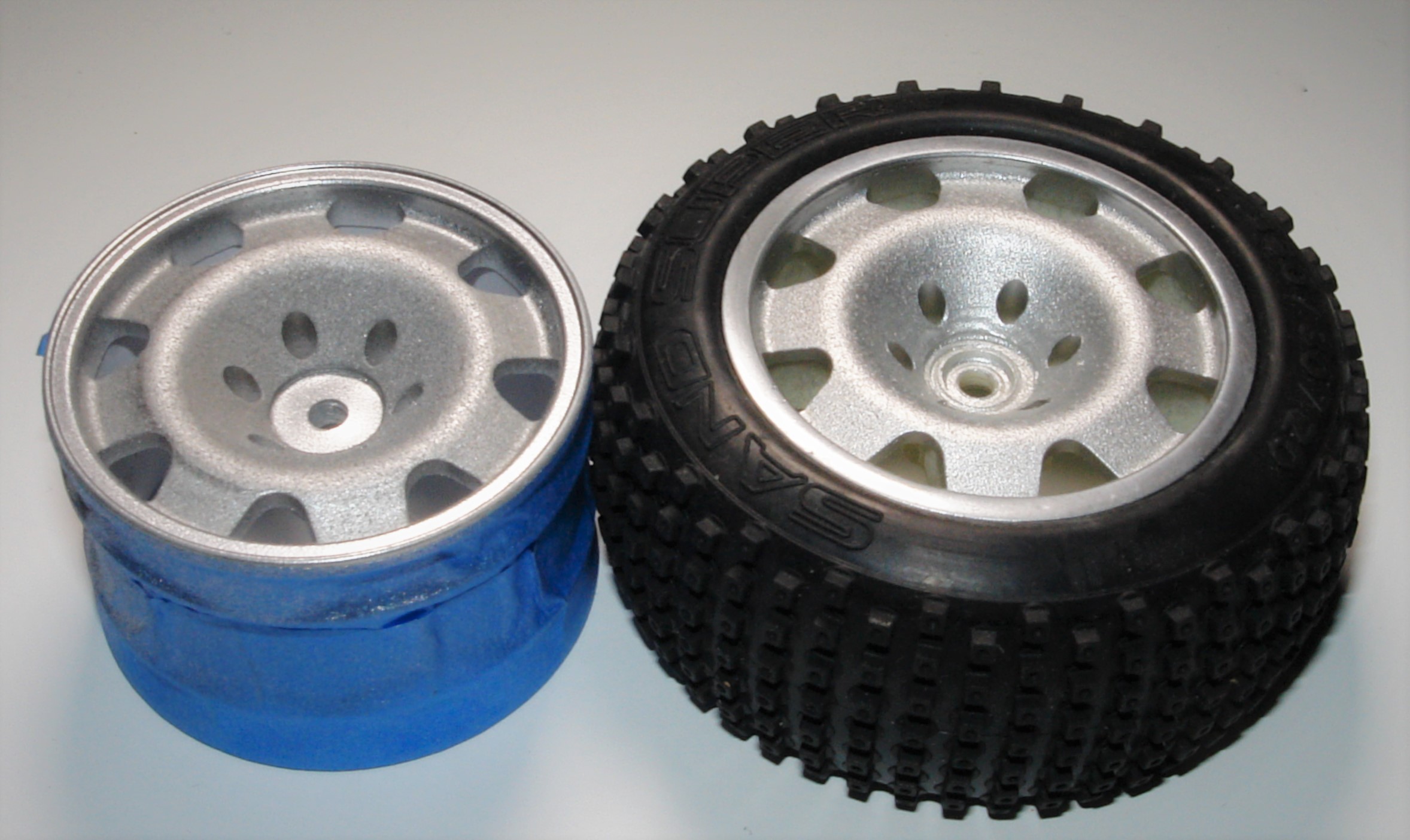

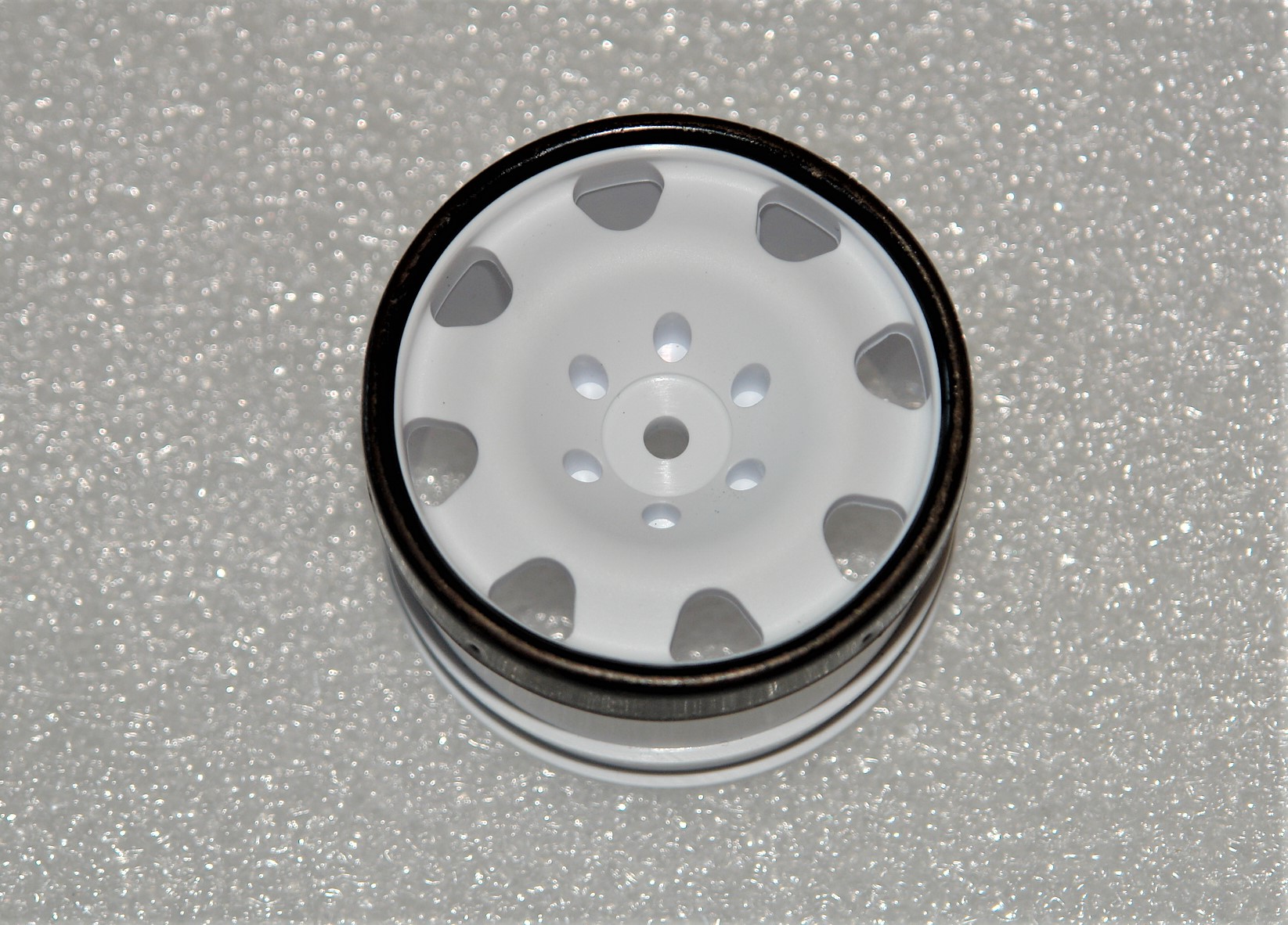

Recently I ordered the new Optima Mid wheels and have been trying to replicate the textured finish in the center of the wheel.
In the most recent attempt I think I'm fairly close. Right now it's the texture that is most important.
Pretty sure once I get this figured out Kyosho will release the TOMSE Re-Re and they original style wheels will become available :? :(
Not yet finished with the new wheel. It only has a light "dusting" of silver and the lip still needs some sanding/polishing.
Chuck

Pretty happy with the results.
The sandblasting can be a little tricky.
Chuck

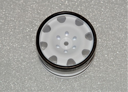

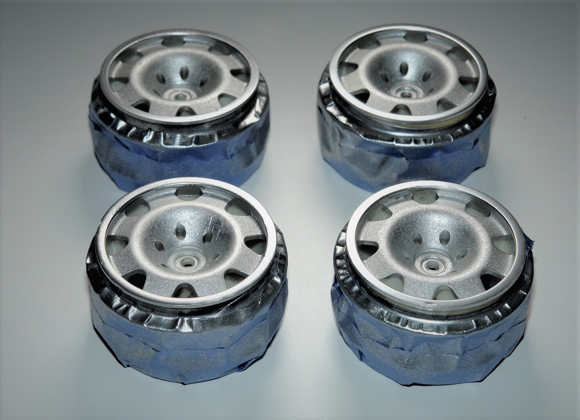

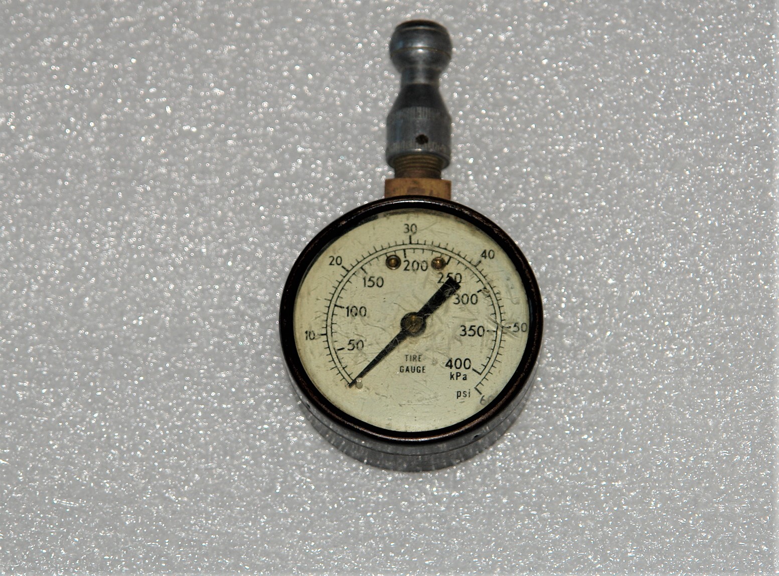

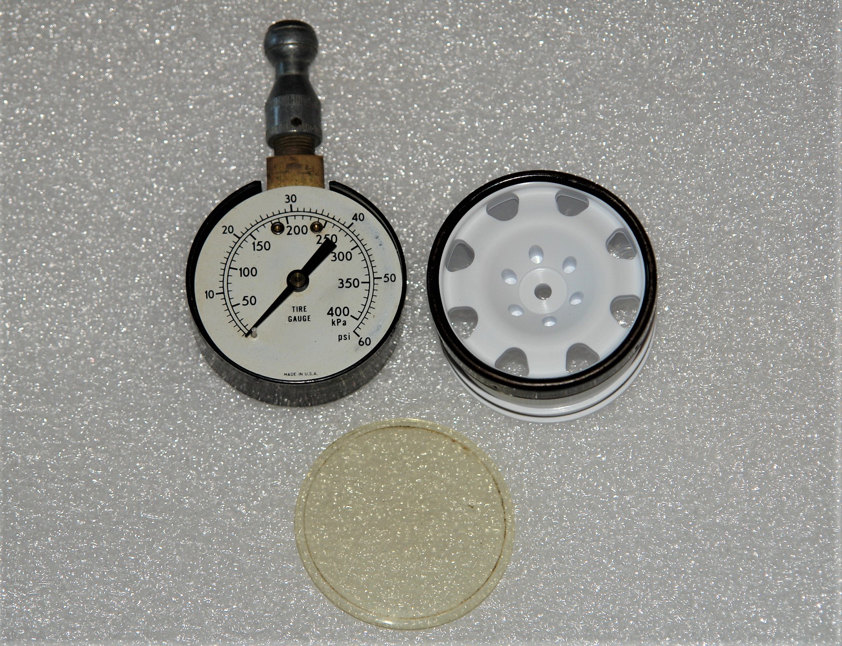

Just remembered I have a couple earlier pics of how I masked the outer rim portion of the wheels.
Looking around I found an old tire gauge.
Taken apart
And it fit the wheel snug. I did use an oring between the metal trim ring and the wheel for just a bit more protection.
Then off to be sandblasted. I just used the media I have, 80 grit coal slag.
Pretty aggressive but I backed off about 10 inches and that was just about right.
Chuck

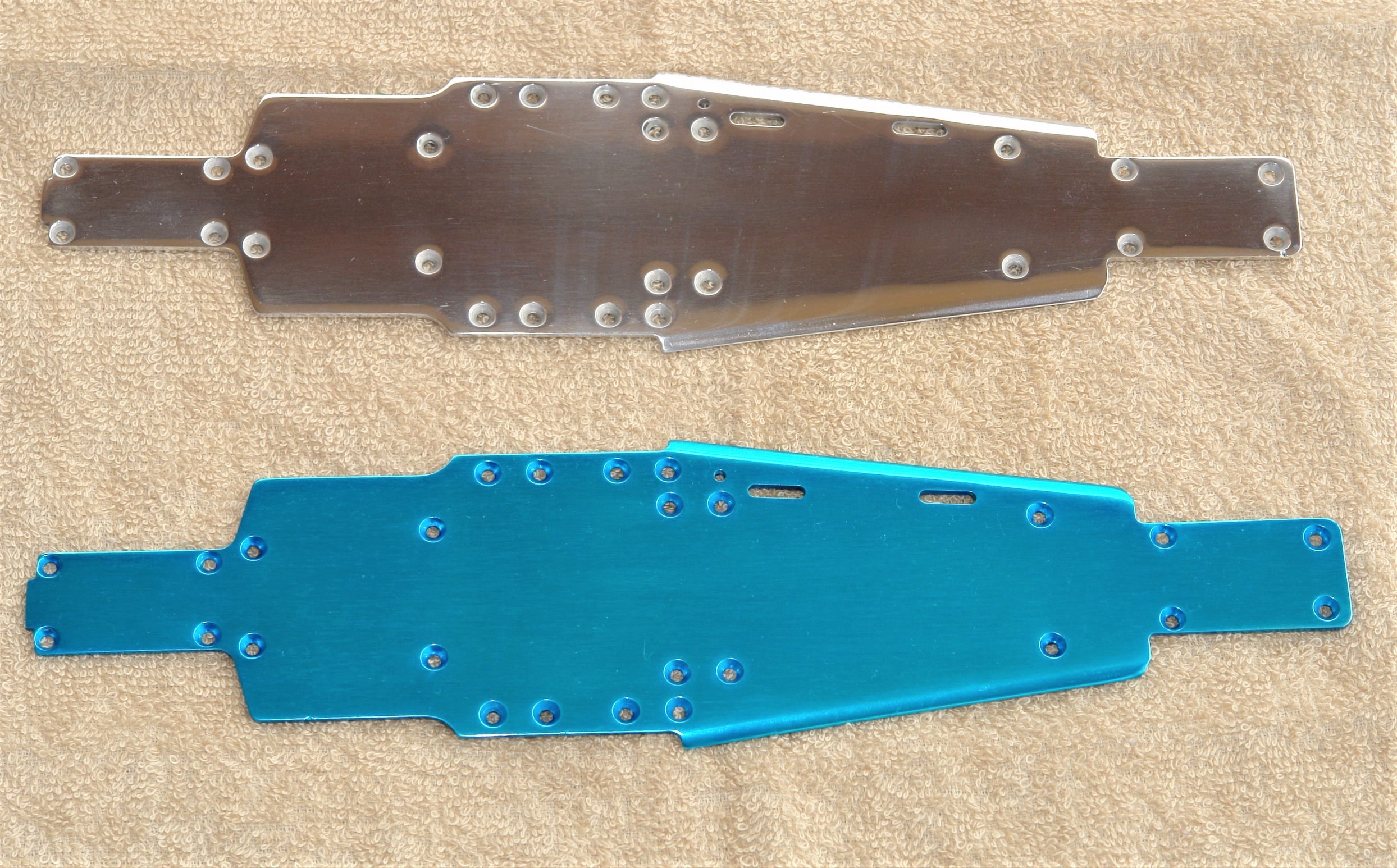

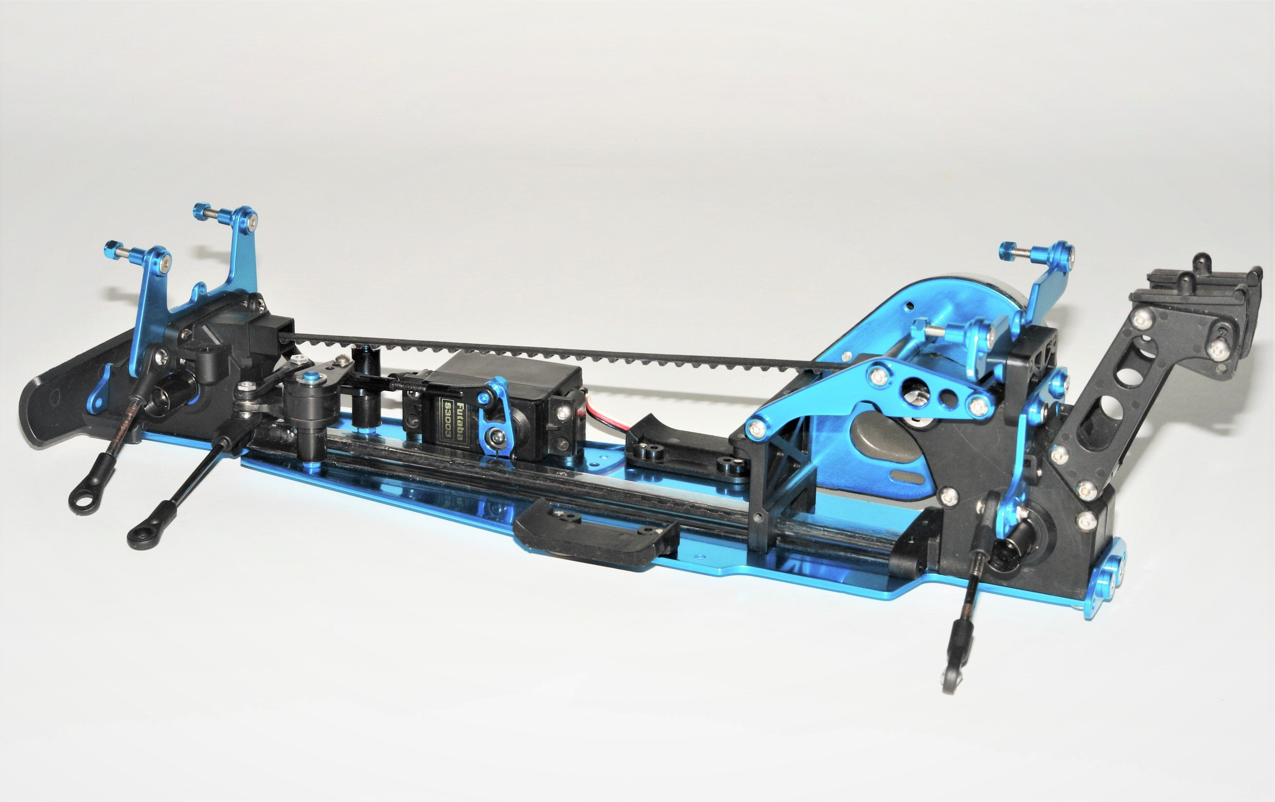

About time to update this thread :D

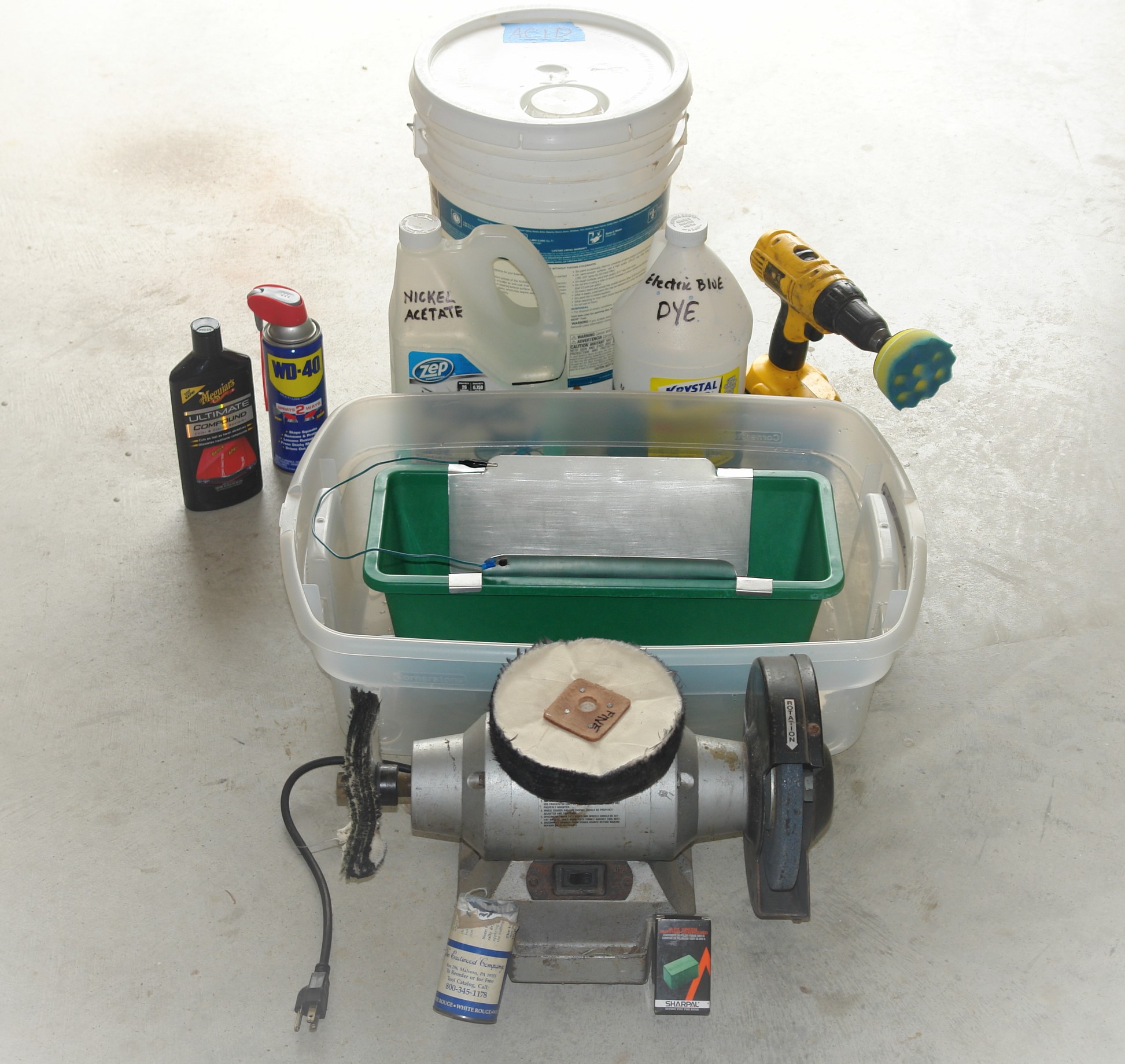

I've gathered up a few items that I needed to finish the chassis for the car.
The most important piece of the puzzle was the "tank" for the anodizing bath.
I found a fiberglass planter box that fit my needs and is impervious to the sulphuric acid bath.
Made new anode plates and a gallon each of acid, dye and nickel acetate sealant.
Also picked up 2 new super soft buffing wheels and some extra fine polishing compound (green).
Being that I polished the chassis a year ago, a re-polish was in order.
Aluminum starts to oxidize immediately after polishing and I did not want to risk an anodizing failure.
The chassis did not look bad but just a precaution.

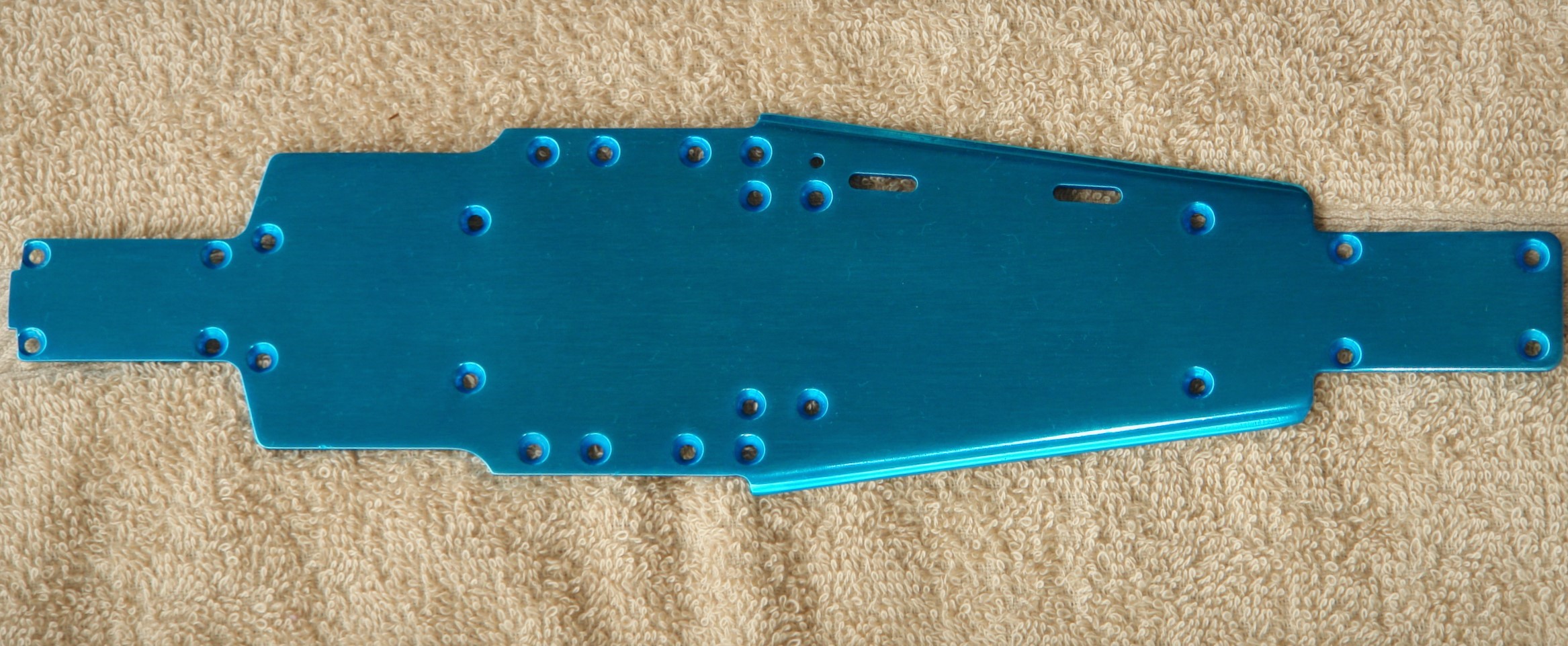

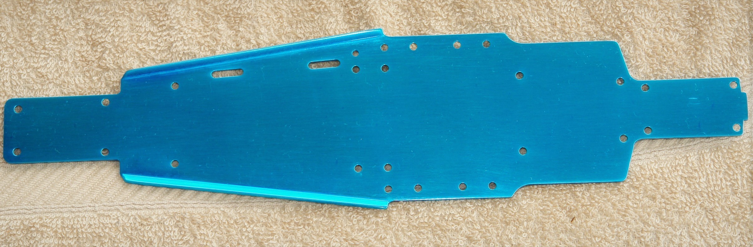

After a few hours of buffing and cleaning the chassis went into the ano tank, the dye tank and into the sealant tank.
Then it got a thorough cleaning and a light coat of WD40.
Although the pics don't show how the anodizing really looks, I'm pretty darn happy with the results.
I took a completely different approach to the anodizing and it paid off very nicely.
Usually it might take two or more attempts to get a really nice result, I nailed this in one take.
Colder acid temps, higher voltage and lower amperage.
I still have one more chassis to attempt but that might be awhile.
Chuck

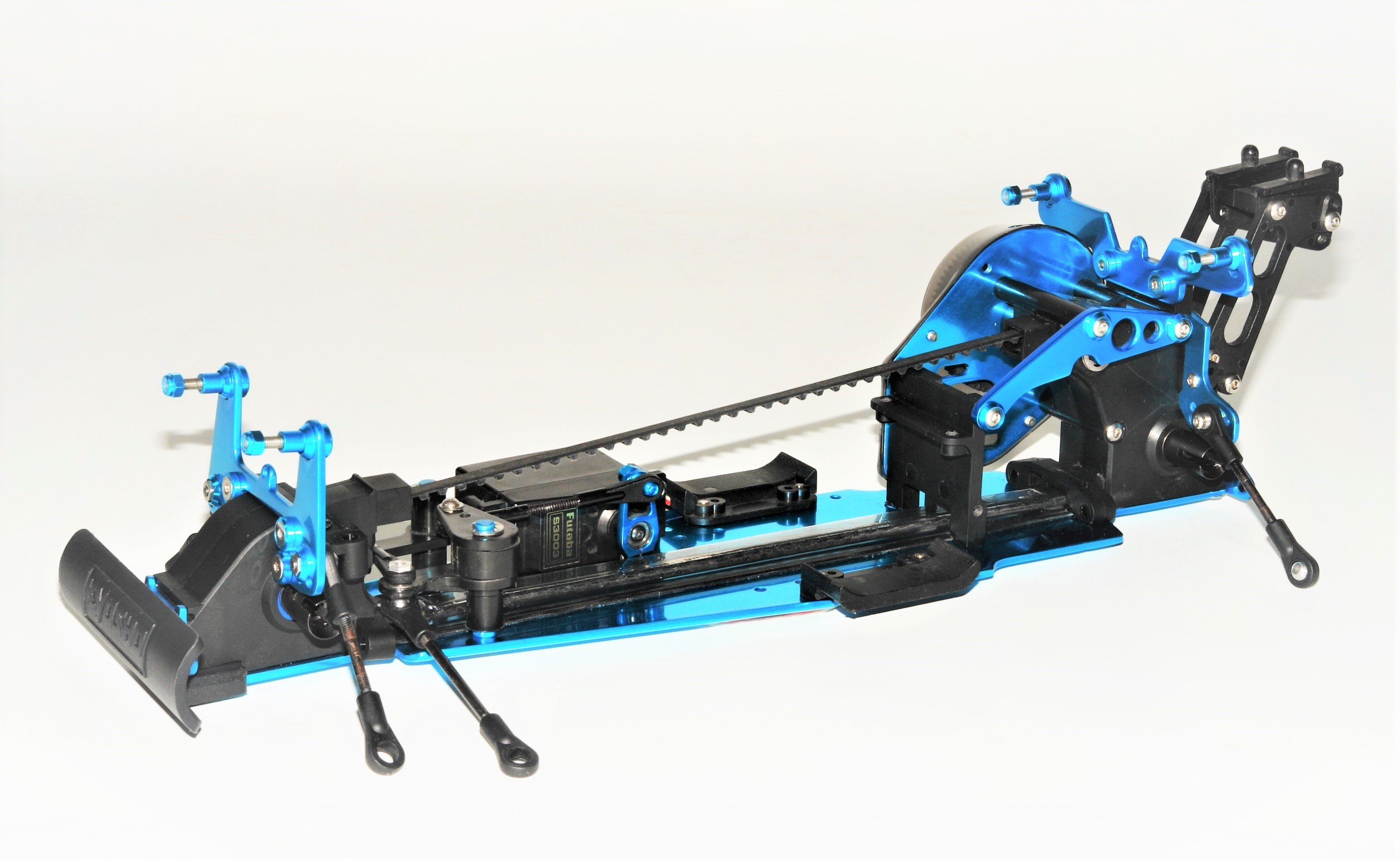

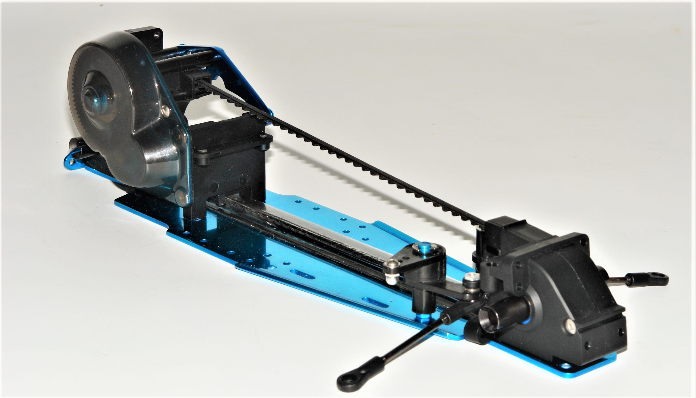

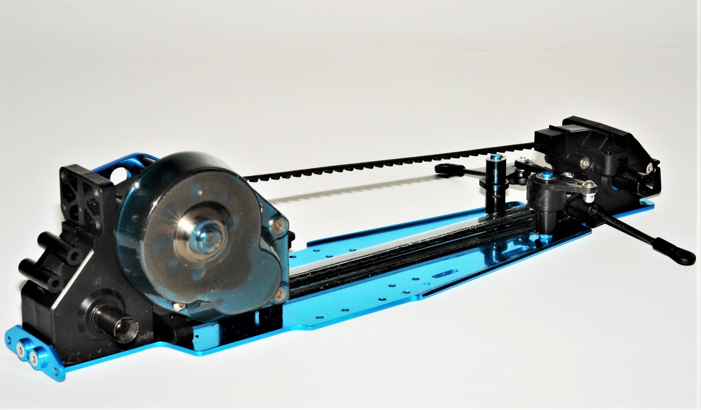

Time to start the build finally.
Going good so far.
These pics show the chassis anodizing way better than the previous pics.
The pics above were taken outdoors under cloudy skies and it is usually a good time to shoot shiny objects. Not so much with those pics.
Chuck

Cold and rainy today.
Great day to get on with the build.
Tried to mount a Savox servo but the orange name plate was just too much so I went with a black Futaba.
Really like the way the servo arm turned out.
I even went ahead and mounted the servo saver on the correct side :oops:
Chuck
