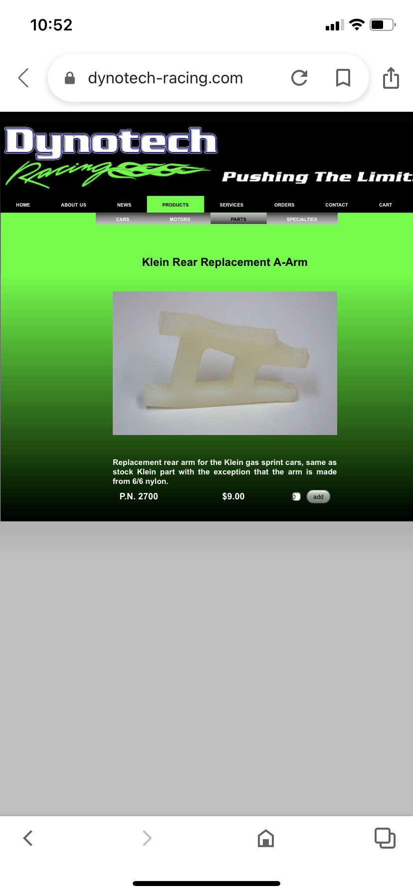

Related to this thread one part noted frequently is the
2700 Klein Rear Replacement A-Arms available here:
https://dynotech-racing.com/partDetail.php?RefNum=2700
I sent them An email for dimensional information a while ago but did not get a response specifically want to know how long they are end to end down the middle. Does anyone know this info?
Also are they sold as singles or a pair? It’s hard to tell
I assume as singles?
Appreciate the help!!

Fronts - 69.5mm end to end. 61.5mm pin to pinBACK_AT_IT wrote: ↑Mon Sep 27, 2021 12:55 am Related to this thread one part noted frequently is the
Rears - 71mm end to end. 64.5mm pin to pin.
Sold individually. Require some dremel work to get things to fit right.

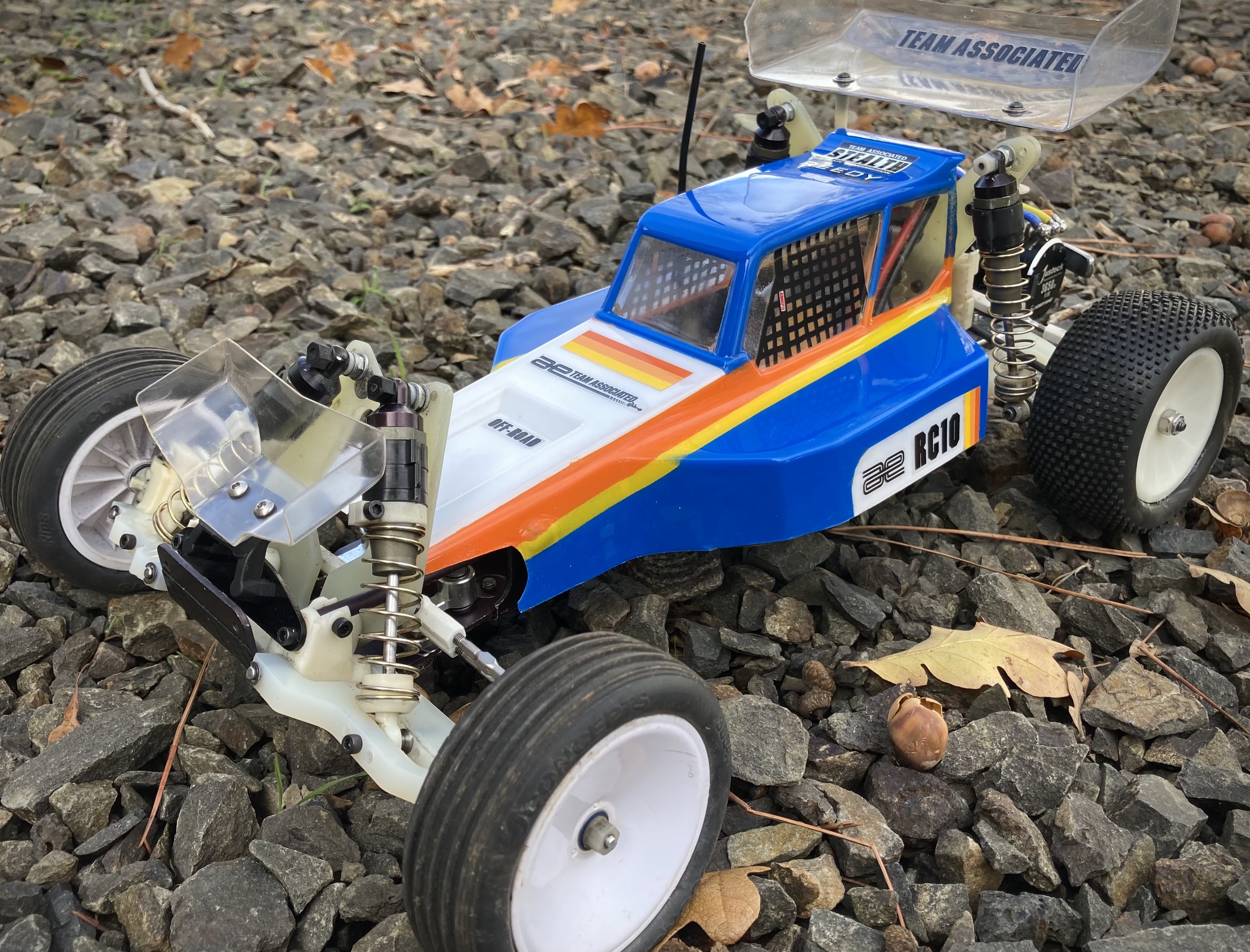

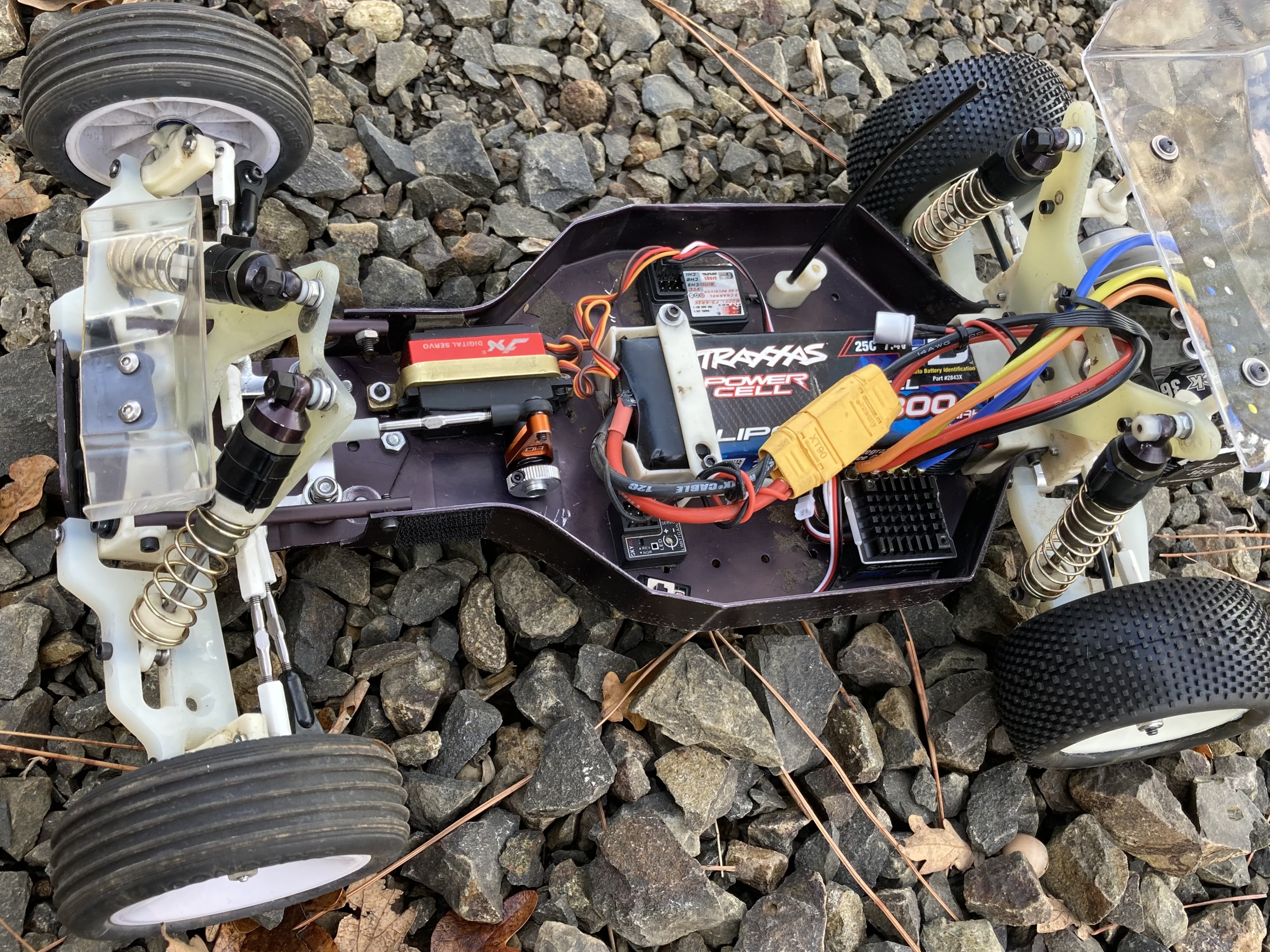

This started out as an RC10T that I raced on carpet when I was 10 years old. Fast forward 27 years and I’ve gotten back in the hobby (after a 20+ year hiatus) and decided to convert it to an RC10 buggy. Then I was made aware of the WOIN (what’s old is new) approach
FRONT END
-Dynotech Klein arms
-RC10T nose plate, bulkhead, shocktower, shocks, steering knuckles, and axles
-Hot Racing servo saver horn
-Dhawk aluminum bell crank (had to do some filing to take slop out.)
-JConcepts RC10 classic front wheels
-JConcepts Rips 2.2" tires
REAR END
-Dhawk aluminum rear arm mounts
-RC10T hubs
-B44 CVA’s and axles
-Traxxas Bandit rear wheels had the perfect offset to bring the width to 247mm (250mm is the legal limit)
-Raw Speed RC SuperMini 2.2" tires
-RC10T shocks shimmed 7-8mm under the shock piston to decrease droop
BODY
-Rear wing mount utilizes RC10T body mount brackets, and front body mount risers (with the nubs ground down a bit and drilled to accept screws going down into them), and a custom made 16 gauge steel brace.
-The front wing is for a new Losi buggy’s mounted on a custom made 16 gauge steel brace/mounting bracket with an angled shim.
ELECTRONICS
-JX low profile servo
-HW justock 17.5t motor and xr10 esc
-Traxxas soft battery fits in stock battery tray
-Jconcepts Detonator body
MISC
-Lunsford Racing titanium turn buckles
-RPM ball cups
-Teampiccomx RC10T chassis skin off eBay
-custom made steel rear bumper
