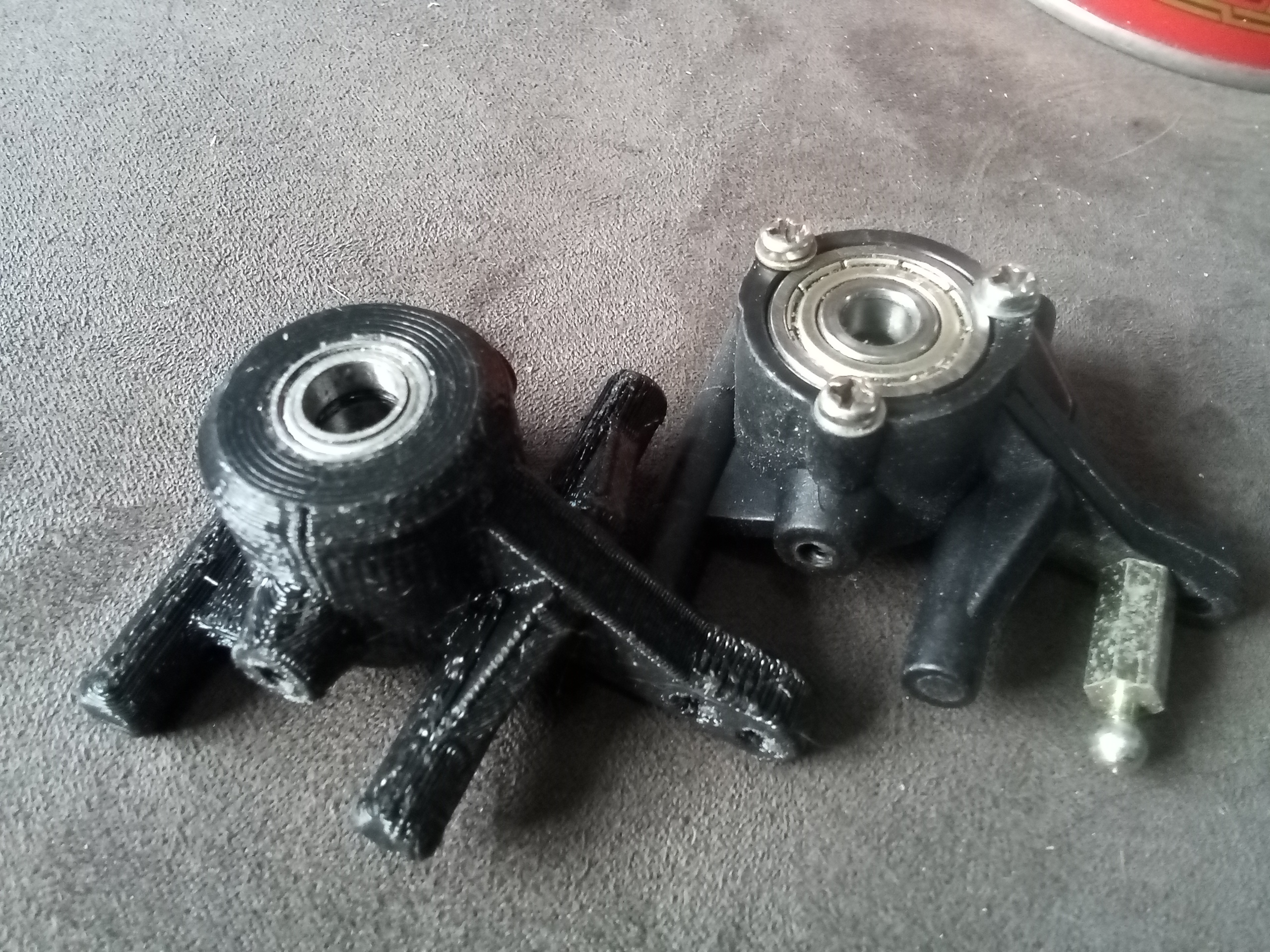

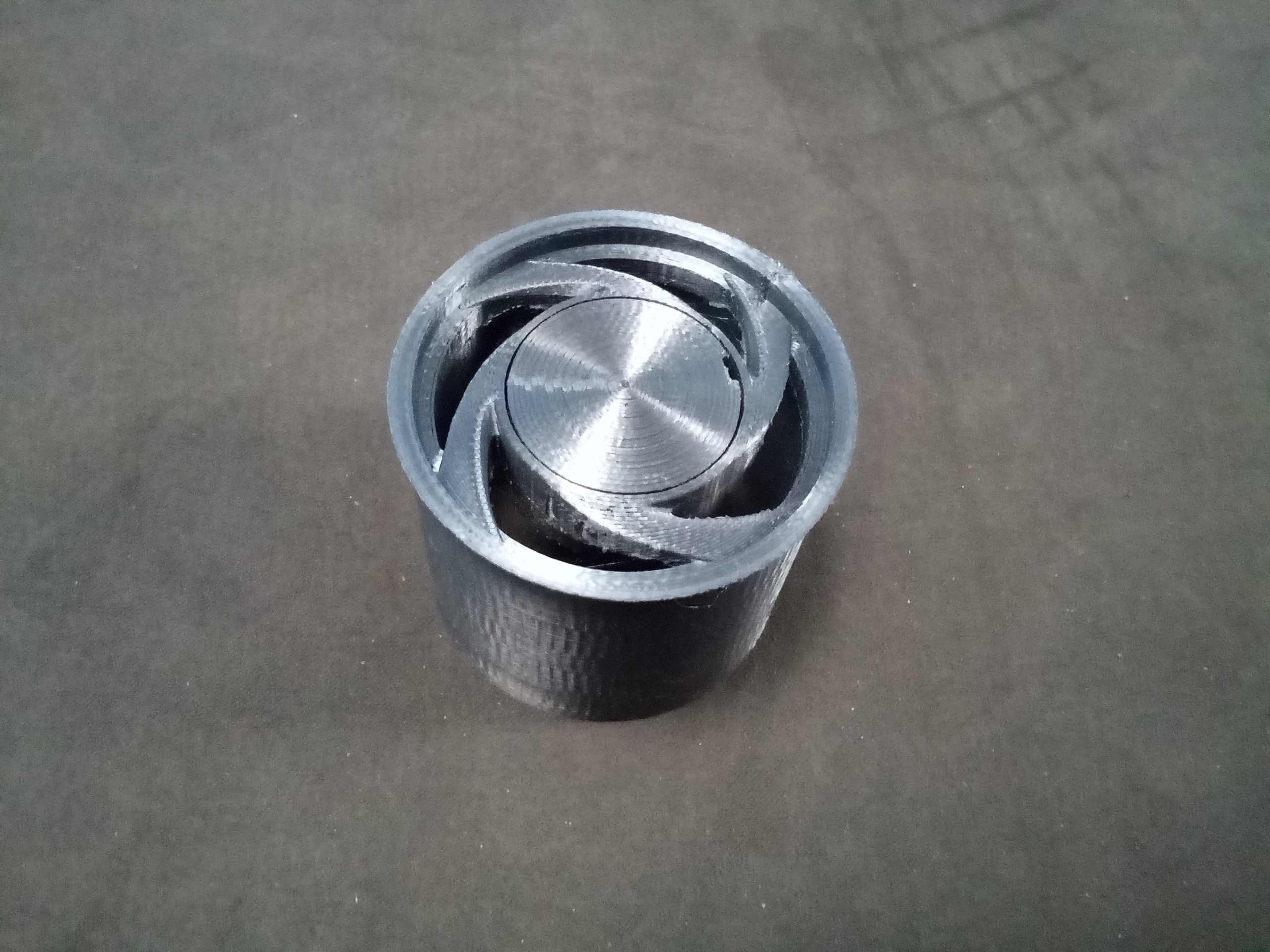

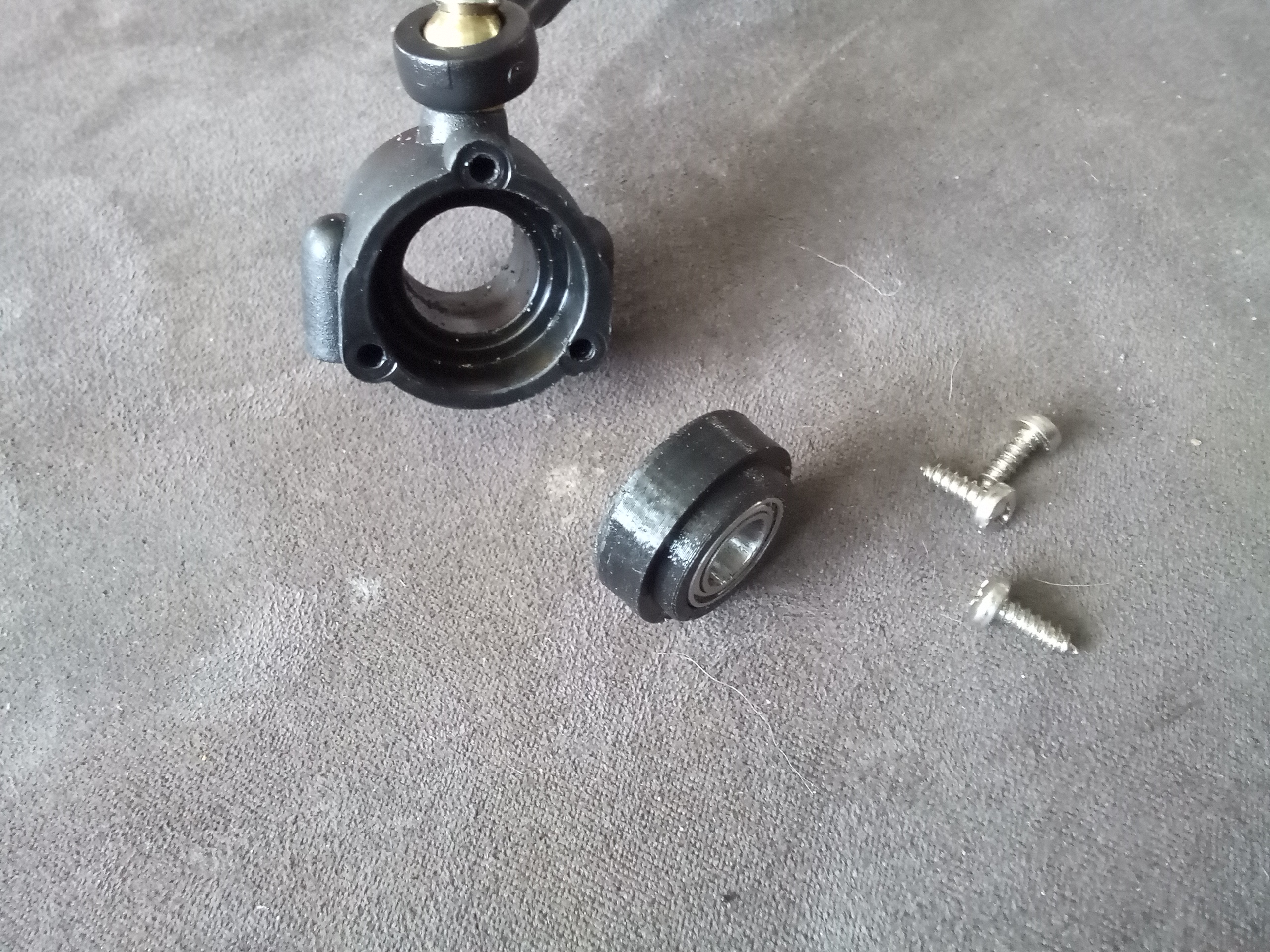

Printed these test pieces last night , they are the front and rear hubs for the SG Tag Coyote with the double bearing mod inbuilt , I don't have any 5x10x3 bearings but I was able to test the fit with some 6x10x3 bearings , all fits well so I'll pop these up later as well as the bearing adapters , these are just printed in PETG and look awful and are to weak to use , I'm just using up rolls of crap filament for test purposes .
Here it is next to the big single bearing original . And
The rear one.
The rear one.

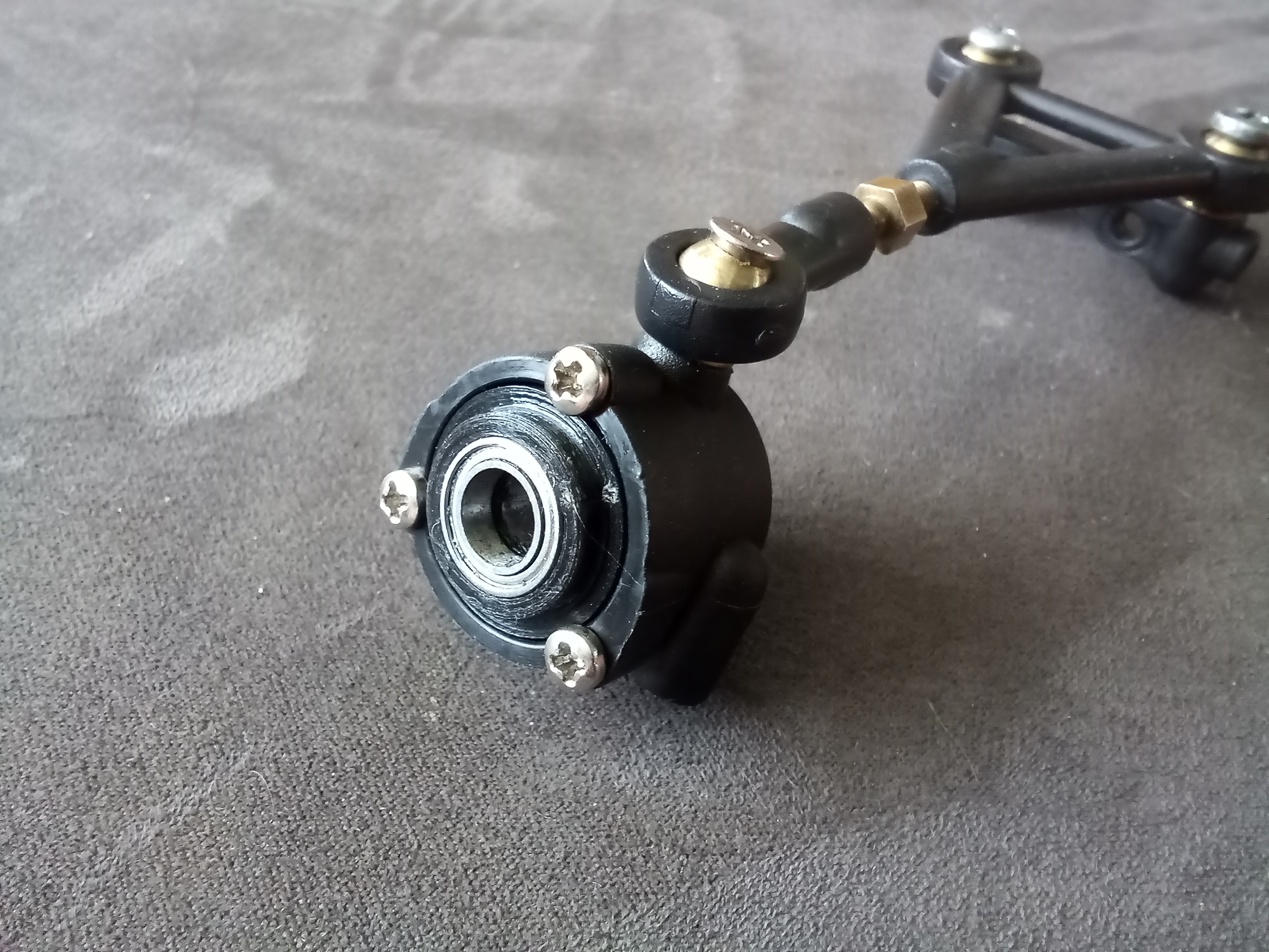

Re: Dadio's 3D Printing Stuff

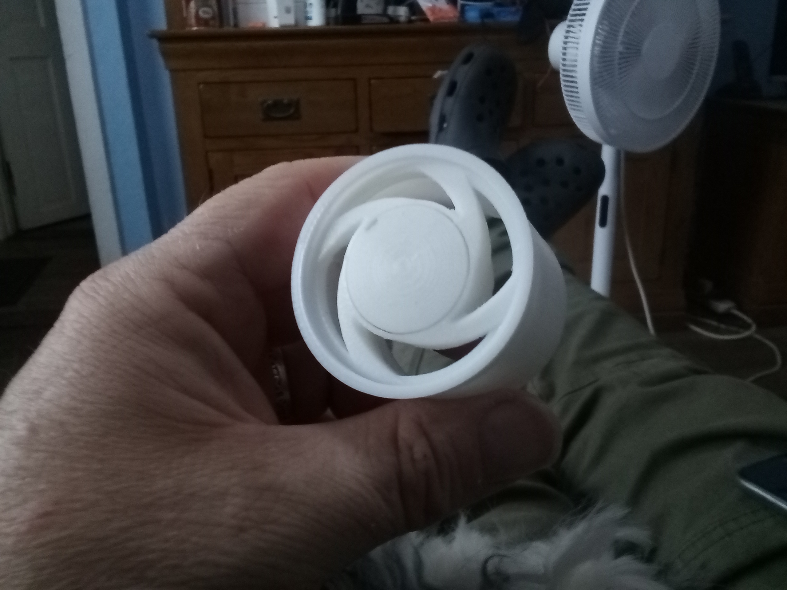

This is the double bearing adaptor for the coyote , works well so it's going to be added soon .
It needs two 5x10x3 bearings per wheel .If a jobs not worth doing then its certainly not worth doing well.

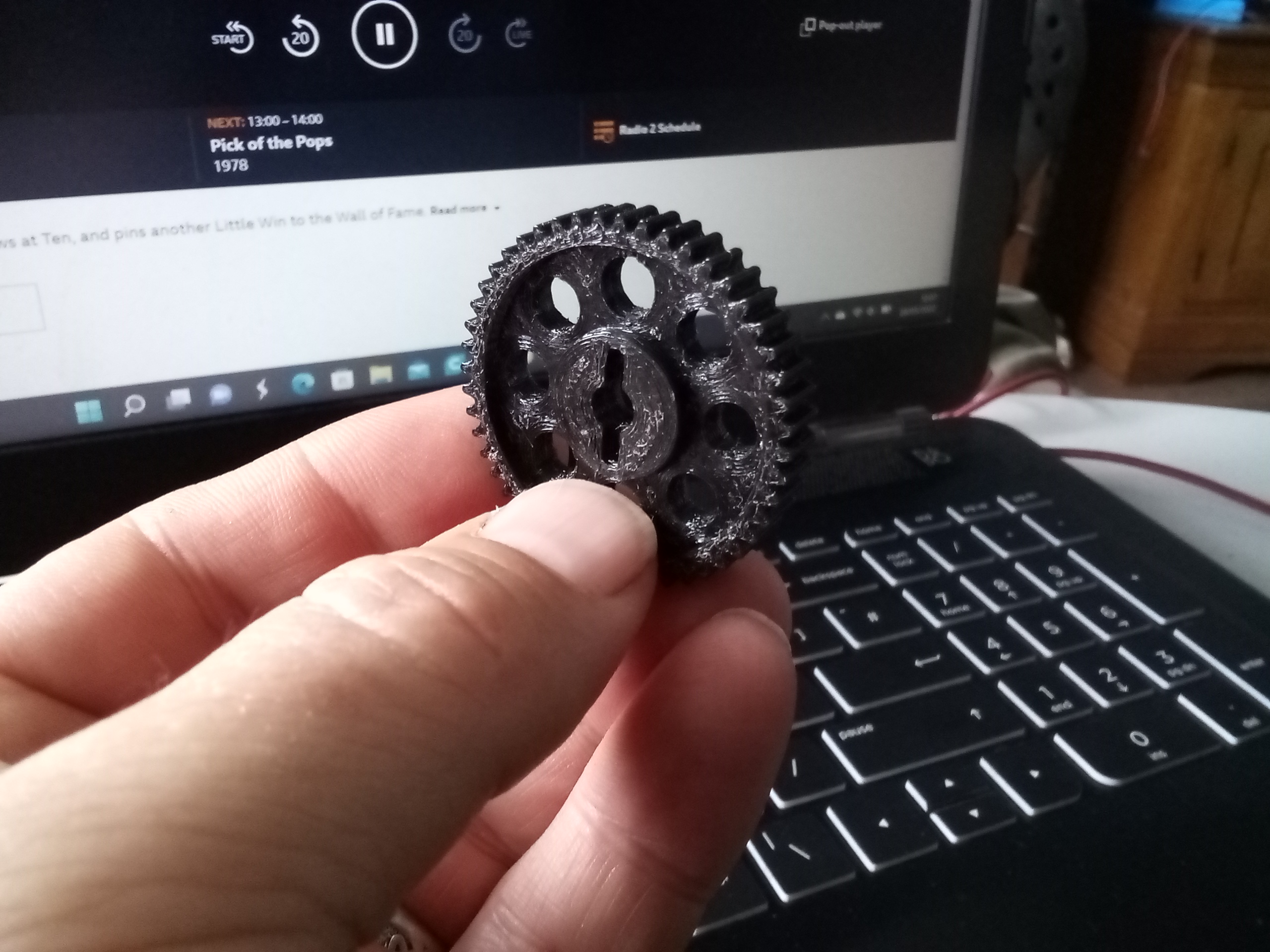

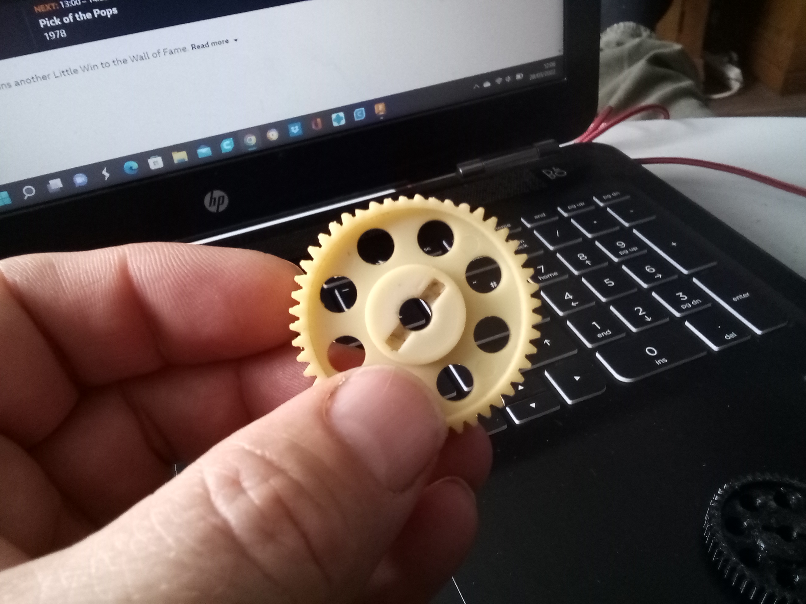

Finally got round to the much needed spur gear for the Coyote , all the gears I've modelled so far have been 0.8 mod but every time I use the gear generator in Fusion 360 they come out bigger than the original gear in my hand and they have to be scaled down a few % to match , it happened with the Dogfighter as well as the Coyote , in fact I have several sets of original Dogfighter gears and none of them are the same size as each other
But none of them as big as those generated in Fusion , if I print the Dogfighter gears at full size the gears bind badly , I tried checking if they were actually a DP gear but the equivalent DP gear is the same over size compared to original parts , I'm thinking that maybe the gear mould is accurate but the nylon shrinks causing this size difference , it's the only thing that makes sense to me .Oddly modern gears are spot on the same as the Fusion 360 gear generator and this causes problems with the Coyote as the modern full size gears just brush the lexan under plate on the Coyote , its not enough to do any harm but enough to mark the lexan slightly
My original chewed up gear . Test printed gear

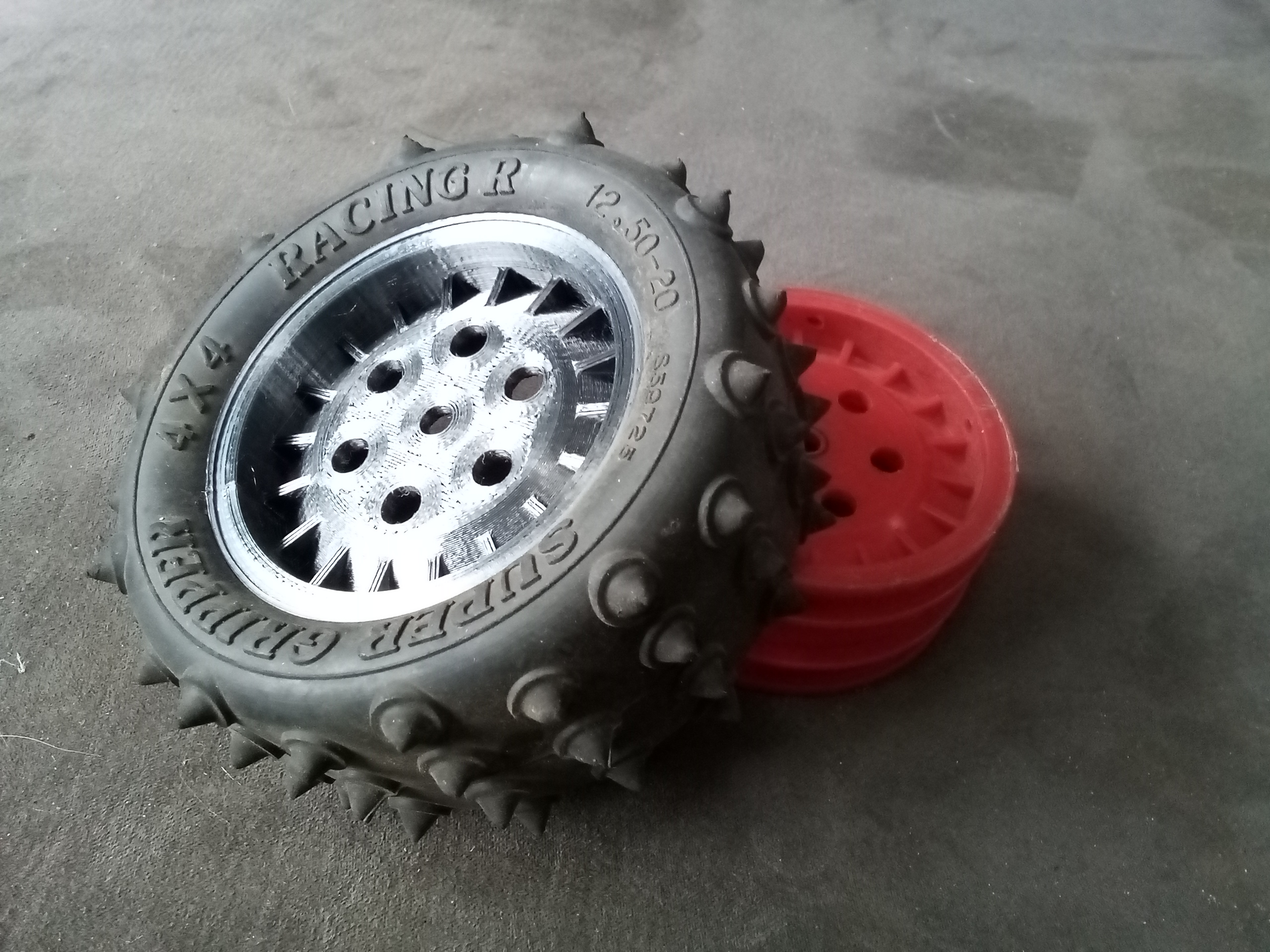

Just got this off the printer , same wheel in grey silk PLA , need to add a fillet to the rim then I'll stick them on Thingiverse .
What a great looking wheel!! At first glance, I thought it was turned aluminum.

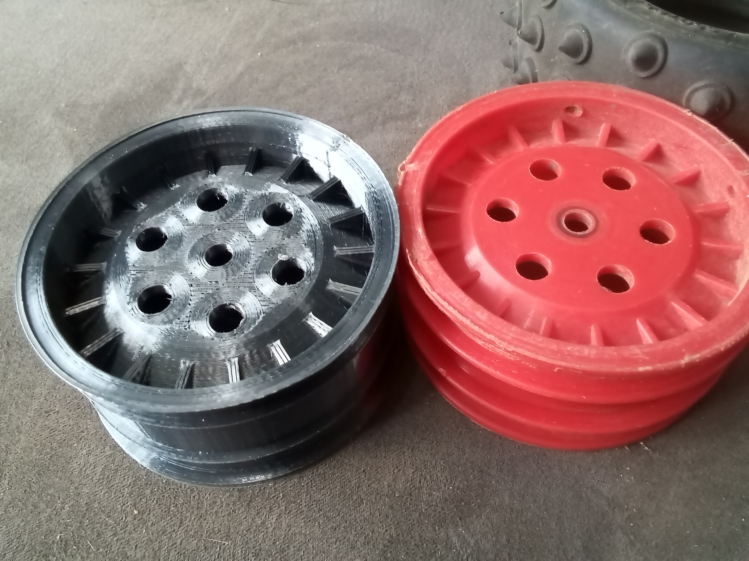

Started modelling the Mini Mustang , got a wheel printed , looks nice , somehow I made it too deep but easily remedied .
