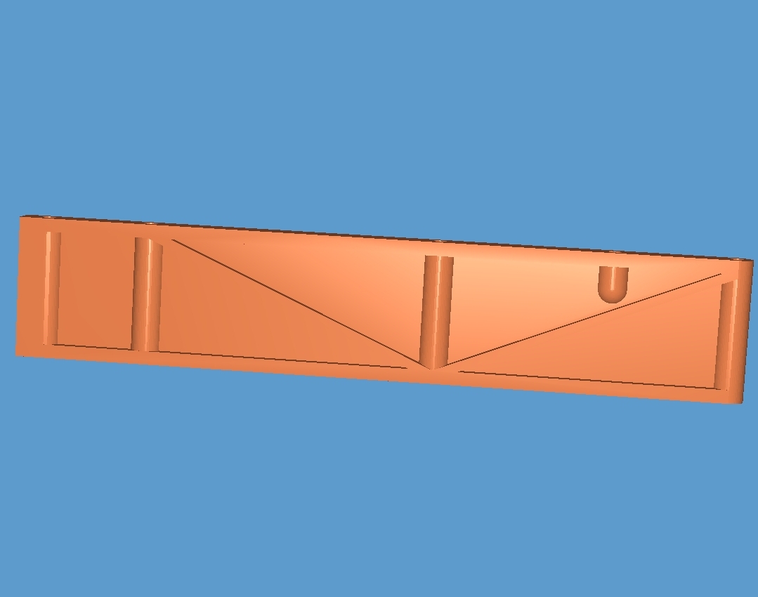

Thank you for the replies. The other part is on Thingiverse, so I guess maybe I could use TinkerCAD to modify it. I put a .STL viewer on my phone. That's pretty neat.

Looking at the part, it looks quite easy to model... And a nice start to onboard within 3D design with Fusion360...
