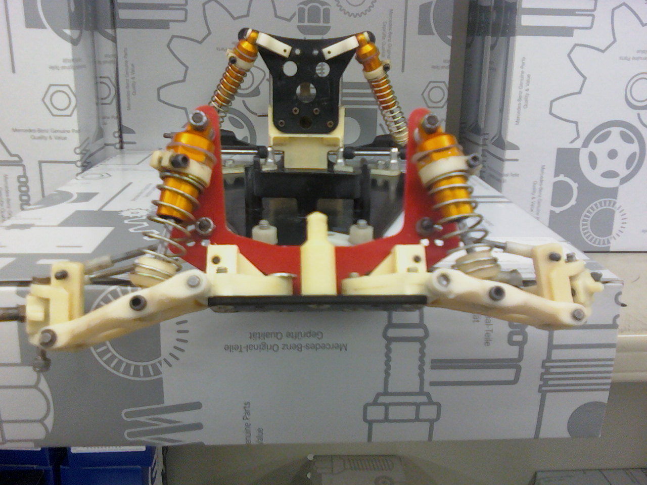

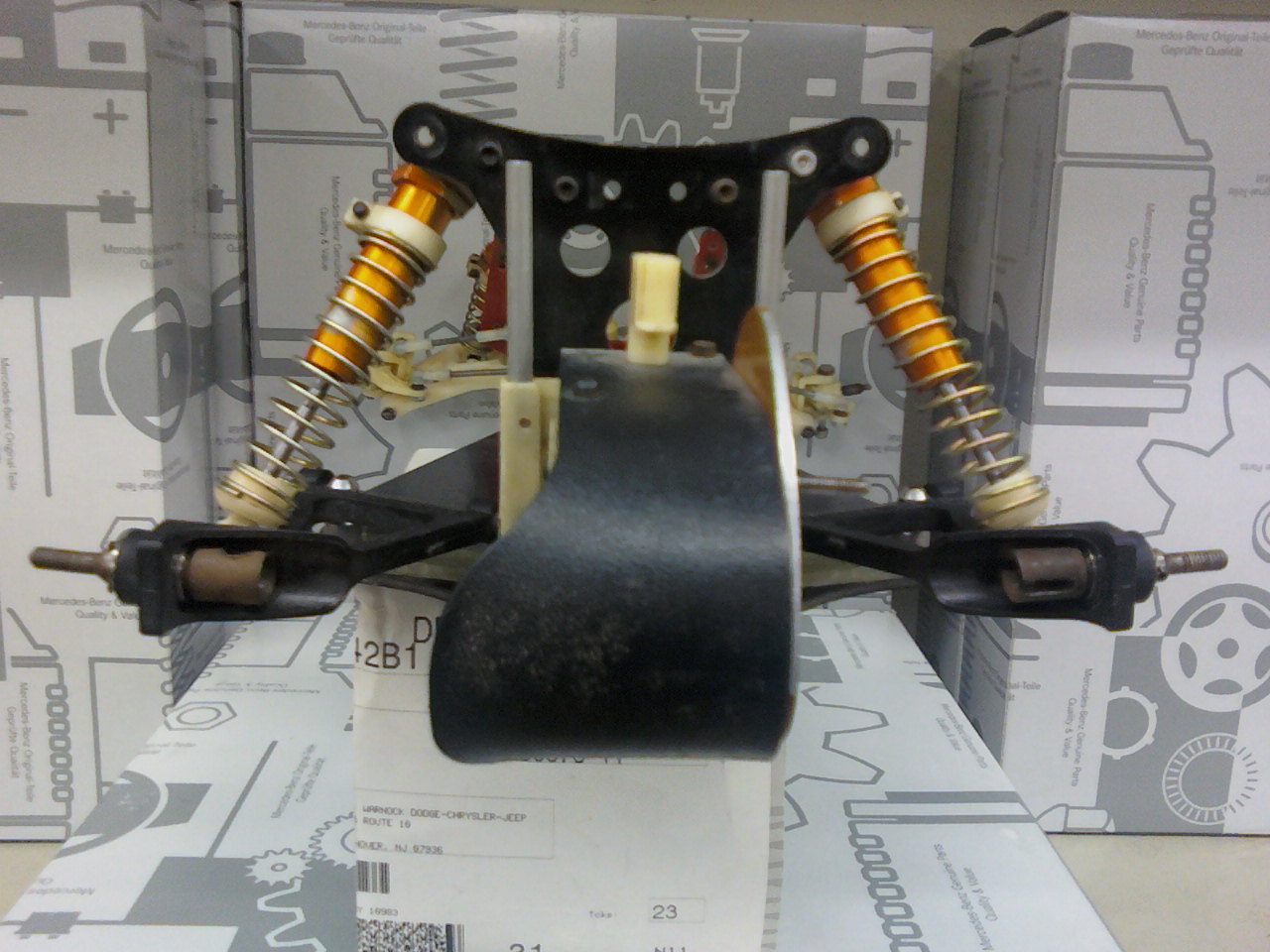

Pics of the chassis.
I should have chose a better angle on this one, maybe a bit more overhead.
Posts: 16816
Re: Houge RC10 Info
a shot from the top or bottom would've been nice. but going by the a&l motor guard, arm mounts, shock mounts, shock tower, and the roundness of the chassis by the rear arms, i'd say that it's definately an a&l chassis. but mounts don't seem to be in the right spot. are there multiple holes in that area? does a battery even fit in the bulkhead with the mounts in front of it?
i'd find a pair of a&l rear arms and be done with it. :wink:

Just an observation- it doesn't look like you have enough downward travel in the rear. If the lower spring mount hits you could try B44 mounts. They will raise the spring away from the point where it mounts to the arm.
Posts: 16816
Re: Houge RC10 Info
JHarris wrote:Just an observation- it doesn't look like you have enough downward travel in the rear.
it would if it had a&l arms on it. :wink:
plain and simple, he needs to have the correct parts. he doesn't, and it's causing problems. i still want to see a pic of the bottom, though.
