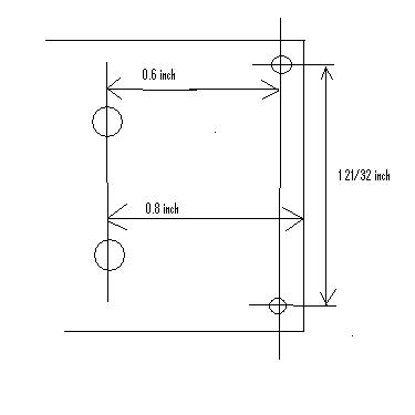

OK that's a good idea but I will indeed need dimentions and location of the holes as I don't have a graphite nor a GT chassis. The other think I need is the lenght of the plate from the suspension arms to the end of the rear. We based ours on the sassis chassis and therefore it may be too short or too long to allow for a match between the added piece and the motor plate.

pardon the crappy paint drawing.
from center of rear most transmission holes to edge of chassis is 0.8"
from center of rear most transmission holes to center of bumper mount holes is 0.6"
from center to center of bumper mount holes is 1 21/32" inches. that's 1.656". If I am not mistaken, most of the dimensions for the rc10 are in decimal inch, not fractional, so this dimension may very well be 1.65" I used a machinists rule, but it's hard to see 6 thousandths by eye between 2 screws with no finer tick marks to make the decision.....

Re: New Design chassis in plan UPDATE 21/02/10
Are the holes for the motor guard offset on the graphite chassis? I know they are on the RPM molded chassis.
the chassis i have is a composite craft or trinity, or something similar, they all looked pretty close, and I would never be able to tell you for sure.
the hole look like they are pretty close to on-center, the back of the chassis was rounded off at one point, making the measurement difficult. I measure maybe .020" difference, which shouldn't be significant.
how far offset is the rpm chassis?
It is approximately .100" to the right or spur gear side
Hey JWscab I need a precision regarding your drawing. The rear most tranny holes you draw, those are the large 6 gears tranny ones right not the stealth ones? Thanksjwscab wrote:pardon the crappy paint drawing.
