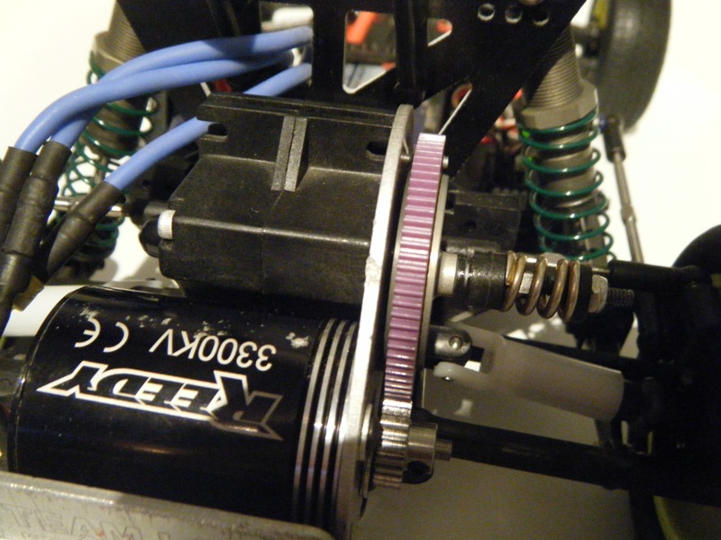

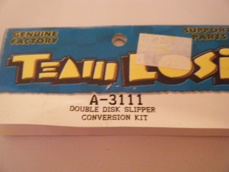

As a side, I installed the kit for a XX A-3111 dual disc slipper, fit right onto my single slipper shaft so now spurs are a piece of cake.

is that 3300kv associated motor equivalent to a 17.5 turn? I am thinking of picking up that eraser combo but in 3900kv.

KV matches a 13.5, but most local tracks to me allow it to run with the 17.5s, they say it isnt all the fast (like a good 13.5)

I agree its probably between the two in reality. On soft throttle profile on my ESC it is closer to a 17.5 but on the hard throttle profile it is for sure faster closer to a 13.5. It's not a bad motor for what you can get them for taken new out of all the RTR's.
