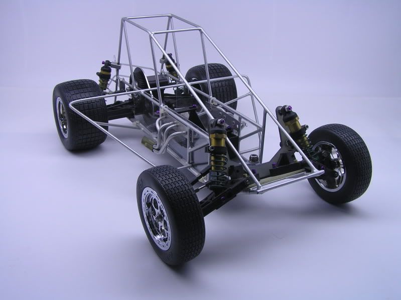

Ok im in an update mood today lol

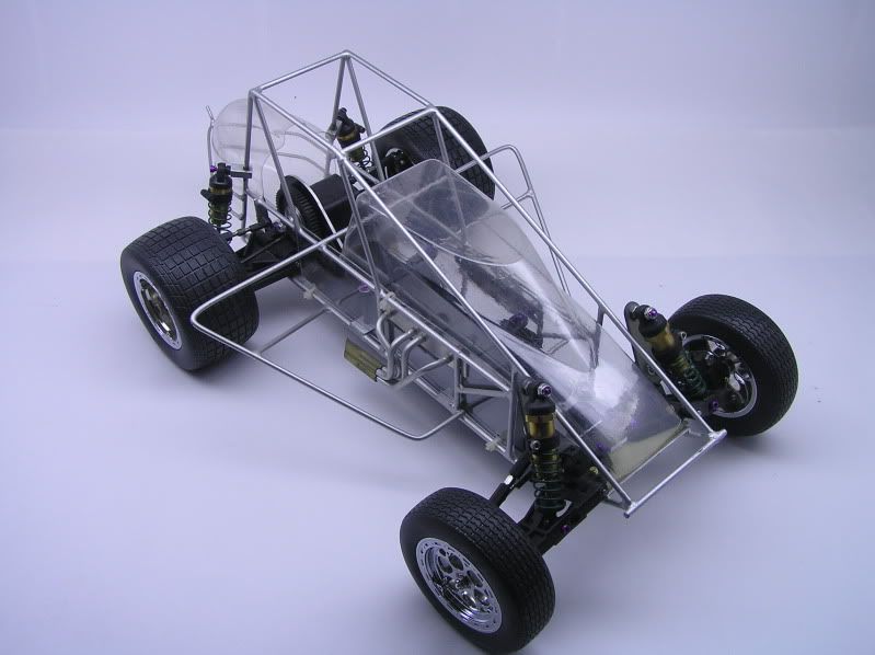

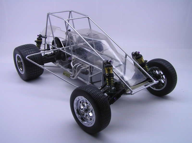

B&R Sprint car update...

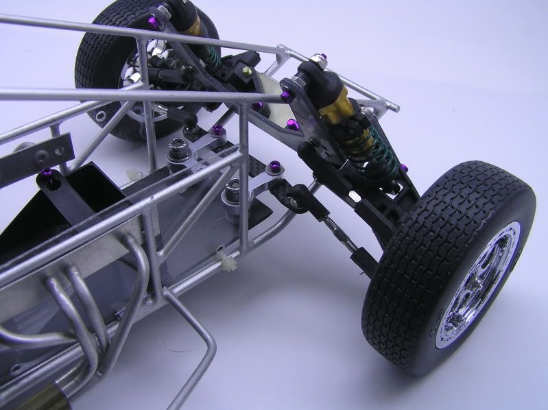

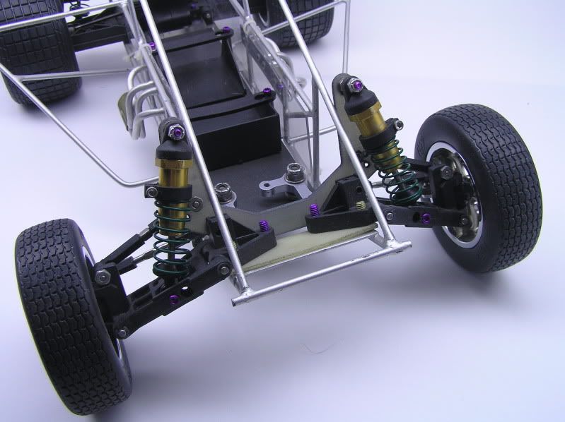

I built a graphite lower chassis plate and created a steering system from a hacked up Losi bellcrank and a A&L cross bar, I think i will change to the original steering setup when time is available.
I still have to add the top wing and figure out how the front wing mounts lol...
PS That is the second front tower i tried to dye lol, i must get all the towers that will not take dye :( but its cool, i have some plack towers on the way lol

Good Lord , that thing is SHARP !
Rat
I thought it was supposed to be ..... FUN !
Asso_man!
Posts: 3960
Location: EU
Has thanked: 40 times
Been thanked: 82 times
Re: RC10 B&R Sprint Car (Project) (02/18/12)
Post by Asso_man! »
Looks good, but I would use 0.56" shocks in the front instead of the 0.71" you have right now or change to a 6 holes front shock strut. Keep up the good work!

I just used the shocks i had on hand, Id like to swap them out for some original bottom load shocks, I cant tell what shock is what size lol, i posted a thread asking how to measure AE shocks but got no reply's :(
As far as I know/can tell, the number corresponds to the stroke length. .56 = just a little over a 1/2 inch stroke etc... I can tell just by looking at them after all these years though :)

A sprint car build is one of the concepts I've got imagined that I'm really eager to start work on. In fact, you could be of real help to me if I could get a couple of measurements out of you. Simply how tall the driver's cage is from the bottom of the chassis, and how tall are the side panels?
In exchange I can tell you where I figured out how to measure shocks. In the Dec. 1990 issue of RCCA, that I got out of the scans archive on this site, there's an article that has the useful dimensions of most of the popular shock brands from back in the day. While not the most up to date info, I've managed to pick up a good idea of what size shocks are what from the measurements in that RCCA article. However, if you want to get closer to Associated's official numbers, you can subtract the length of the shock while compressed from the length of the shock when extended to get a close approximation of the measurement Associated used to identify their shock shafts. To get Associated's length for the body you can do the same math while purposely using a shaft that's too long for the body.

Phin wrote: A sprint car build is one of the concepts I've got imagined that I'm really eager to start work on. In fact, you could be of real help to me if I could get a couple of measurements out of you. Simply how tall the driver's cage is from the bottom of the chassis, and how tall are the side panels?
Thanks for the info, Ill get you some measurements as soon as i get back in town, If i forget just shoot me a PM lol, I have a very short memory.

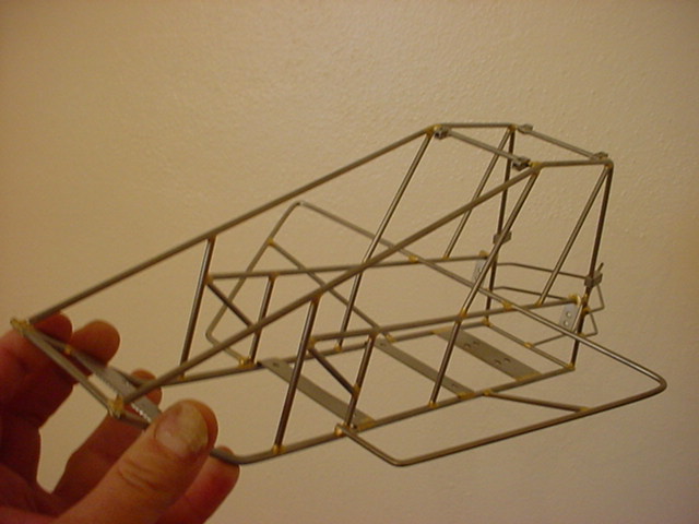

DUDE!! DUDE!! EGAD!! You just made my day! Man, I traded a bunch of parts for a mint one of these chassis about 15-20 years ago, & it's been just sitting there all this time. I suspected it was RC10-based, so after I registered here I glass-beaded the patina off, very pretty now, & was JUST gonna post a pic asking you chaps for info: I Googled it, and the result lead me right back to this thread: Man, it's like I'm destined to be here or sumpin'. :P
Dang, learned more in 5 minutes than the previous 20 years. That thing is as sharp as I thought it would be, maybe better! Now I'm all fired up seeing this. Soon-ish I'd like to do some nice wheels, shock towers, wing, etc. for it, if I do I'll letcha know if you're interested.
Was thinking of getting it chromed first if it wouldn't come apart, powder-coated if there's any risk on chroming. So, where'd you get the body, headers, etc? Dang, this is cool!

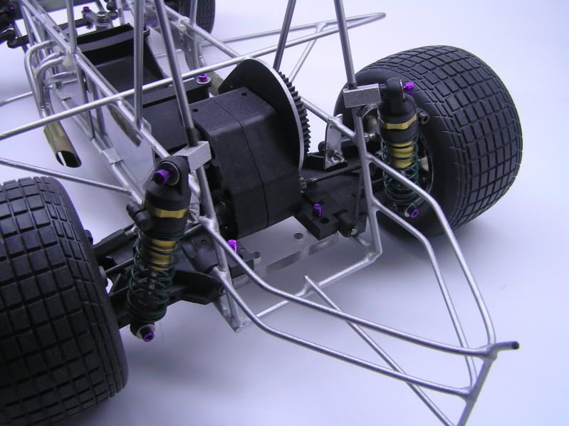

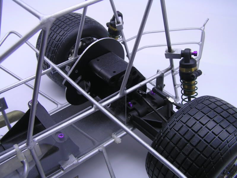

By the way, that nice rear end in the top pic: Any info on that? Very nice! Chris REC

I would not go the powder coat route, I looked into it and a member here that does it said the B&R chassis are brazed and it might fall apart in the baking process lol, Im not sure about the chrome route, I dont know much about the process...
