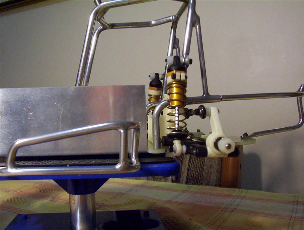

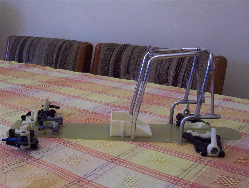

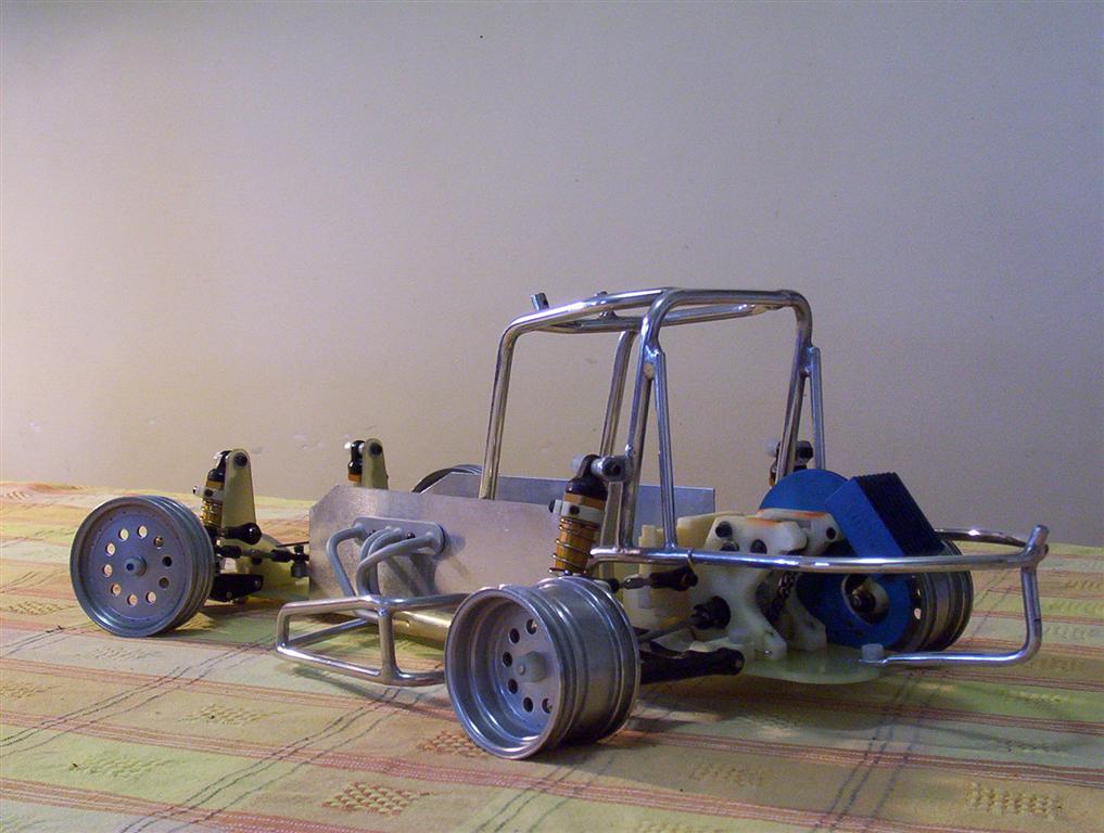

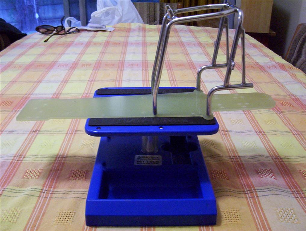

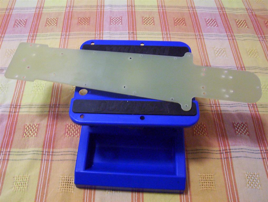

Hi Guys,
I had a win today a project I have been working on and off for about 5 years is now moving forward at
last.
One of the things I had to do was to make some recoils to repair some pulled threads in the
bottom of the roll cage.
Any way here's a pic, I waited for 3 years for this chassis to turn up on E-bay.
Cheers, Dave.

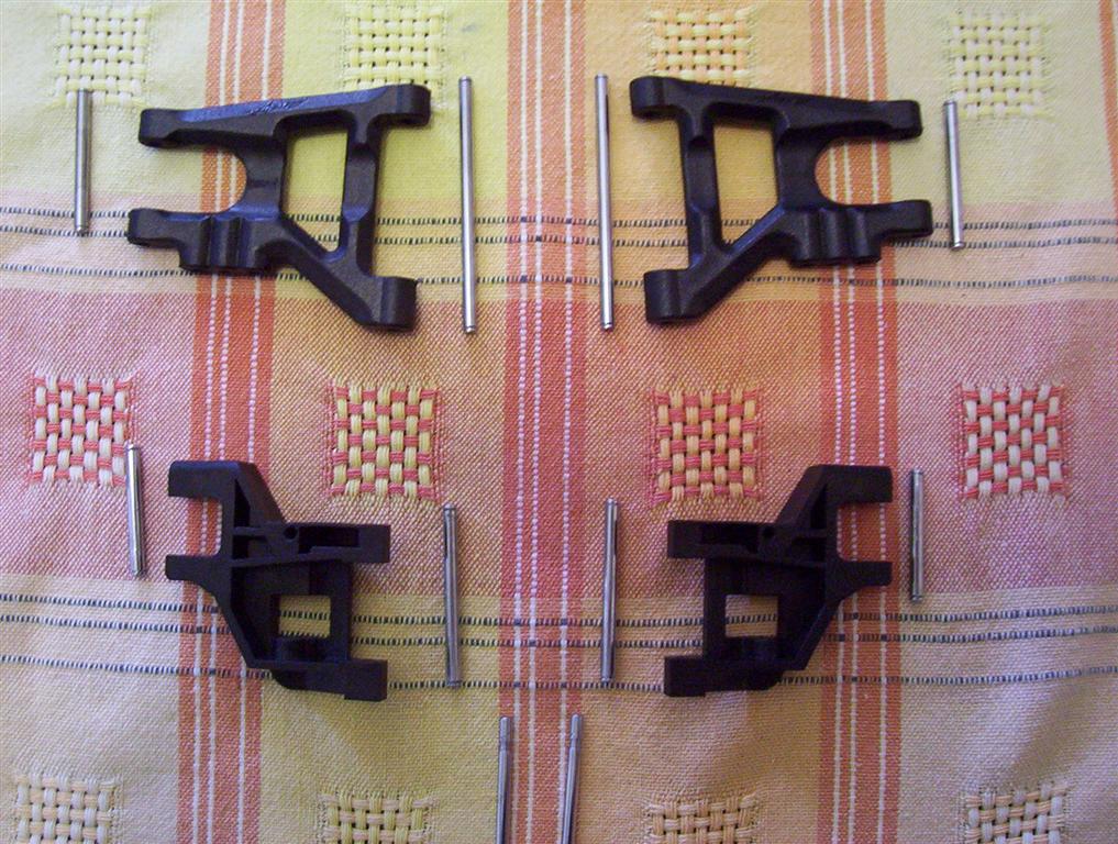

Hi Guys,
Asso-man, I have read about your Sprinter many times, I really like the tranny.
I had my first try at dyeing the suspension arms today.
The Andys rears came with the car and were already dyed black but were very faded, the fronts I
replaced because they had not been modified as I would have liked.
I did round the corners of the trailing edge of the arms as per the instruction sheet I found on this
forum.
Cheers, Dave.

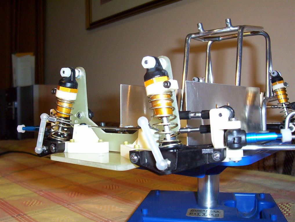

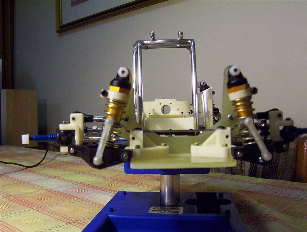

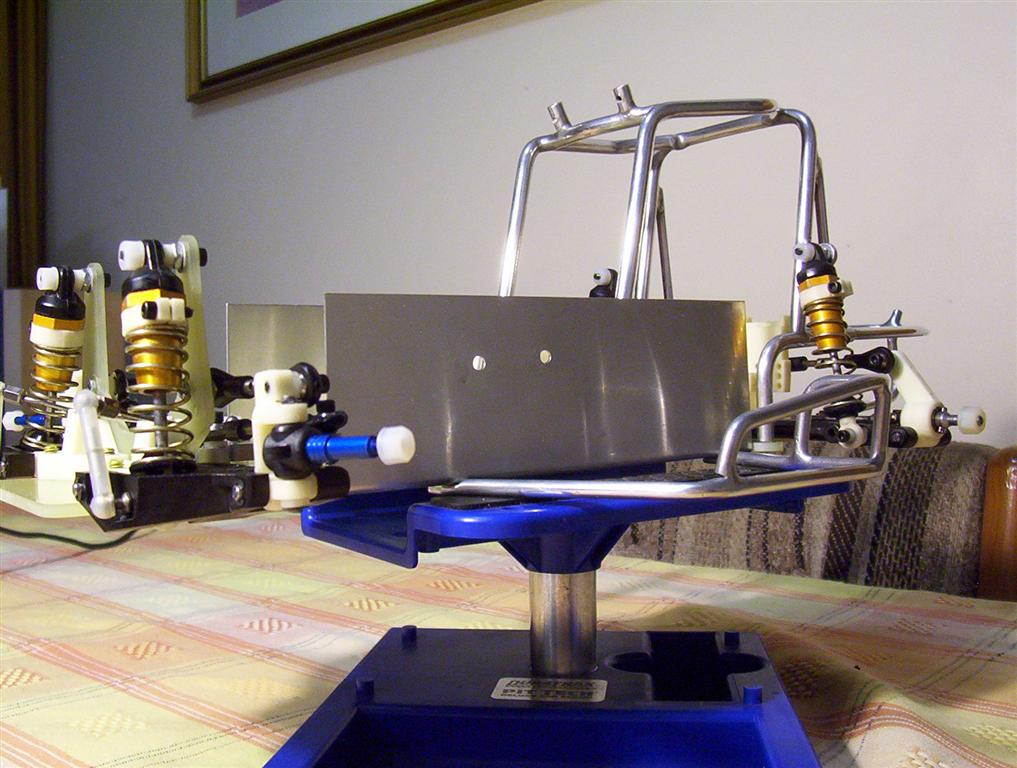

Hi Guys,
I really got stuck into my project this afternoon, I hope you like the pics.
I made some changes to the shocks, I am using white shock ends, black spring cups, white shock
clamps and black shock caps on the gold shock bodies to keep the black/white theme going.

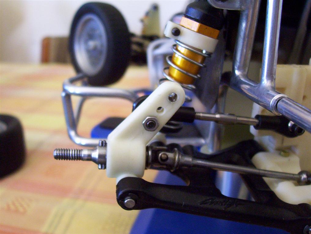

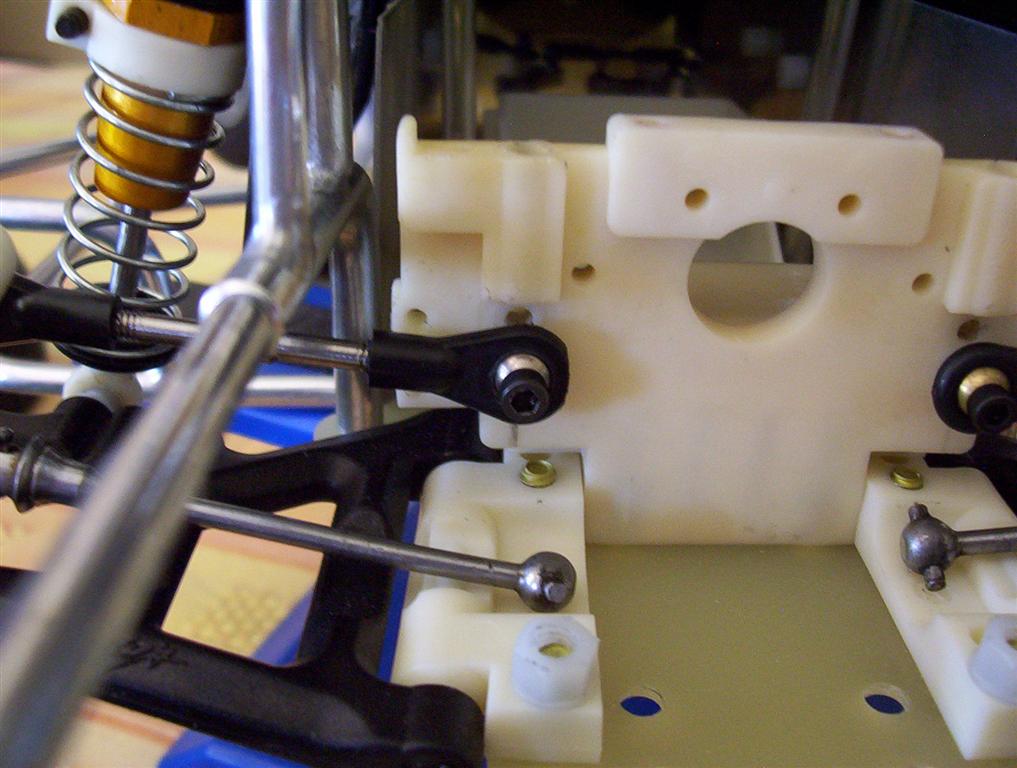

Hi Guys,
I did some more work on my project today, the camber links with .56 shocks on the rear were
directly below the rear roll cage so the rear shocks could not compress at all.
I drilled the rear bulkhead in two positions 5 mm apart below the worlds position, I also drilled the
truck rear hub carriers in two positions 5 mm apart below the original hole and now the shocks are
able to compress fully.
Here are some pictures of the mods.
Cheers, Dave.

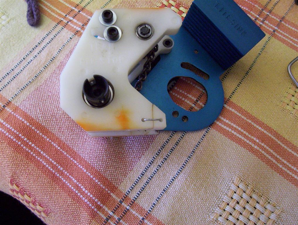

Hi Guys,
Hi Shodog, thank you for taking an interest in my project.
The Team Pit Stop chain drive tranny has cracked and broken on both sides where the mounting bolts
go into the trans, as I don't have any more cases, I did a quick repair by drilling through the cases and
used safety wire to wire them together.
Here's a pic,
Cheers, Dave.
Here's a pic,
Cheers, Dave.
