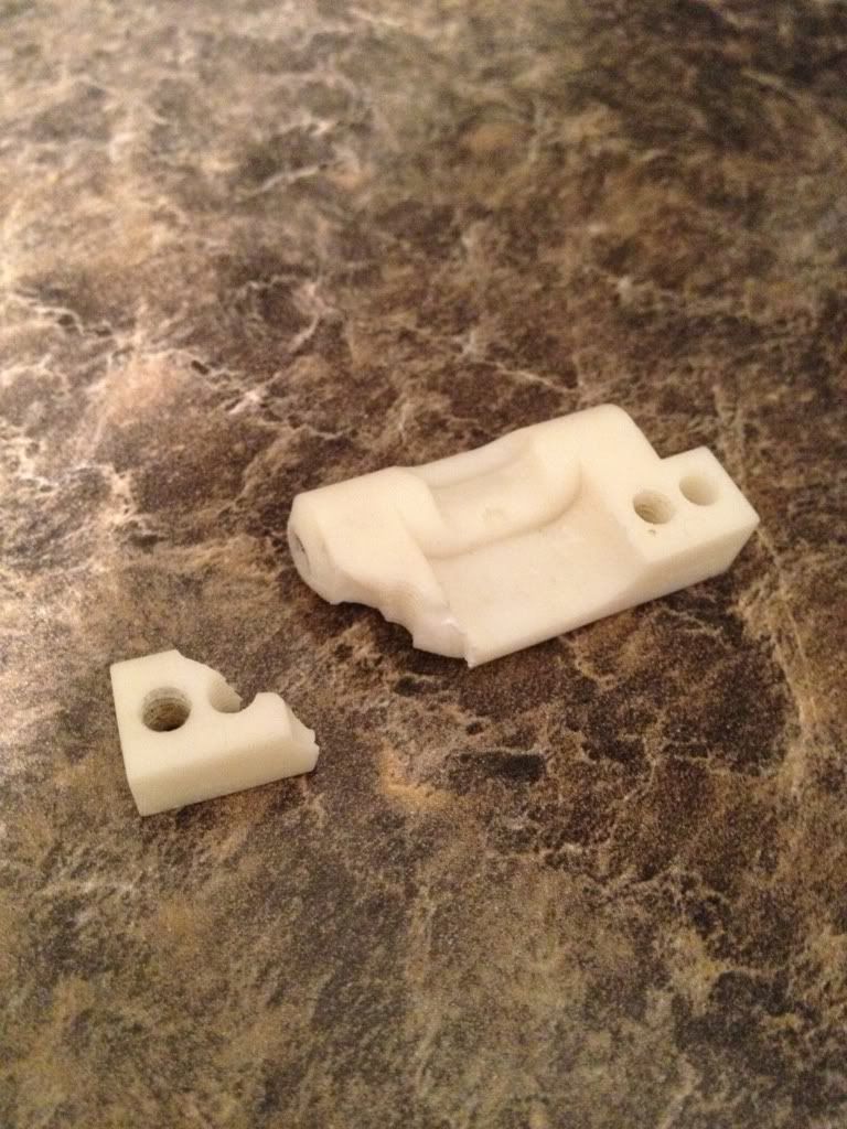

Thanks for the compliments! The pinion is a 30 and with the 10.5 motor, it would still pull wheelies at anytime. Cool to see, but not to turn! Backed off the slipper a bit and toned down the power with the controller and was a bit better. I played around with it and was able to make a few decent laps with my lacking driving skills. It did take some really hard tumbles and kept on going even though last tumble broke a shock shaft and rear mount. I need a HUGE amount of practice just learning to drive again, as well as being able to tune the car/controls to my liking. I had someone else I know who is pretty good with a B4 drive my car several laps and he commented on the facts that it doesn't turn near as well as the B4, and you have to hit the jumps perfect to get it to land properly. Two things for sure after I drove his B4 many laps. Even with my limited driving ability, the B4 is way more forgiving. I noticed that the old 10 had a much heavier feel to it which led to a harder crash when not hitting a jump right.

I wonder what would've happened if I used aluminum rear mounts with this kinda break or if the RPM mounts are stronger? Don't really want to replace very many white rear mounts.

Post by klavy69 »
well, rpm is more flexible for sure. Absorbs impact more. Hard to tell what it would have done though in that situation. Might've tore out one of the screw holes if it was rpm...

Post by LowClassCC »
just looked at the race results and seen you did do better this week out, so congrats on that. that's a tough break in the main though. (sorry bad pun) that is not a part i would personally swap out for alloy. now if you make a habit of busting that one piece then i would look into the other options. if you can fund the rpm versions i would go with those though.
