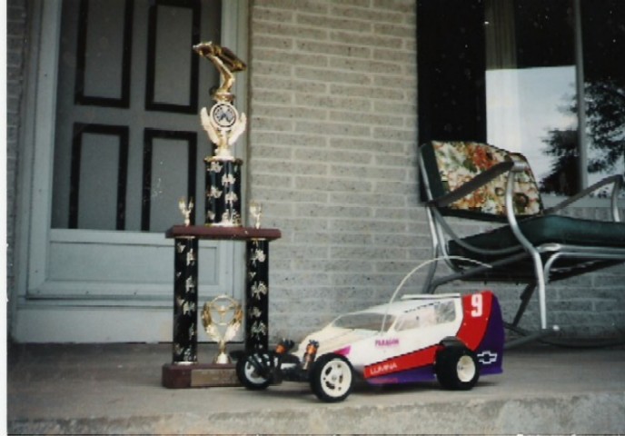

Older pics-

askbob
Posts: 1736
Location: KY
Re: dirt oval discussion
Post by askbob »
Reg, did you build that body from scratch?
