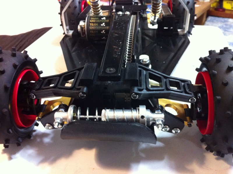

The motor colors are a really nice touch. What are those front arms? Very nice.
- 59burst
- Posts: 1011
- Joined: Sat Jul 26, 2008 9:52 am
- Location: Bothell, WA
Re: another 834b project
the front lower arms? they came from pargu, an ebay seller. he made few more parts for 834B like rear shock mounts, front lower arms, the C hubs as the start of this project. and, the motor plate too

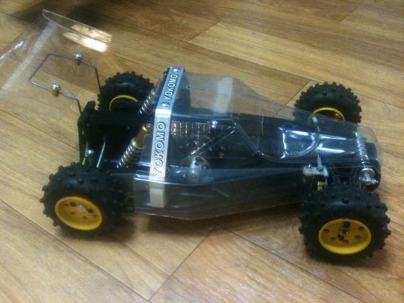

what i did right after i opened the package was putting the upper arms from 2 different persons together, along with the steering knuckles. actually I had to. it wasn't a car before these parts
then changed the steering center link for letting adjust them with ease
tried few different wheels then

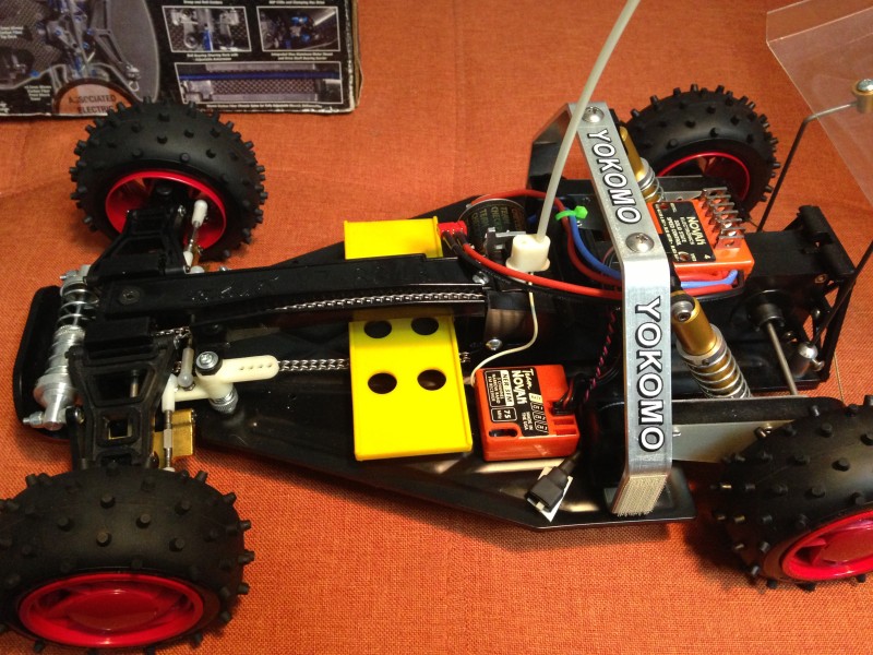

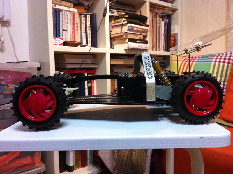

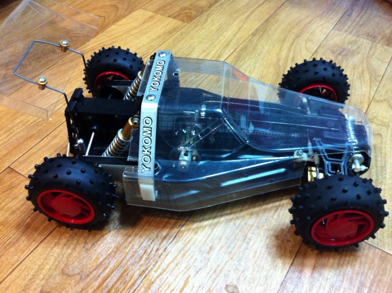

and I did few more today. now it got the stock front shock mounts, hot trick height limiters, and new swing arm plates than the used ones

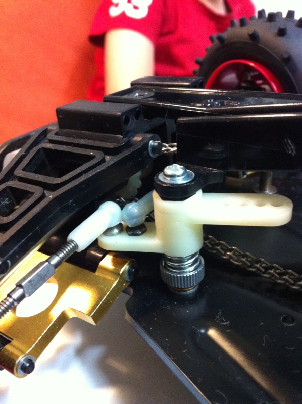

here is the closer look of the steering. small balls and cups came from RC10 sway bar, and regualr ones from Reggie's rc10
most of all, it finally got the matched wheels today.

Funky red wheels...never saw that kind before.

the wheels came with the latest 834B SE japanese version. the wheels were very popular at mid to late 80's

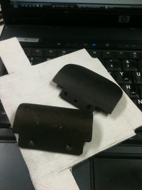

don't worry about ita01butal wrote:What no white bumper
I'm gonna build a runner with a white bumper

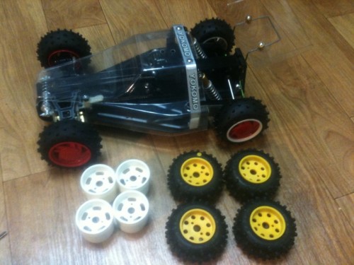

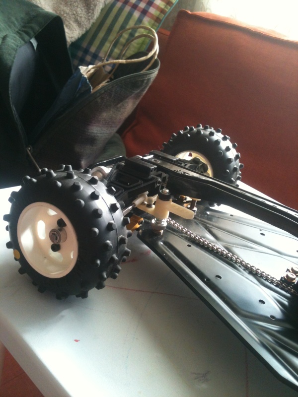

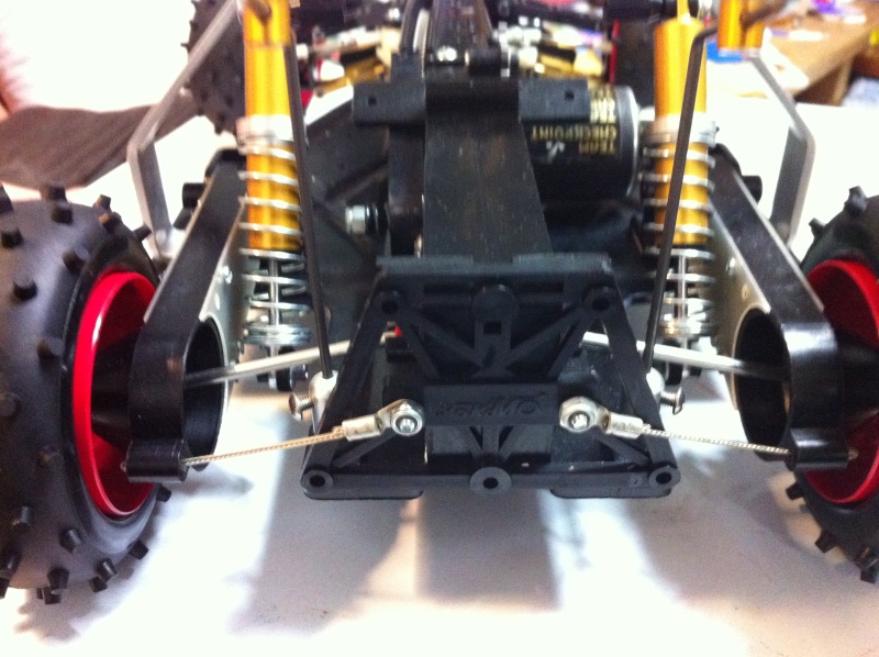

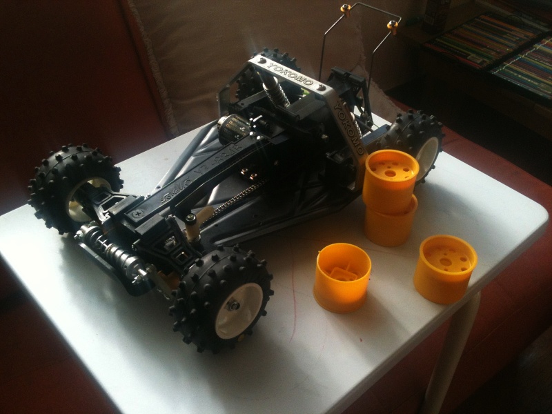

a little update with used novak gears and the battery plate.

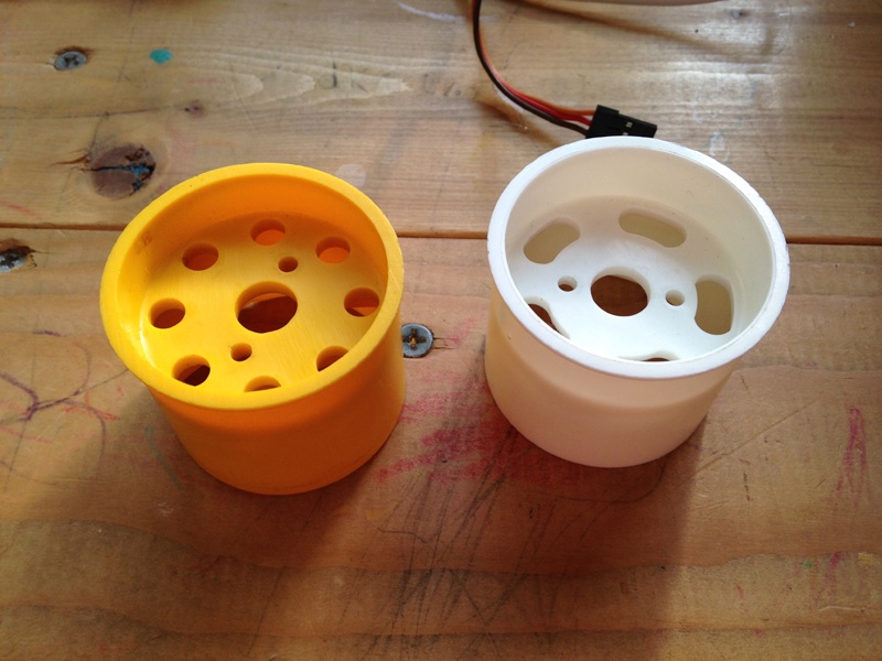

pargu and i have been talking about these wheels before and finally started the project this morning. we are making aluminum wheels with the original and custom works design. this white wheel from a10butal has deeper offset then the yellow original. and the offset looks better and seems to run better than original to me and this picture shows how deep offset looks
http://old-skool-runners.blogspot.kr/2012/12/yokomo-834b-featuring-herb-hanss.html
let's see how pargu's work is going
Deeper (negative) offset increases track width and therefore will improve cornering stability. To be honest, I don't quite get "the thing" with all the buggy wheels these days having major positive offset...

All those buggies are at max legal width.Coelacanth wrote:Deeper (negative) offset increases track width and therefore will improve cornering stability. To be honest, I don't quite get "the thing" with all the buggy wheels these days having major positive offset...
Reducing offset allows the arms to be longer : more up-down travel of the wheel with less angle changes for the suspension and drive shafts.
