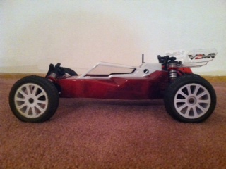

i finished the car up last night.
i had a few issues with mismanufactured parts, cvd's binding and a buggered shock body. after some carefull polishing it's ready to go.
the gear cover is odd, to tightly shaped around the pinion area, a large pinion will bind on the cover. no cover for me tonight, as 17.5's use a big pinion.
it feels great running around my basement. heading to the track tonight for some 17.5 class racing, i figure i'll take it easy on it the first night.

Re: Modern Car - Atomik V2MR
looks good, race report when you get back
we can share set ups as well, until we get these dialed in for how we drive.
