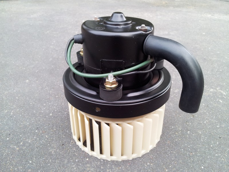

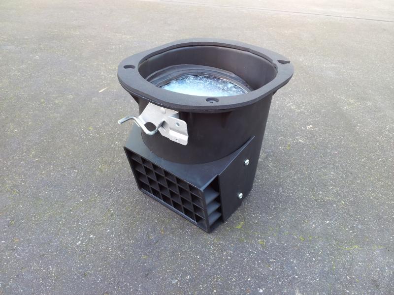

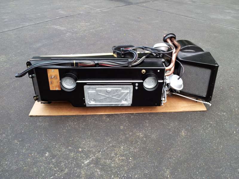

Coelacanth wrote:I'd say that car is worth the upkeep. And you're right about the exhaust note...I don't recall you mentioning what you had in there. Is it a 351? My cousin had a '72 Torino for a short while with a 351 Cleveland...very strong motor per cubic inch. Nothing compares to the sound of a vintage V8 burbling away at idle. Speaking about heater boxes, this winter I restored my Charger's heater box. I'll be reinstalling it either next week or the week after.
Its only got a little 302 cleavland in it, C4 trans, factory 4 wheel disk brakes and factory 8.5" limited slip. An intesting fact is oddly enough white with a blue vinyl roof and blue interior wasn't an offered option, but the body tag is correct to how the car is trimmed. I fired up the donor car today after sitting for a year and will do a compression test sometime this week. Hopefully it will be pulled and ready to put in mine by the end of the week.
On the topic of charger heaterboxes I restored mine last year :D

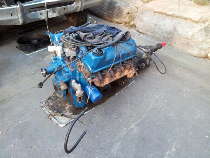

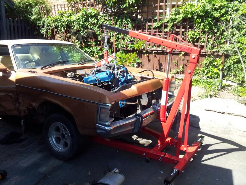

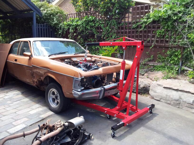

I finally got off my ass and did something. Being a one man show I'm wrecked though, the car didn't want to give it up easy.

Yeah dude. The old engine pull. Always straight forward, never easy. Way to go!

I love those one man weekends. Good for you RJ, I've been there. Pulled, and installed a 289 on my old 65. Just me, beer, and my music.....

Once everything was unbolted it should have only taken 30 minutes to pull the engine out, but ended up taking half a day of jacking, banging, wiggling, prying and a few words to get it out. At least it's done and I'm looking forward to giving it a bit of extra go.
Apparantly the Aussie 302 Cleavlands and some heads are quite good. All 302's are just destroked 351's, and most of the heads are small closed chamber. Although when installing a 351 crank the compression jumps up quite high and requires open chamber heads or dished pistons. I read somewhere the 302's are 9.4:1 and the 351's 9.1:1. Closed chamber heads with 351 crank and flat tops jump to 11:1.

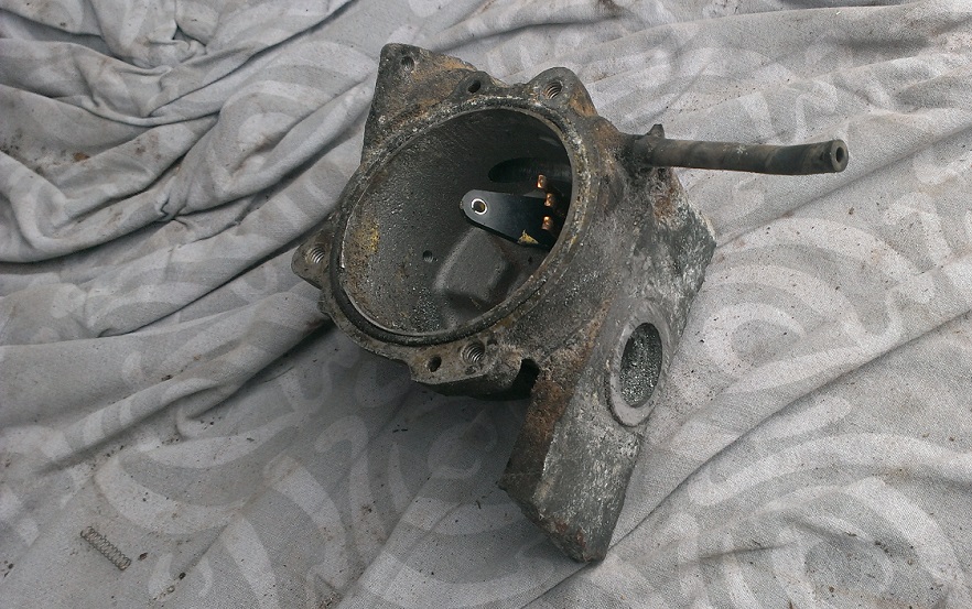

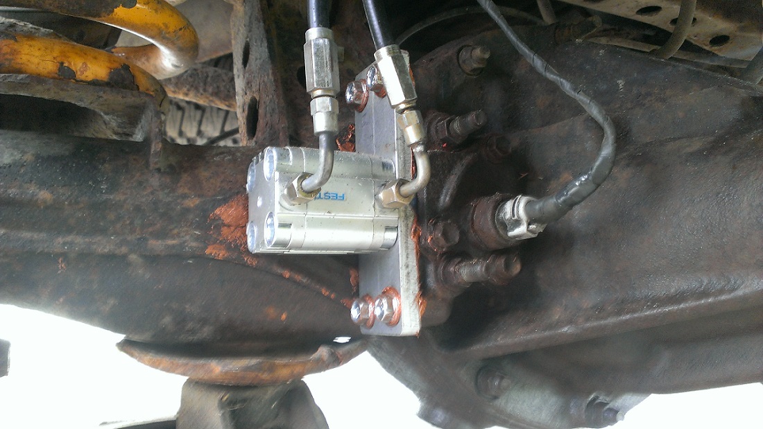

It´s unbeliveable, I know, but the Land Cruiser needed help :shock:
I hadn´t been able to lock the rear diff since I got the car, as a result of that I had to go backwards about 8 meters and use more throttle on the second attempt, a rainy day in last years christmas tree season.
Never again will I take such defeat, I promised myself - as a result of that, and with the tree season getting closer, I dismantled the actuator a cople of weeks ago.
Not good, corroded and broken beyond repair. Even the magnets had given in, they followed the rotor out when I dismantled it.
A new actuator is 7-800 usd´ish - totally insane!
I thought about doing a cable version but wasn´t really keen on having a handle sticking halfway through the cabin when activated.
Next idea was to have a 30 kg servo pull the shaft, but then I´d have to weld a bracket, watertight enclossure and think up a clever springloaded lever system - plus rebuild the control system.
Then the only thing left was air.
Since I didn´t have compressed onboard air, I thought about doing a vacuum version - but then I read a discussion between two mechanics about the use of vacuum for aux equipment, and decided to go for the compressed air version.
I bought a used Festo 2-way cylinder and made it oneway with spring return. Took me a while to find the right strenght coil spring to retract the shaft. Ended up with a vintage 1/8 spring :D
When cutting the shaft, I started out with a hacksaw - didn´t even scratch the shaft :lol:
Luckily, I was able to drill and thread the shaft end after it was cut with the grinder.
Perhaps the heat from grinding took some of the hardening?
The hoses and fittings are hydraulic components - can´t have thin blue girlie plastics running under a Toyota.
The only unsolved matter is the vent/bleeder hose end, can´t have a "ball" valve like the breathers for the axles.
It needs to allow suction as well. Any ideas?

Dennis - I would make a small vent box where the vent tube inside the box is near the top of the box, and a drain tube on the bottom so if any water gets in it won't get sucked in the vent and can also drain out. As long as it doesn't suck while submerged the air inside will keep the water out, and depending on how much/long suction there is water wont even reach the tube even if submerged. Unless it requires continuous suction.
