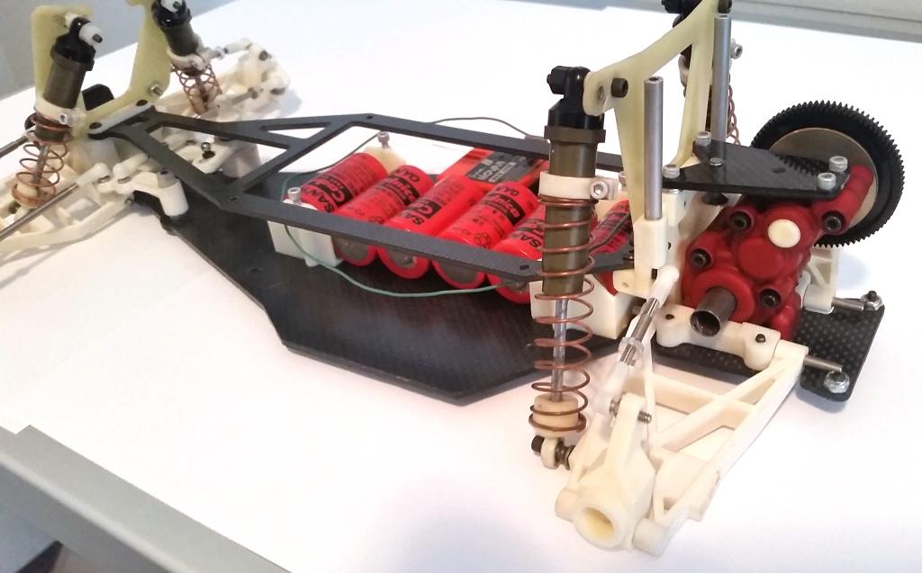

I think my best chance for getting the correct wheels is to do the Niki replicas.
I'm guessing I need these ones?
ZC-835 2.2"
https://www.shapeways.com/product/SAQJZ554Z/zc-835-2-2-quot-1pcs?li=shop-results&optionId=42952293
NIX68521 Front TQ wheel 2.125"
https://www.shapeways.com/product/BP824AMAD/nix68521-front-tq-wheel-2-125-quot-1pcs?optionId=56072955
ZC-835 2.2"

Re: VAE's 91 stealth replica & runner V2
You're right for the fronts, but I would use these for the rear: http://www.shapeways.com/product/324JENN76/zc-825-2-125-quot-1pcs?li=shop-results&optionId=40560922 as they're a replica of the ROAR regulation wheels. The 2.2 came after.
X2, hard to see in the picture if Brian drilled the rear wheels like most AE drivers did.Asso_man! wrote:You're right for the fronts, but I would use these for the rear: http://www.shapeways.com/product/324JENN76/zc-825-2-125-quot-1pcs?li=shop-results&optionId=40560922 as they're a replica of the ROAR regulation wheels. The 2.2 came after.
I only see 2 screws, but it make sense that it's not the 2.2 since they didn't come along until later.
I think Rod is talking about the row of large hole down the middle of the wheel (like Masami's car), not the mounting holes.vintage AE wrote:I only see 2 screws, but it make sense that it's not the 2.2 since they didn't come along until later.
The ones in David's link would be the ones you want.
I was gonna say...maybe it's time to get Rod some glassesscr8p wrote:I think Rod is talking about the row of large hole down the middle of the wheel (like Masami's car), not the mounting holes.vintage AE wrote:I only see 2 screws, but it make sense that it's not the 2.2 since they didn't come along until later.
Those will be the ones I get then. I just need to wait to get some money coming in. I never hurts to do the leg work first then spend all of the money at once
I got the red trans dyed red. As I mentioned on facebook, it turned out a bit darker than anticipated due to a trace amount of black dye left from the previous dye job I did. I have another case to dye, but not the spacers so I think I will leave this for now. If I do it again, it will be with a fresh pot...the second case is much brighter to begin with too. Once I get the body painted nobody will be looking as closely at the trans, so I'm not going to stress over it.
Red is close enough plus the original pic is not the best. Just a touch lighter than the SCR batteries I think.

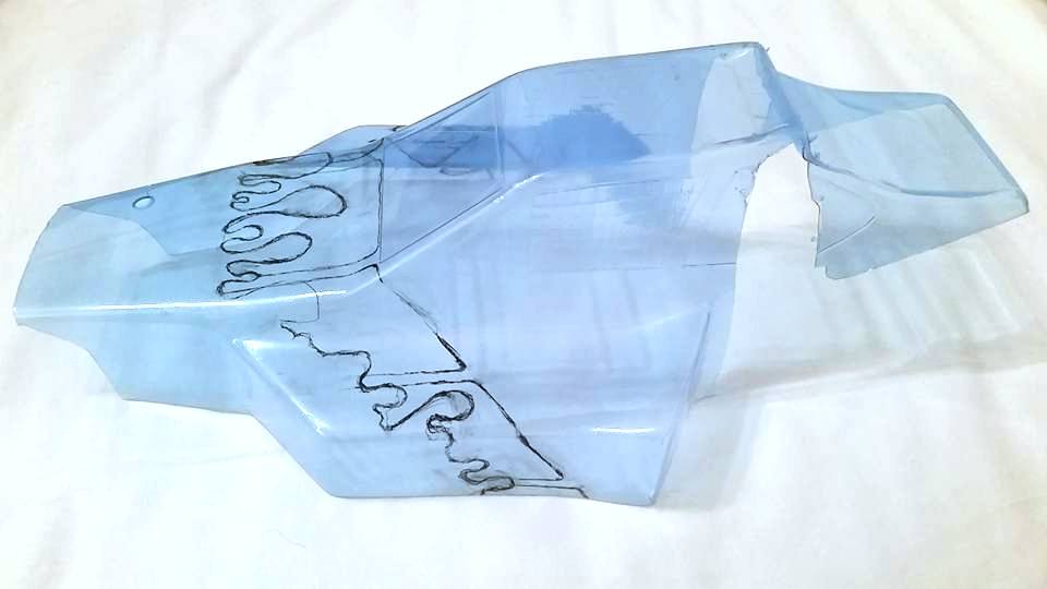

Thanks for helping me out with my small nuts guys, it feels better to know there's hope for me
This is next... I should trim and sand the edges a bit better, but I'm "working" in the field and don't have that crap with me. I only planned on drawing this up, but I have at least 4 more days away. I might as well get her masked up and see how far I can go with her.

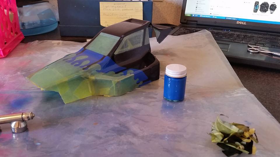

Made me some Kinwald blue today. Now, do I cut in that red no copies circle and paint it, or find a sticker. I think I'll find a sticker to be closer to the original.
