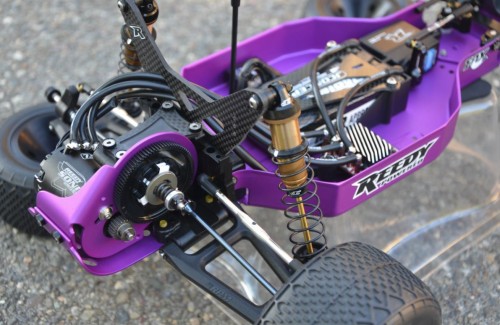

A few small changes. I wanted the option to run modern slippers, but you cannot simply swap a new B4 shaft into the RPM transmission, because the gear ratio is different from the Stealth. I removed the gear ring from the RPM shaft, did the same with a new B4 shaft, and pressed the B4 gear ring onto the RPM shaft. Now I can use the RPM transmission and still have a shaft that accepts new style slipper setups. I went with a Avid slipper setup.
Lavigna
Posts: 1424
Location: Petaluma, CA
Has thanked: 1053 times
Been thanked: 1333 times
Re: RC10T - Adam's modern build
Post by Lavigna »
I rearranged the electronics layout in a bid to clean it up. I was able to shorten the motor leads by switching the the esc, and re-routing the wires.

Looks good, what slipper set up is that?
Lavigna
Posts: 1424
Post by Lavigna »
RC10th wrote: Fri Jan 20, 2017 7:11 pm Looks good, what slipper set up is that?
Avid Triad if I recall correctly. I have one on my RC10T5M and love it.
