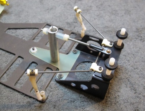

OK back on topic.
Center dampener was mounted and adjusted. Connecting posts for the roll bar mounted to chassis.

Roll bar cleaned and added. As mentioned before this is a handbuilt prototype roll bar. Roll bar provided additional stiffness to the rear end for high grip conditions, also tweak could be adjusted this way.
When watching several Euro Panther photos I found there were several choices for the lower roll bar mount. I went with the same outside position as Chris.

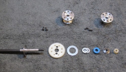

Rear axle diff was next step. Chris provided a Parma graphite axle where the diff ring was epoxy glued. New Parma Panther hubs and usual diff hardware were used also. The diff hub was a quite tight fit so a reamer was used for making this work.
This diff is old style and doesn´t use ball bearings at the diff.

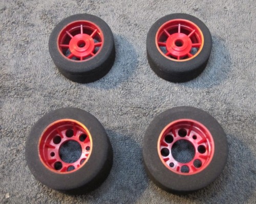

At some point I mentioned I will keep with white color scheme for most of the plastic parts but there will be red parts also.
OK this now where the special red parts will be added.
